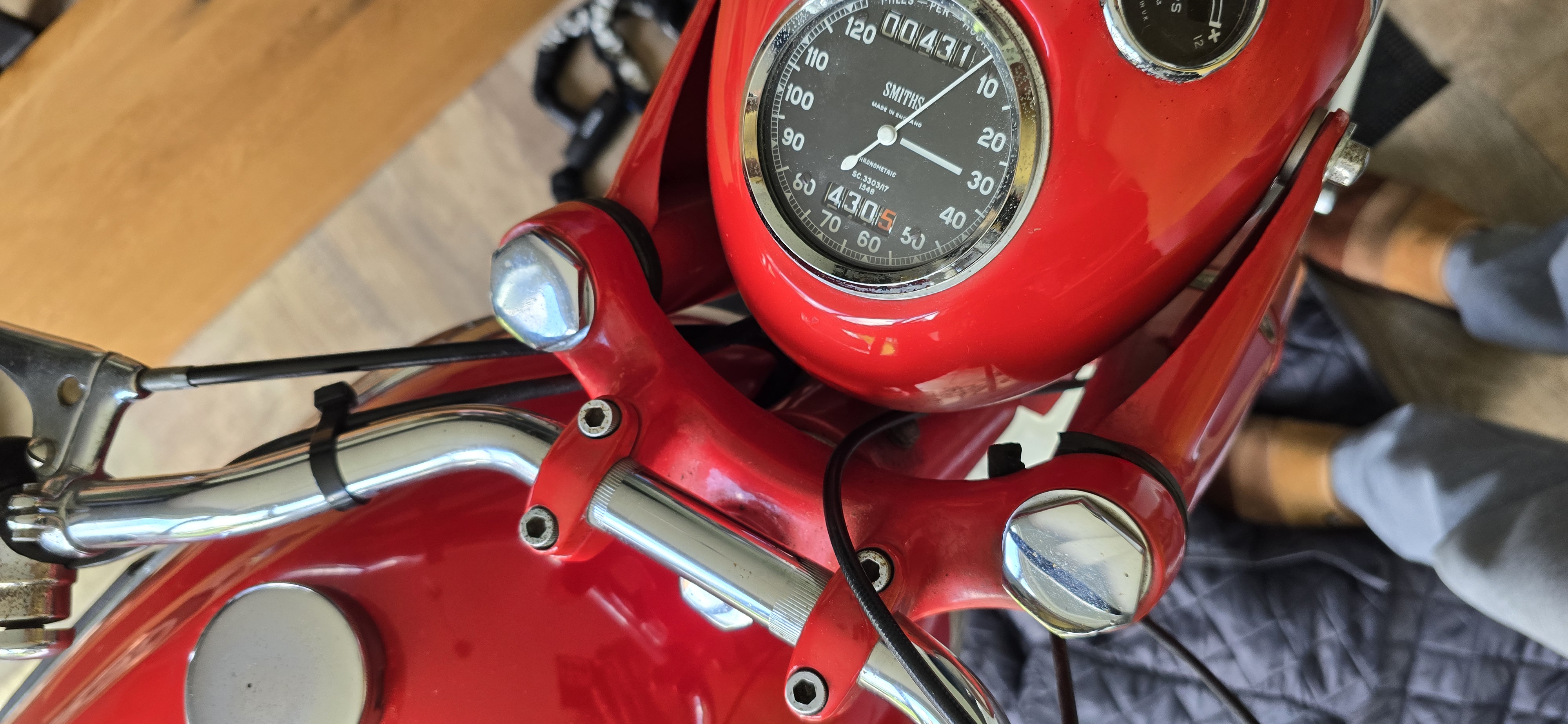

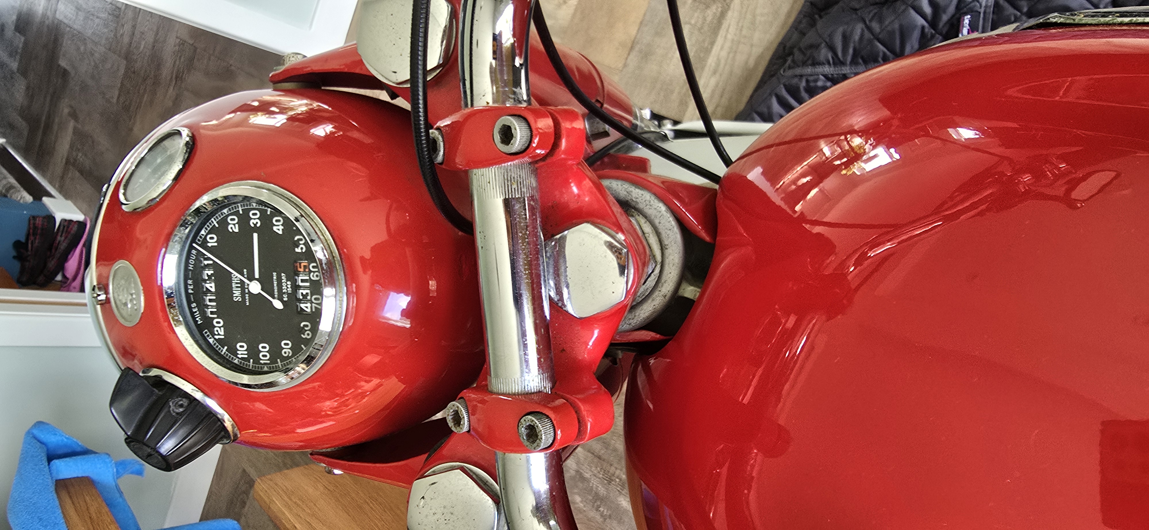

This machine when built had a Lucas PRS8 ignition light switch. They used a small Lucas spade key down the centre of the light switch knob. If the wrong key is used and/or a screw driver then the ignition can be operated but the RETENTION piece inside the knob gets 'mullered' and even replacing it and using the right key does not make it any more secure.
Options-use large chain. Fit a further 'hidden' ignition switch, either a toggle switch or real key switch. BUT break the ignition circuit, as just breaking the battery cct might allow the emergency start alternator function to still work. For any more ideas get in touch direct.

Defo no steering lock....did that happen after '61? I'll post a pic
