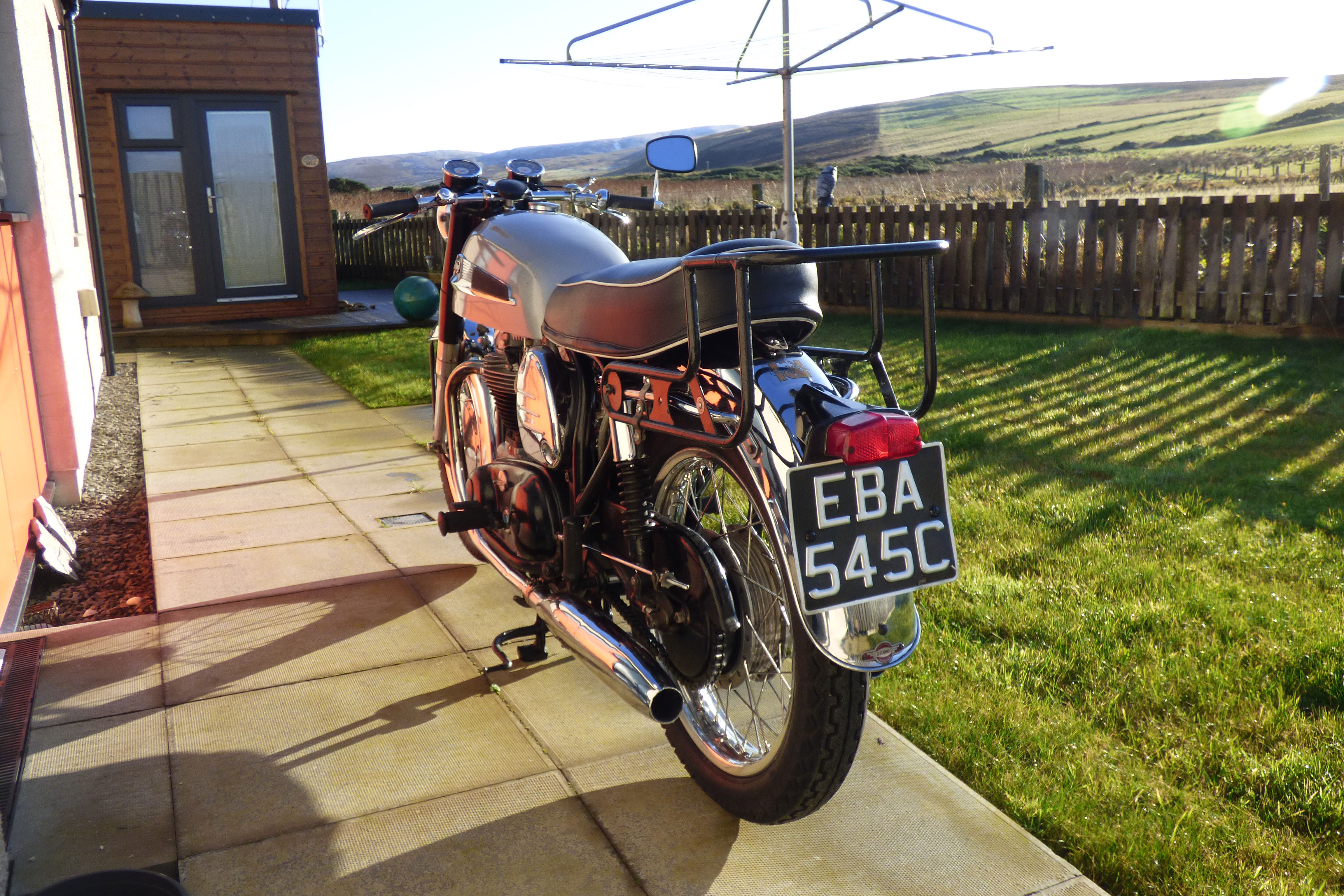

...also has a mix of up and down hill, and no exhaust to contemplate on the left side?  I also  thought mine was assembled wrongly, but attempting the swap over showed that it would not work with the components fitted.
