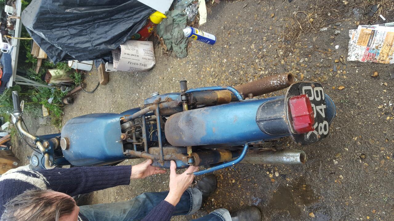

So, I just bought my first Norton, My first bike actually.
As the title says, it's a '62 Navigator, 1 owner before me, with just over 20000 on the clock. At best guess it's been ridden into a shed at some point and left.
Anyhoo, if all goes to plan, and I remember to post, I hope to keep you all updated on progress as time goes.
Needless to say, any tips or observations would be greatfully received.
This was the bike as bought.

Hi Anthony,
It's amazing to see such an original looking Navigator. As you say it looks like it was ridden into it's shed and left.
Twin Wipac coils is correct and original. Don't throw them away until you have at least tested them - Wipac coils seem to last forever. Those look like original pistons so it's probably still on standard bores. The silencers are the same as the Dominator and new ones are readily available. I hope you have the kick starter as these are hard to come by. Same goes for the tank badges - these are hard to come by as well.
Good luck with your rebuild.
Patrick

Just finished our first days work on the old girl, the engine is seized so our first aim was to remove the plugs and pour some rust treatment down the bores, one plug came out with no real issues, but the other had previously been snapped off.
We decided that as we are rebuilding it anyway, we'd strip the head down. So, the saddle came away,virtually without removing the bolt, unfortunately the seat will require major attention, found the chain under the saddle too, though i will probably renew it anyway.
With that, the tank was removed, it still had liquid in it! Not sure you could call it petrol though.... next to come off was the coils, I have to say I was surprised to find two (you'll have to forgive my ignorance).
We had a bit of fun taking the exhausts off, the pegs came away fine but the two bolts in both tailpipes were well and truly seized, one sheared and one rounded off so only two came away clean.
Nonetheless we prevailed and got the pipes off. Never seen push fit pipes before (I'm used to clamps on cars).
Once the exhausts were off, focus went to the head, didn't have any real issue getting that off, little sticky but a gentle tap with a bit of Wood soon solved that.
What I saw next made me grin though, no wear, I mean none.
There was a fair buildup of detritus on top of the piston but a bit ofa clean and the tops were shining. I haven't seen an engine that clean for a long time.
Last thing for the day, we filled the bores with some rust treatment in the hopes that it will eat though the rust and un-sieze the engine. The head will come to work with me on Monday where I'll get the spark plug remnants out and clean it up.
