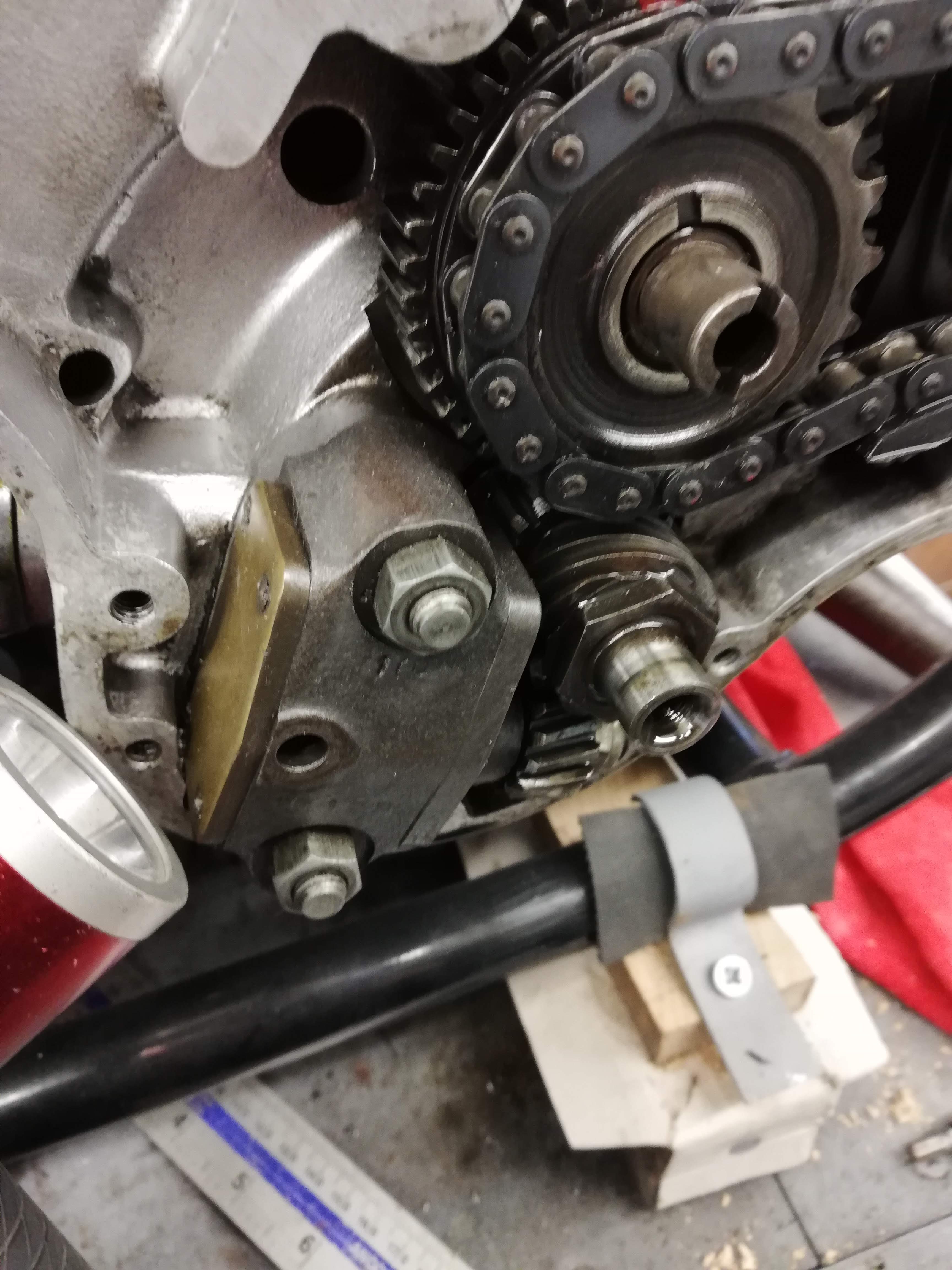

Hi. I have a late model1973 Commando that doesn't have the tube coming out of the oil pump. Which would hold the seal to the out timing cover in place. Is this correct?
Regards Peter
Yes, missing and needed. It…
Thanks for the reply. I've…
Thanks for the reply. I've found the part at Andover Norton. Must have been used without it for some time!
Regards Peter
oil pump tube
I hope not as this would limit the oil getting to the big ends. Hopefully it was just forgotten when the oil pump was possibly serviced.
Hi Ian. I'm not sure what…
Hi Ian. I'm not sure what happened to it. I'm hoping it just feel out when I removed the timing cover. The engine appears in really good shape so perhaps that's what happened. Regards Peter

Can do, that is why it is a…
Can do, that is why it is a good idea to have a spare or two. That and the gasket should be your final check when refitting the cover. They are crushed in use and should not be reused.
Yes, missing and needed. It is available separately but no part number in the 73 parts book.
