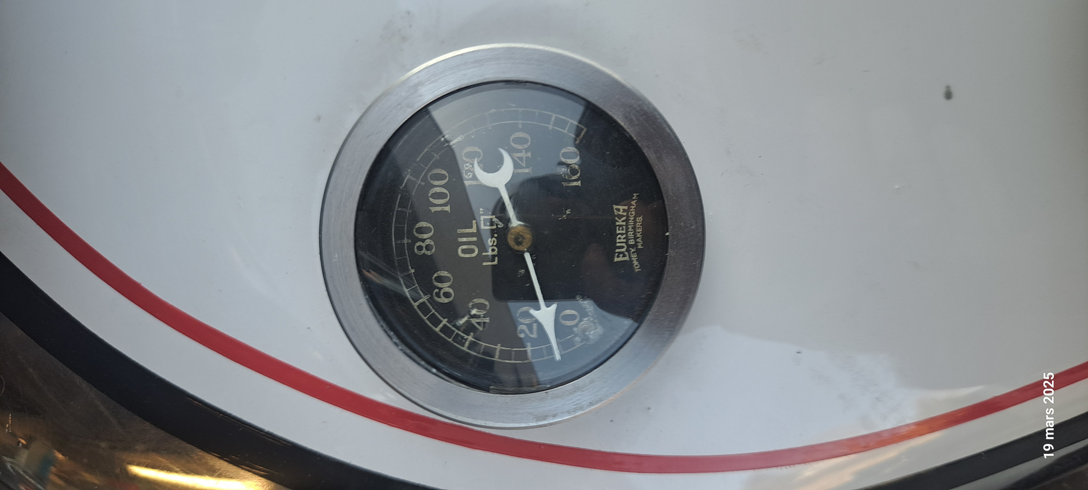

Can anyone help me? I have an oil pressure problem on my 1949 Norton Dominator model 7. When I start the engine cold the pressure goes up to 100 Lbs. When the engine is hot the pressure drops to 10 Lbs and sometimes even 0 Lbs. I use SAE50 oil. I'm aware that the fluidity changes with the heat, but the difference is enormous. Does anyone have any idea why?
Not unusual to see your figures which is why Norton deleted the oil pressure gauge..
If your engine is not wet sumping quickly, I wouldn't be too concerned.
You could check the sealing washer fitted on the pump to seal the oil flow to the timing chest for peace of mind.
Further inspection of the oil pump for wear will give greater confidence as well.
Not unusual , consider changing to 20/50 oil ,easier on the engine on start up . You could strip and clean the PRV valve .
Ian and Robert are correct. Same story with my model 7 which I've been riding for nearly 3
decades. Enjoy.

 That leaves a question,  So where did every bit of  the oil pressure go ?  Centrifugal force pulled most of  the oil out faster than the pump could supply ?, probably,   but also  could it be that crank flexure at high revs  allowed a bit more leakage between the bolted up crank faces ,even more so when oil was hot and thin ?,  Anything we can do about that ? . Lightly grind the faces together  with valve paste for a better fit ?  Its well known that the drive side was not as well lubricated and was prone to seize on that side .

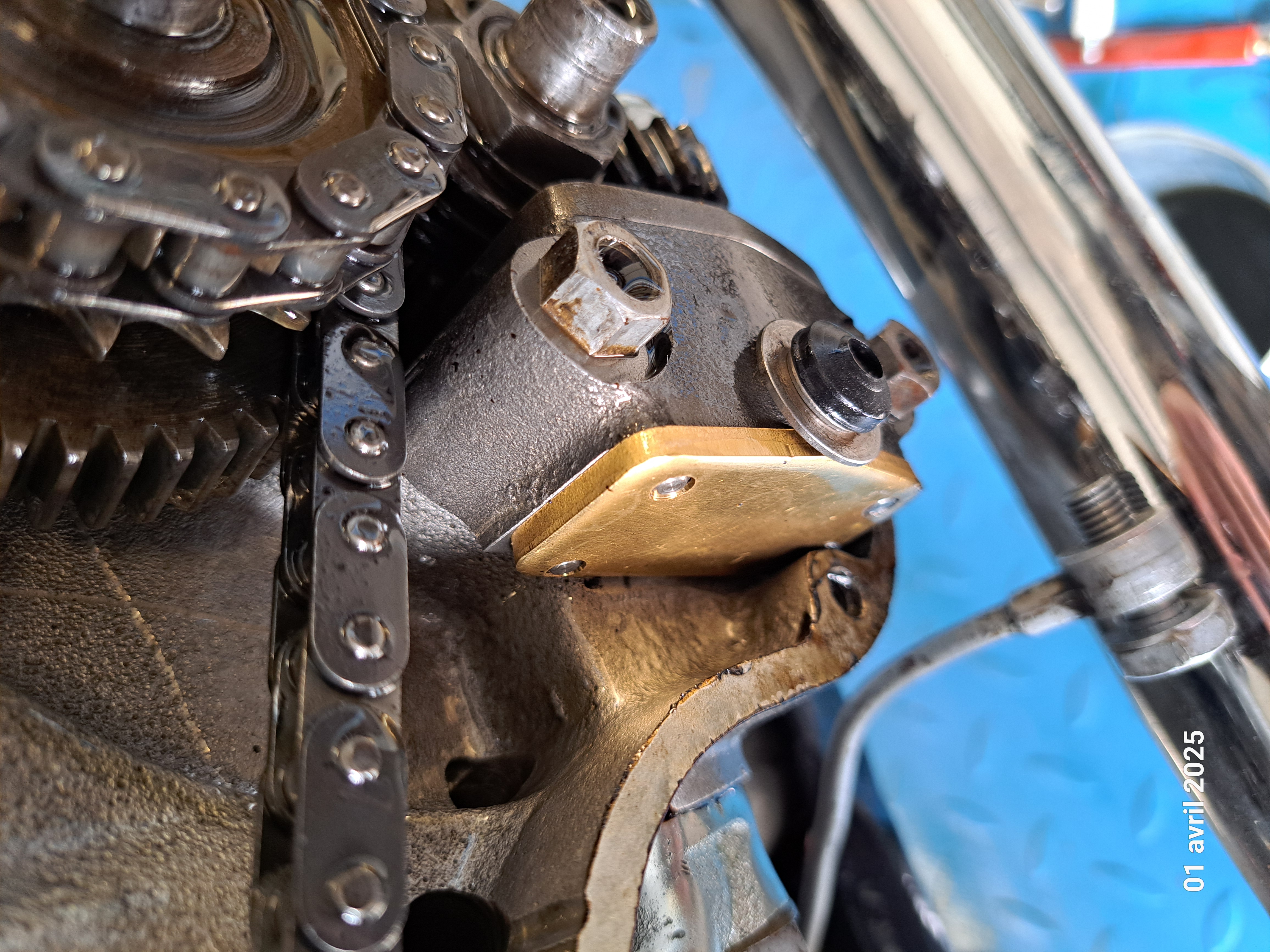

Thank you for your answers, I put a washer between the oil pump and the conical seal so that it is more compressed hoping that the seal is better. I drove it for 20 minutes and it seems to be a bit better. I'll leave it like that.
My Dommie has a thin paper gasket.  The conical seal tends to be squeezed so hard that it is in danger of its edges coming away.  Are the ones we buy now thicker, to suit  later thicker Commando gasket?  Take care it's not too distorted if you add a washer to Dommie.
The lip seal in the cover is a possible issue.  The recess in my cover is just a little too shallow to get the retaining circlip back, and I end up removing some rubber from the back face of the seal.
Please see your workshop manual.
When correct conical seal, washer(s) if required and gasket are in place , the timing cover should be forced away from the gasket face of the crankcase.
You should be able to get a .010" feeler gauge in.
​​​​in.Beware of timing covers which have been surface ground and thick commando type gaskets.
