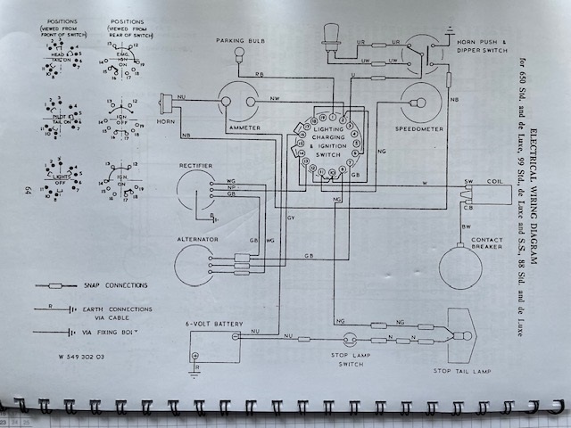

Finally I am planning to 'resurrect' the bike cut a long story short I have carried out most checks and have compression etc but no ignition, as I am unaware of the condition of the wiring I thought I would just run power to the coil and see if it will fire...... to no avail coil is getting hot no spark at the point and I'm sure I have wired every thing correctly, new coil arrives tomorrow so that's the next stage.
Can any one confirm a simple positive earth wiring diagram to run power to the coil and distributor only please as I am so convinced I'm right I may be missing some thing.....

Thank you but what I am intending to do is litterally wire the battery to the coil and wanted to confirm I have every thing in order :)

Would this be of any assistance?
