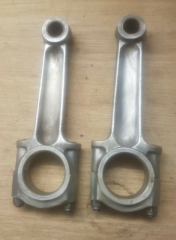

The Connecting Rods of the 88 & 99 and 650 has anyone got photos of them and how the differ, stamped numbers e.t.c ?

David,  people on Ebay are claiming 88 & 99 and sometimes Dominator 650 SS conrods are all the same, now Anna told me 99 conrods are 1.2 mm longer than 88 con rods  and I looked at some early Norton model & con rods on Ebay, which had no numbers on them until he produced more photos and these are the one in the first post. When he added more photos the con-rods pictured turned out to be very early Norton 7 con-rods , which of course no use to someone like me with an Atlas engine and two 99 engines.
I  read somewhere that apparently, BSA blank twin con-rods, 500/ Star/Golden Flash,  are very similar to Norton con-rods, you would think that someone somewhere would have sorted this out long ago and con-rods could be supplied new as forged alternatives duplicating the original form.
John
 88 and 99 rods are identical but 650/750 rods won't fit the 88/99 Not really a good idea to fit  SH rods or even turn rods round or swop over as load reversals  cause extra stress.  For the 88/99 you either fit used SH and take it easy with fingers crossed or buy Thunder rods. The 650/750 rods are still supplied new.  E-Bay is a complete lottery, Used parts described as NOS ,Scrap sold as serviceable, parts wrongly identified.
