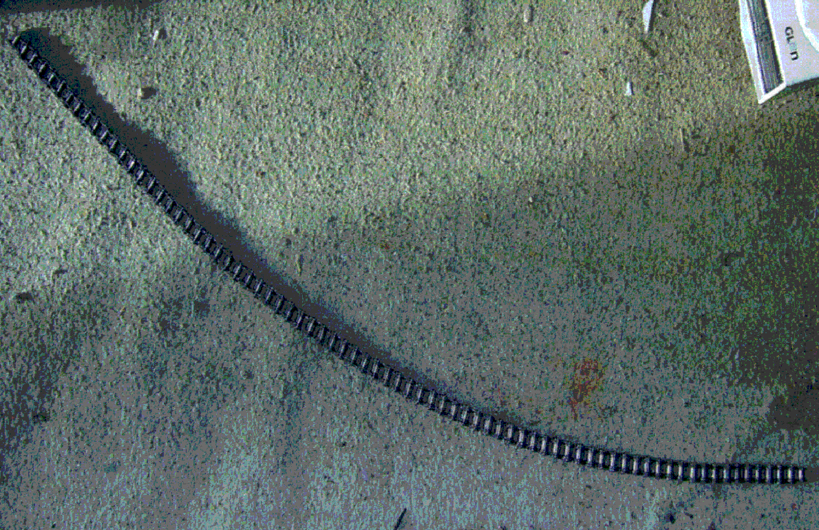

See the attachment showing a Renolds Primary after next to no miles of use.
That does look dire, Philip. The chains I have fitted are both Renolds, new in packet, bought a number of years ago and never fitted as I was planning a complete gearbox and transmission refurb, just completed, with new sprockets (excepting clutch, which looks good), and Tutoro oiler for the rear. It is at least possible that it is the chain dimensions which are the problem, so I will take a look at the old English-made Renolds which came off the bike to compare. It cannot be wear, though, as the chain has never been on a bike.

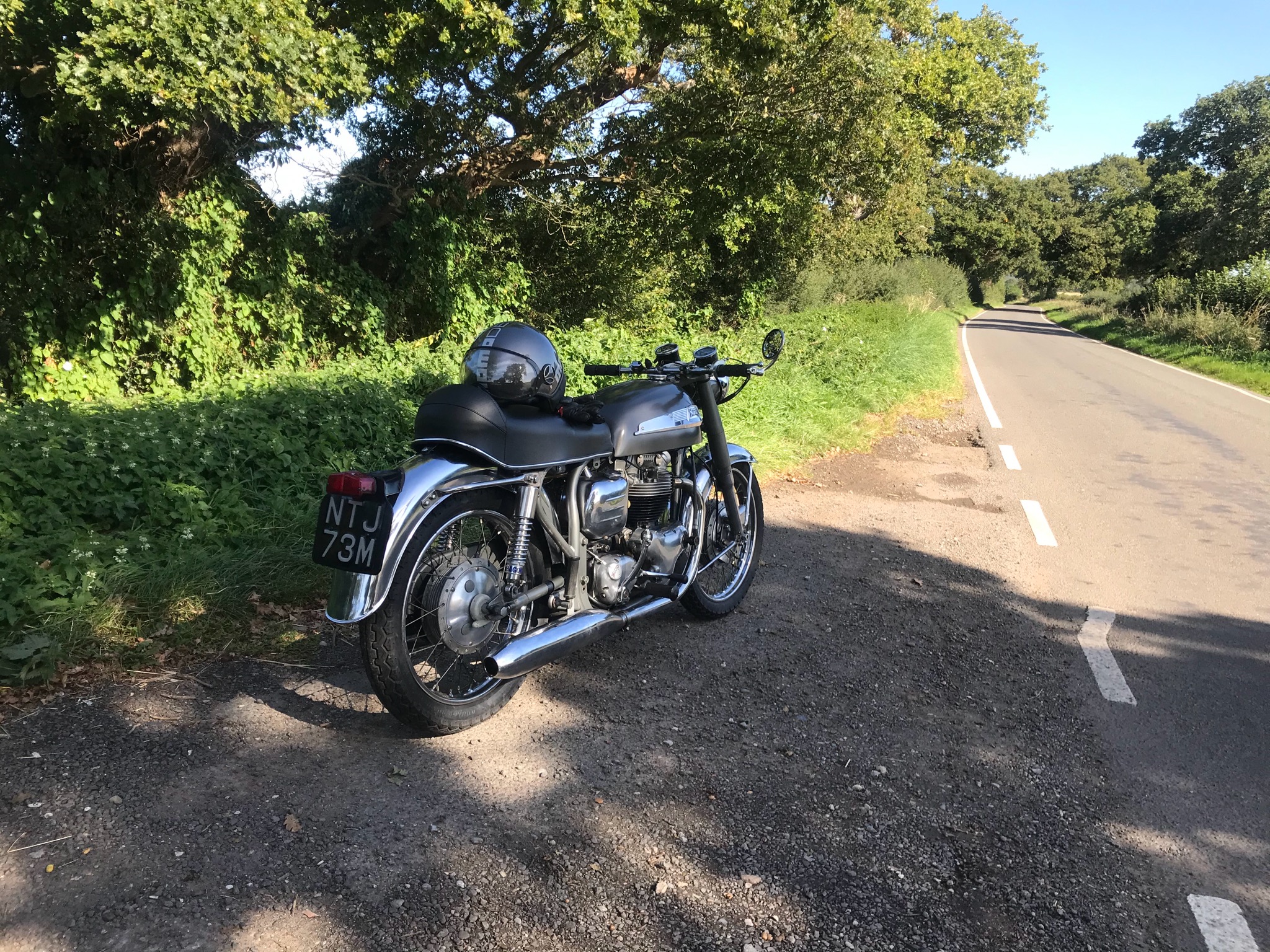

650SS in the lanes around Chester today
