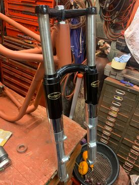

Hi Tony I have ordered the spacer tube will fit it tomorrow im a bit concerned on the gap where the pencil is pointing to. The gap is about 6mm every thing on the yoke has been nipped up my fault on the previous message I just had not nipped it up tight enough. I have also ordered a dust cover to sit on top of the bearing and just worried it might not take up the 6mm where the pencil is pointing to will that be a issue or is that just cosmetic.
Hi Dan please see the picture of the forks.
Ed
Spacings
My first impression of the fork set-up is that the stanchions need to be re-positioned.
The spacer tube is an essential part if you have gone down the sealed ball bearing head race route. It must fit precisely so that the outer race sits in the headstock shoulder cup s while sharing the load between the inner races and bearings.
I agree with Phillip, as I…
I agree with Phillip, as I recall the adjuster nut flange above the flats should fit inside the stanchion, I wonder if the yoke needs paint/powder coat removing to ease it? Either that or the adjuster nut dimensions are wrong.
Dan

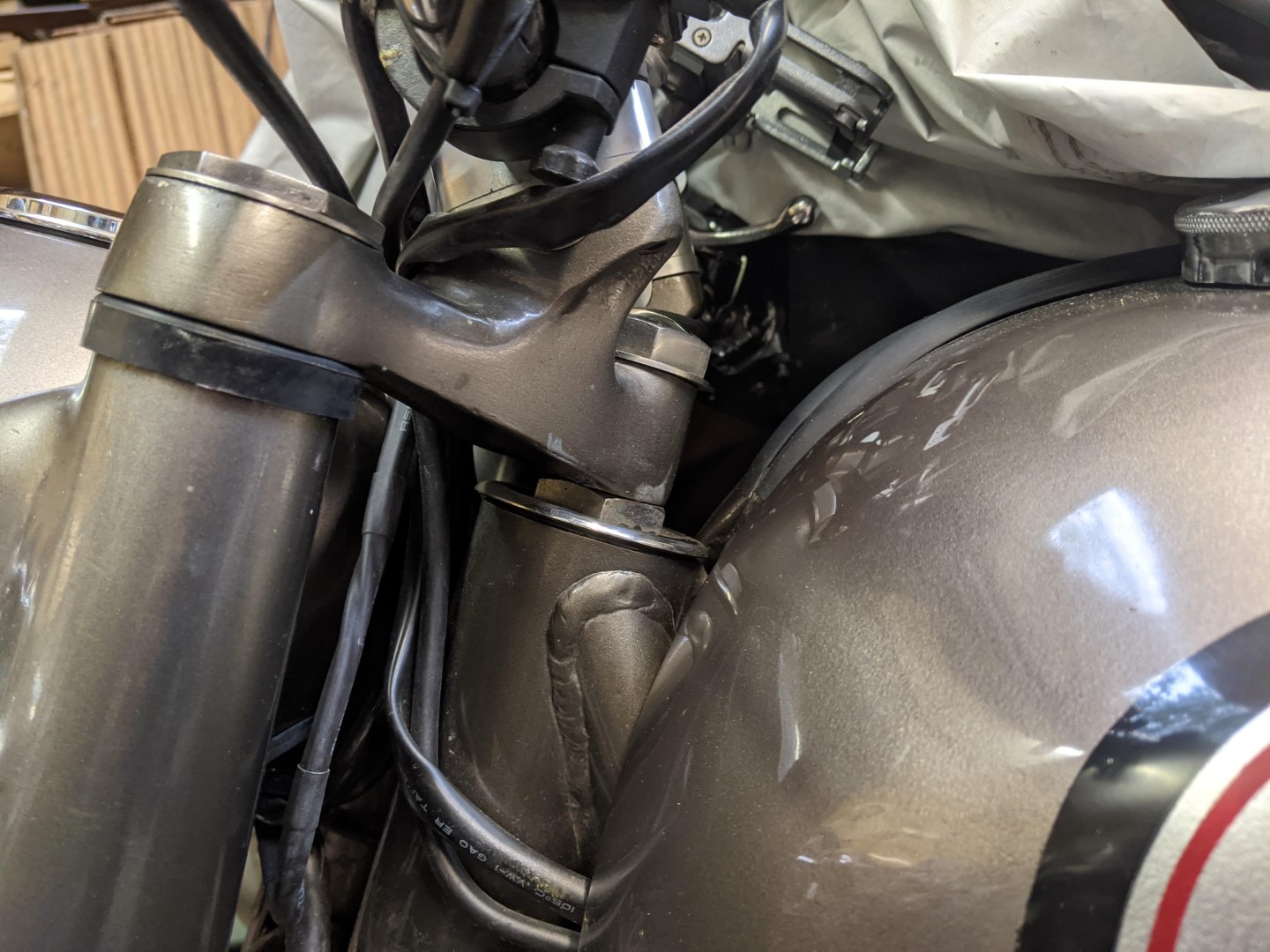

Bob/Eddie Your picture…
Bob/Eddie
Your picture shows the top yoke sat snuggly on the top of the adjuster nut flats. Eddies is sitting on top of the flange. I’m pretty sure the problem is the flange is not fitting inside the top yoke. I think Eddie has sorted them”lack of thread” issue?
