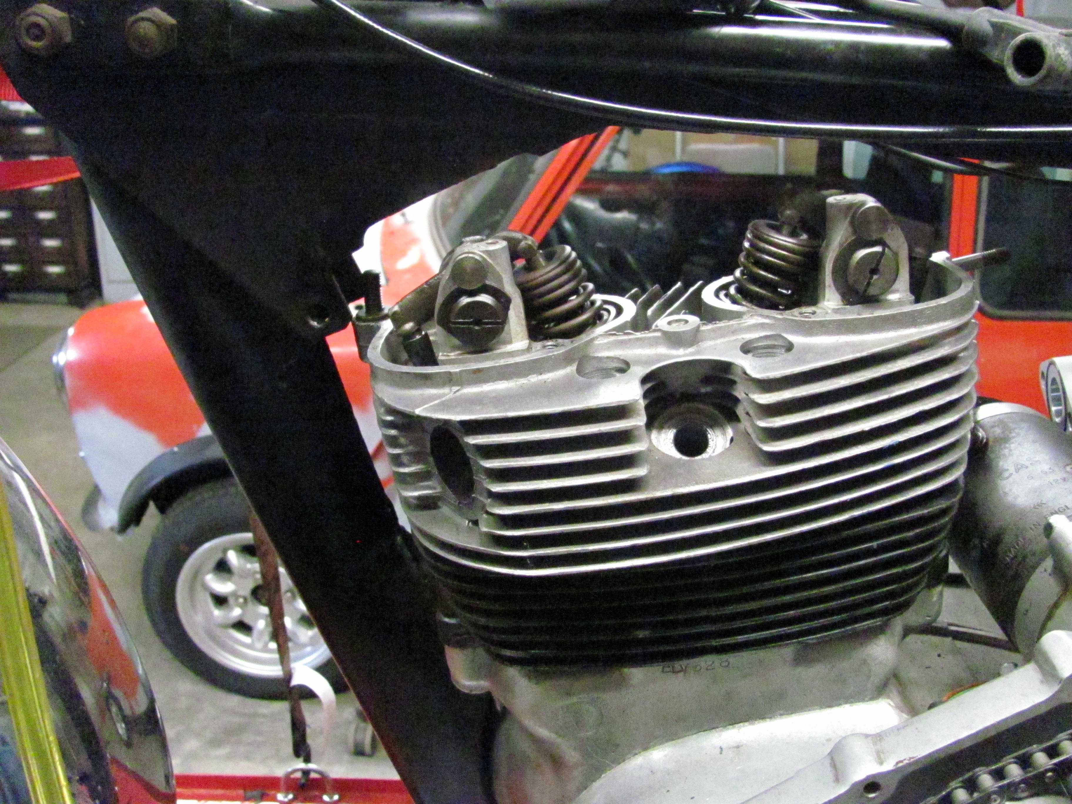

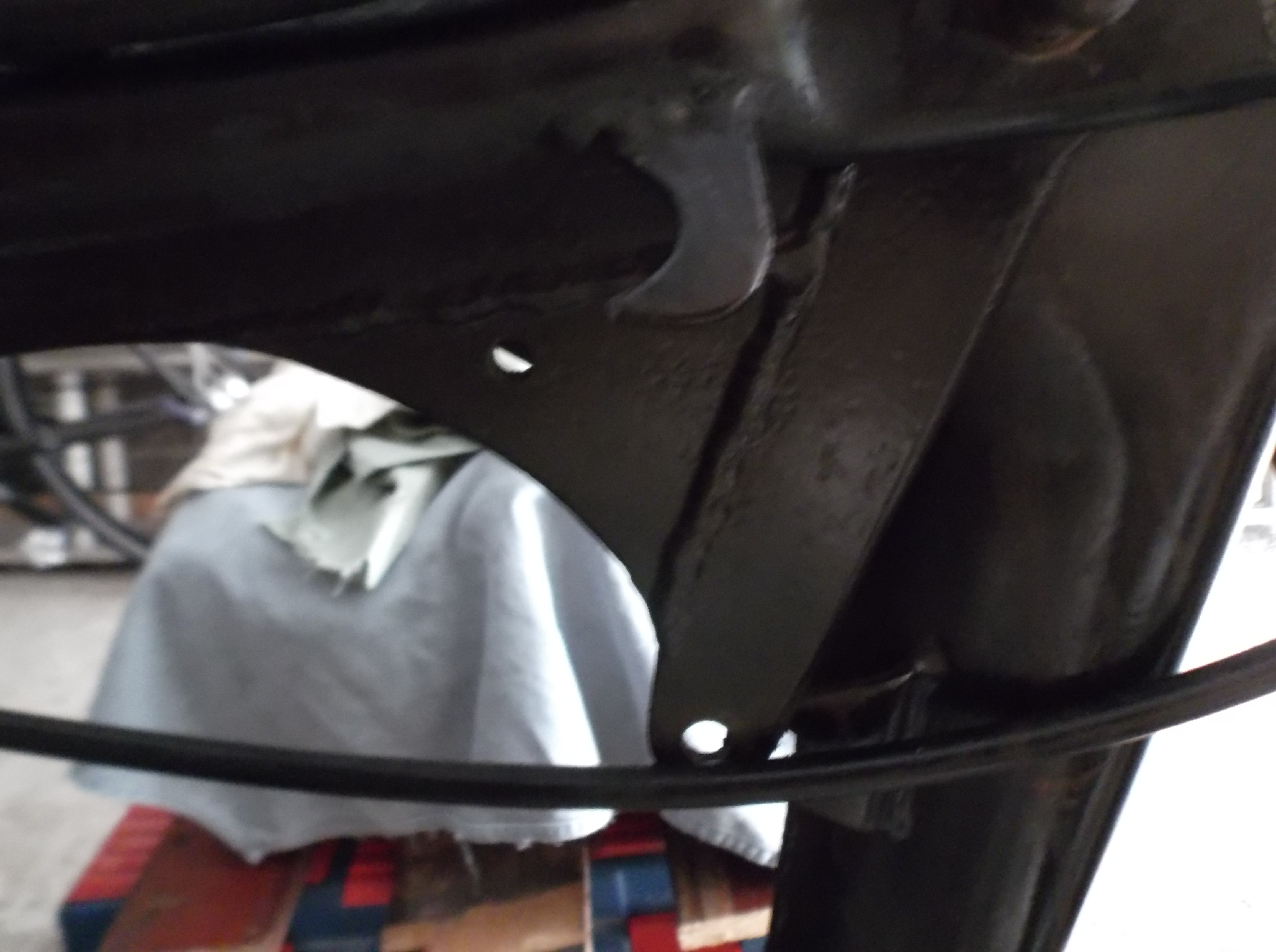

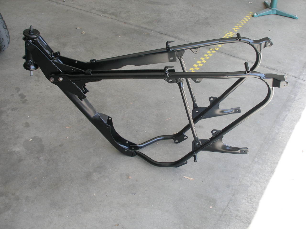

He's a frame pic I found somewhere and a close up of the left side support just in front and above my left hand head. When the head is lifted up for removal, the rocker assembly hits the fore and aft support along the frame and catches the front of the head as well.

The frame supports un-bolt as Peter described. Except for the fact mine have probably been in place since new and are a bit rusty, they came loose relatively easily. This allowed me to left the left side up and remove the head with no problem. A positive result of the heads removal is that both looked quite good with very little mess on the valves. The pistons also had almost no carbon on them. I guess the 4300+ miles on the old speedometer may have been right for this almost 55 year old Norton. Yea.

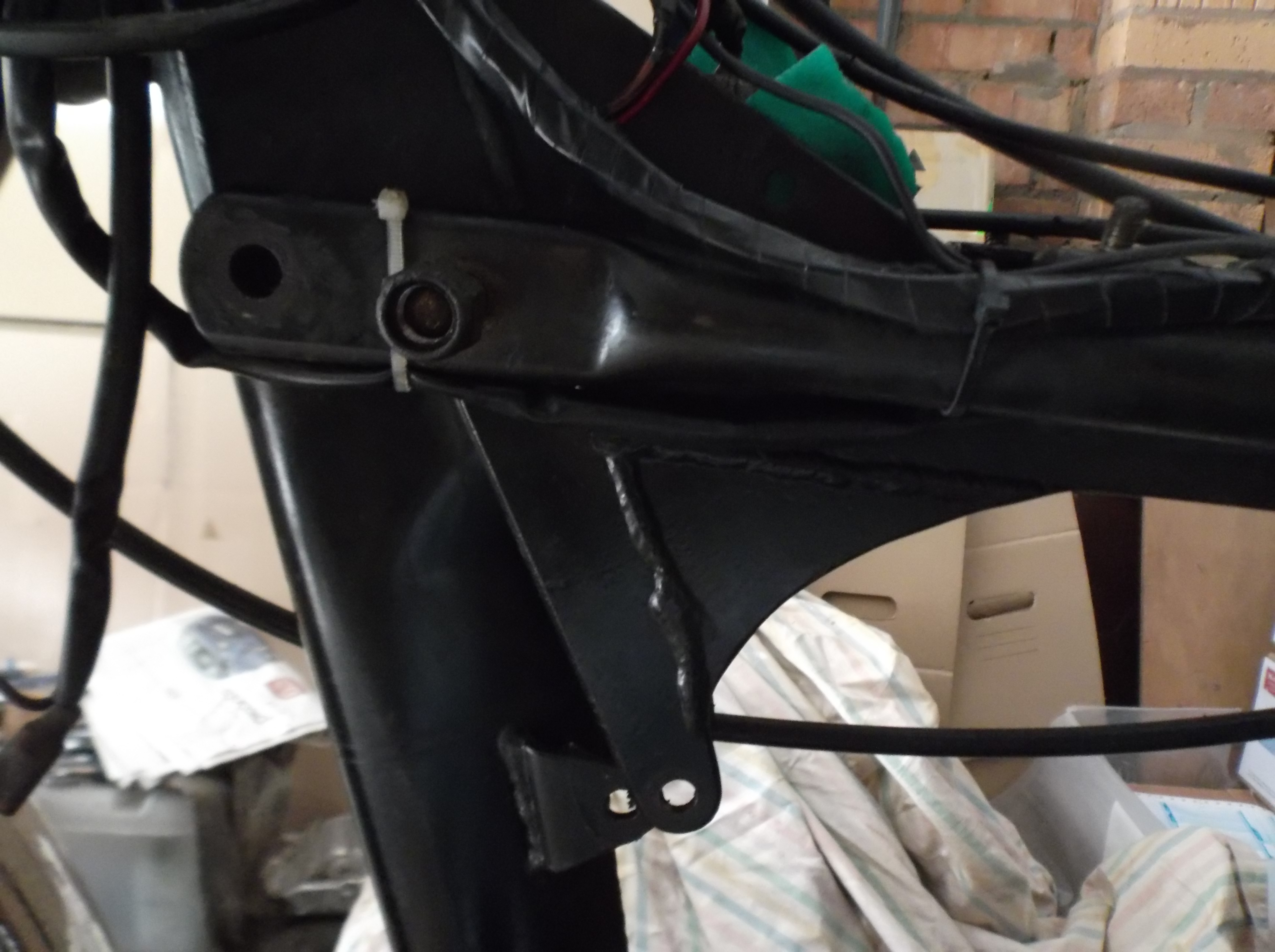

The photos attached show the profile on the strengthening plates on my Electra. I got the tappet covers, heads, and barrels off without unbolting the frame. I presume a previous owner has modified the plates as per some comments elsewhere on the forum. Note the frame is now unbolted because the engine is out.
