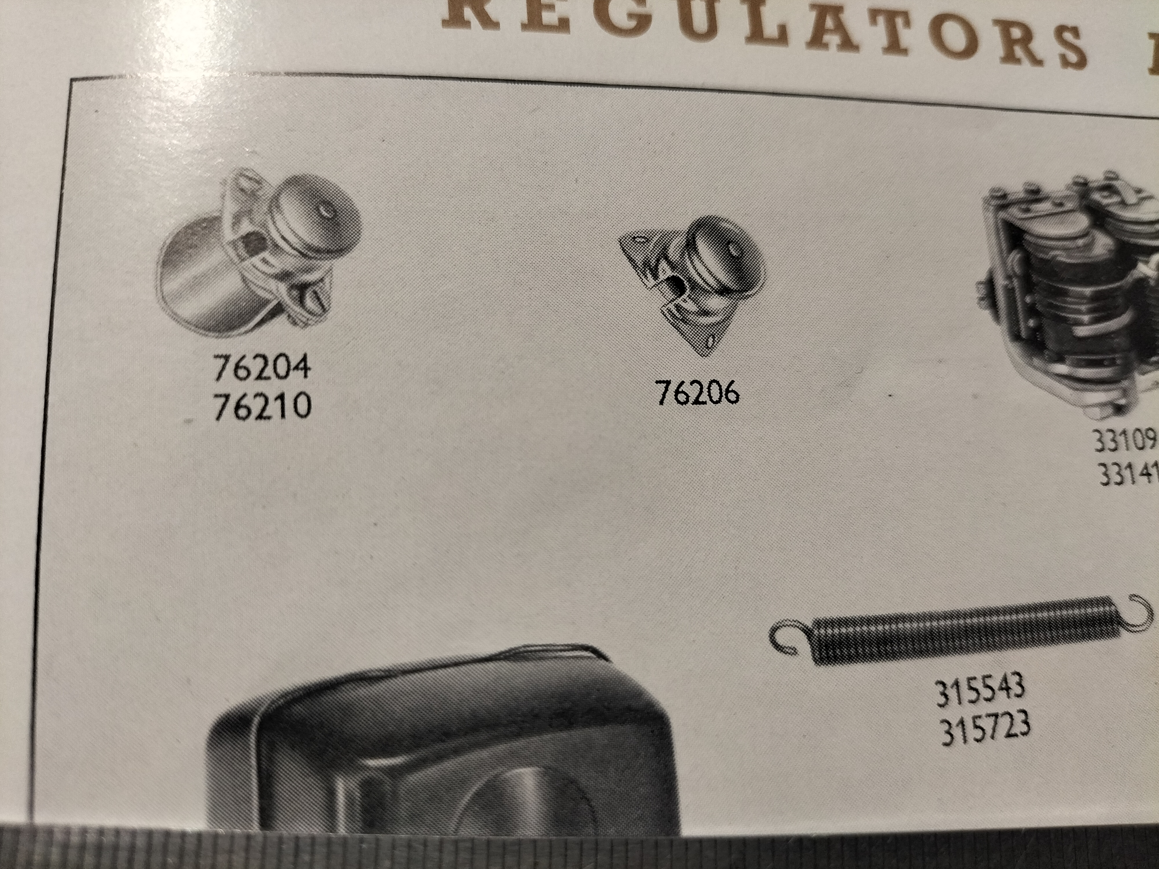

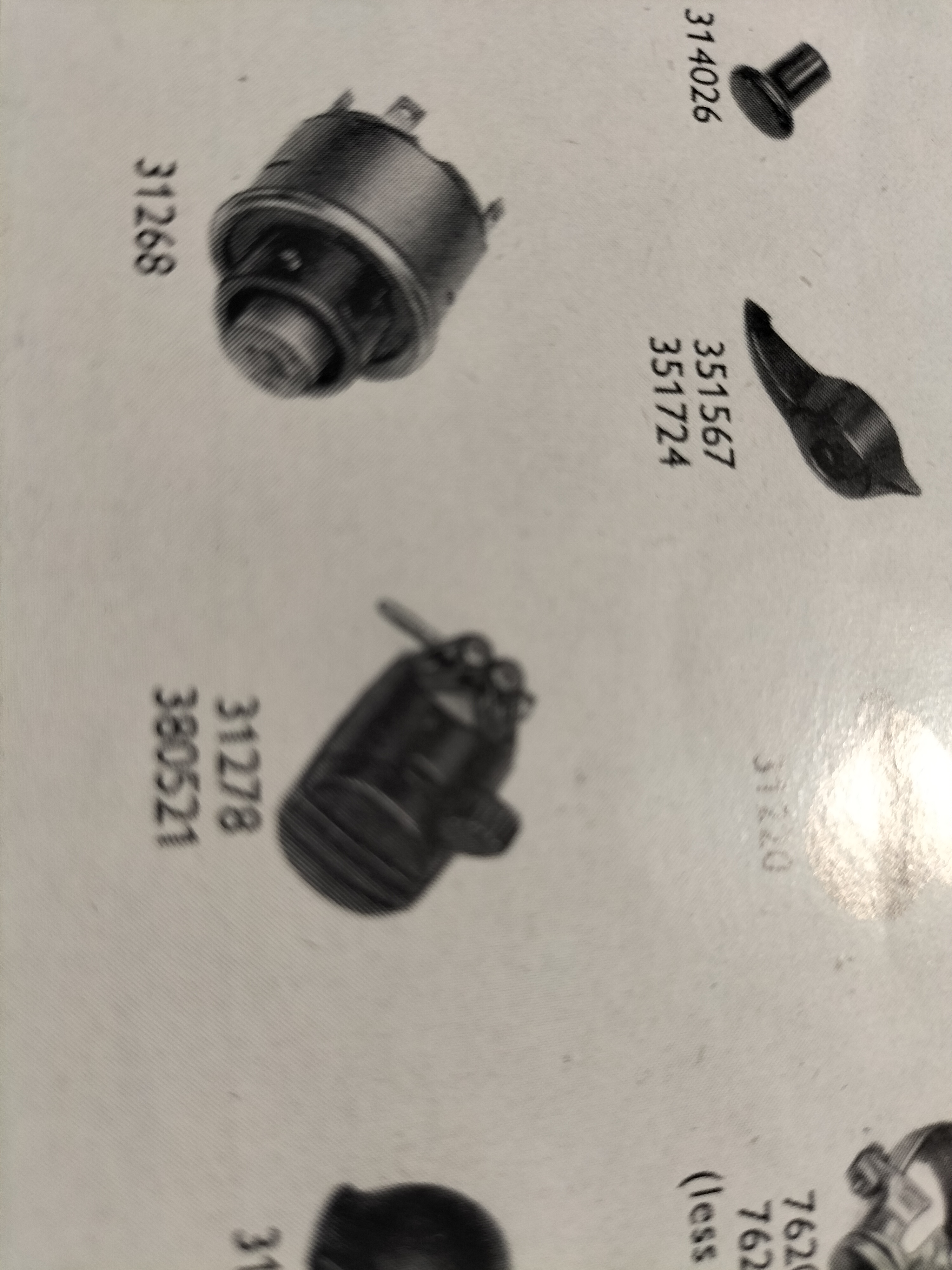

I am replacing the dipper switch of my bike, but I am a bit confused on the right Lucas part to use, the dipper is all-in-one with the horn button or separate?
/Giovanni
/Giovanni
For a 1953 Model 7 the item is a black bakelite dip switch (part number 380521).
It doesn't have a horn button so you will need a separate horn button like the magneto cut out. (Part number 76204)
Photos from the 1953 Lucas parts list are attached.
