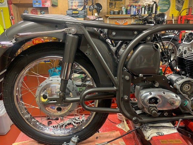

Hello, just rebuilding a US import that was part complete, and noticed the frame is different from all of the other pictures I have looked at - only noticed this when it came to hanging the silencers!
Where the small lug for rear pegs and silencer bracket is normally located I have looped frame tubular. I will work around this but was just curious if this was a frame variant or just a mod someone did. The frame is stamped up and matches engine number - Steve
Frame
Despite the DSN and its conception I have never heard or seen of such a frame! Interesting points here is that the plate at the top of the rear damper unit has been refitted ie poor weld, but the foot rest/silencer loop looks very original fitting. The seat loop is also different, slightly up swept by the tool tray and the continuous loop over the mud guard is new to me. But we all have to remember that this frame is 70 years old! Any one with any ideas?
I've never seen that loop before.  But there is also a mysterious boss at the bottom of the main frame loop.  In my pictures, that corner is always behind the silencer, but it certainly wasn't on later frames.
I wonder if someone used it for sidecar racing, and the loop was added as a hand grip?  The only time I rode on a flat sidecar I had to hang on to a fan belt attached to the frame.
It's on the right, where (I guess) a sidecar might have been fitted in the USA,  possibly with siamesed pipes on the other side (not UK side), so there was no need for exhaust pipe hanger?  Did it come with an exhaust fitted?
Hi there, it had exhausts fitted (not siamese) but no silencers - and the frame loop is on both sides.
The boss at the bottom of the frame, that is on both sides too with through tubular in between. I have never had a dominator before so didn't really think about it when I stripped it down.
Sidecar mount is a good call, but nothing looks amiss at the steering head or down tubes - I think they would have bodged a bracket there as well.

This frame is most likely a 1955 or 1956 version of the Featherbed. So with a non bolt-up type of frame. It has the wide top rear loop of the Manx and International frames which accounts for the shaped oil tank.
The earlier bolt-up frame had a droopy rear sub-frame loop that supported the rear mudguard. Whereas the 1955 on welded frame rear ends stopped short by the suspension units.
Clearly this frame has received a few serious modifications for what ever purpose.
The triangular rear passenger footpeg plate has been replaced by a piece of piping / tubing that just looks completely wrong.
The top of the rear frame should stop around 4” after the rear suspension top bolt. This frame has been extended with some heavy duty pipe-work to emulate an earlier bolt-up version.
The factory has never really explained the strange chunk of cross-tubing at the bottom rear section of the Featherbed frame. The best suggestion being to add strength to that frame section in the event of a side-car being attached. Though, for the rest of the 1950s, Bracebridge always claimed that the frame was not designed for use with a sidecar.
Nice colour!! Or should I say color? The idea of hanging onto that loop while 'in combat' in the chair, with the rear wheel that close!! No thanks.........
Thanks for the feedback, its a strange modification but although it looks 'wrong' I quite like it and will try to learn to live with it. I was just curious if it was a factory variant or a owner mod - looks like the latter. Great forum - thanks again. Steve

The modification to the rear subframe suggests to me that rear loads were expected. Got me wondering if loaded panniers or crash bars needed a sound fixing on extended pillion loops like yours. Is this a police bike?
My own craven panniers, remarkably heavy when fully loaded, absolutely require good support near the bottom to prevent swing about the two upper rail fixings.
Peter - could be a pannier mod, I didn't know the US police used Nortons. Maybe owned by a guy who toured with it, but the welding on the loops is very good, much better than the rear frame.repair.

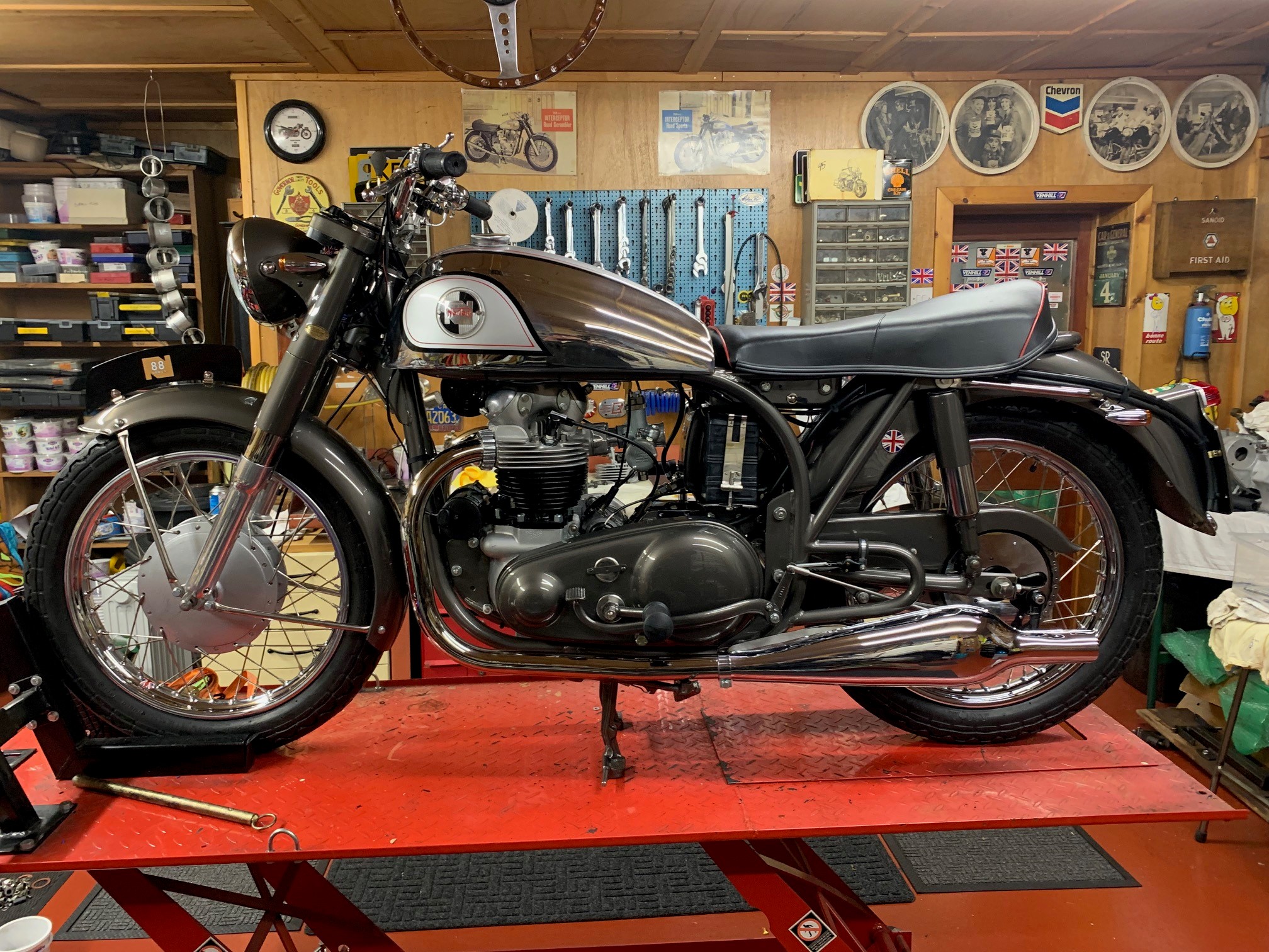

Finished last night, went together Ok, had problems with mag sparking when on bike (it was the earth screw next to mounting flange) and had to make new silencer brackets bolted to lower cross member at the rear of the frame. Still needs a road test. Steve

Steve you've done a lovely job, it's a credit to you. Can I ask how you got the correct shade of early Polychromatic Grey? Did you use VW Platinum LD7X?
I'll make a note of the colour type etc for when I find a '54 88 Domi, hoping to get one when I sell my '72 Commando.
wow ! ,what a lovely job.  A very individualistic looking machine. The only line I would question is the battery that appears to lean backwards . And its clear what those loopy things are for ,   somewhere to hang the brake switch !!.  Some Dommies have the appearance of engine etc  lolling backwards too (a bit sad looking) , you have avoided that somehow , Longer than std rear suspension units ?. I can see a few prizes comming.

The battery box is rubber, so when I tighten the strap it goes a bit wonky - will swap it for a hard case at some point. Once its off the ramp it might sit differently - I'll know this weekend. I am just waiting on some petrol pipe to hook up the carb before I fit the tank strap in case of leaks - but it is oil tight so far!

My records indicate two batches of modified Model 88s sent overseas (poss USA) in Police trim. One batch of three in Jan 1955 and a second in Feb 1955. Could your Norton be one of these? Have you got a frame number that you would be willing to share?
Hi Philip, yes no problem - it has the I22 prefix, then 62176.

A strange thing about the loops is that, if they were designed to provide a fixing point for panniers, footrests, silencer etc, there is a complete absence of any drilled lugs, brazed onto the loops, through which to fix them. They may have been cut off at some point in its life, of course, but too late, now that it has been painted, to look for any tell-tale signs of such.
Police 'bikes would not have had pillion footrests of course, so Peter & Phil may be onto something there.
I should have noticed it was wrong before I got it painted - I would have welded on lugs for the silencers.
The brackets I made for the silencers are bit clumsy but they will do. I have a couple of struts off a set of Raygun silencers from a Rocket 3 and even contemplated using them! I'll leave that plan on the drawing board for now.
It has the exposed battery, bolt-on rear mudguard section and round footrest rubbers.  That suggests a transition between 1955 and '56 spec.
I like the early '50s polychromatic blue better than any poly grey, but then I may be biased -I have one of those.
