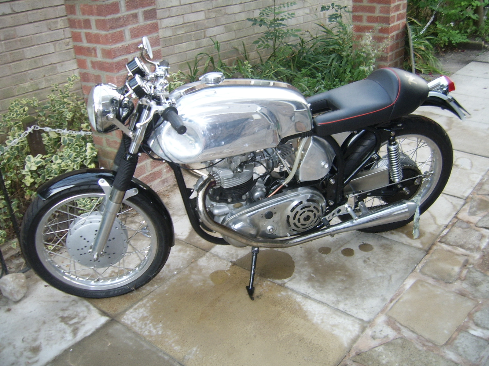

Hi John,
I have a Dommie  racer just finished but not yet used. Same sort of set up,no issues with fitting the mag. Might move to Boyer....
No issues fitting a Boyer mag replacement.
Thanks to Robert T advising not to overfill G/ box and engine oil. Now first kick starter.
My 88 Dommie Racer.
I was thinking mag in case of an EMP   I'll see how the mag goes. 16H ready to ride......
