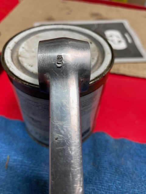

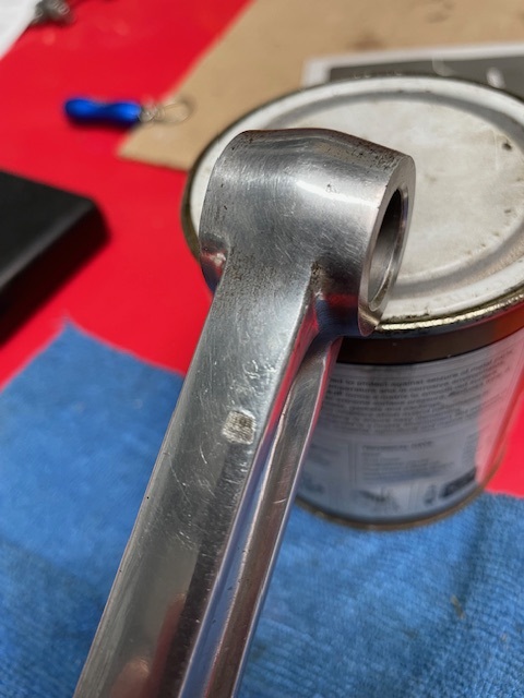

Close examination shows some minor damage to one of the rods in two places.
Minor may not be the correct adjective in connection with rods (no pun intended).
As these rods are of unknown provenance, I am minded to replace them as I will have a new crank (incl bearings etc), new +0.010 Hepolite pistons (incl rings, pins circlips etc) in newly honed barrels to suit and a completely refurbished cylinder head (incl valves, guides, seats re-cut, pushrods, rocker balls etc).

if those rods are otherwise straight/ parallel etc, they could be polished out, IMHO.
   Otherwise, I would go for the NM23258 option.
Remember you'll need to account for the larger pin diameter if using a rod without a bush. The small end diameters were the same diameter whether you had a bush or plain small end, but the pins used in the plain small end are smaller in diameter.
