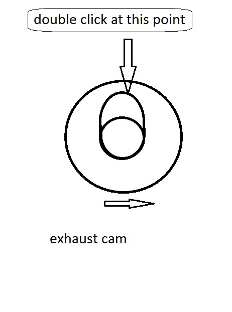

on my 1955 single cyl es2 engine
i have a double click sound on turning the engine over slowly. with the plug out . when i look at the push rod adjusters through the inspection cover the clicking noise seems to correspond with the exhaust push rod. roughly in the position indicated on the cam lobe in the photo.
i have had all the head and piston plus liner and little end done some time ago. the problem is this click turns into a loud clacking noise when the engine is running .my thought are could it be cam wheel loose on its shaft.i have checked the push rod ends before now plus the cam wheel teeth seem to mesh ok. the pushrod adjustment is ok. been trying to find what it is for some time now. any thoughts.
barry

Valve length ?
Hi Barry,
I agree with Dave and Dan, when the lifter spindle is fitted the arm should move several degrees either way with-out the cable attached. If the spindle is original, the valve might be too long or sunken into it's seat. Another cause may be the rocker arm is bent or faulty in some other respect.

Woodruff Key?
Any chance that the half-time pinion woodruff key is a sloppy fit?

hello, just wondering. how…
hello,
just wondering. how are the cam wheels held onto the cam shafts are they a press fit or is there a key way .
barry
I spent ages...
... tracking down something similar on a Matchless G80. It turned out to be end float on the inlet cam.....

Barry, Cam wheels have a…
Barry,
Cam wheels have a woodruff key, I know because I sheared one! If Mike did the head I doubt the problem is there.

Barry, did you ever get to…
Barry, did you ever get to rhe bottom of this, as I have the same clatter at the same points, on both inlet and exhaust..
Garry
could the valve lifter be too close to the rocker or the spring too weak?, this would give a click when running.
