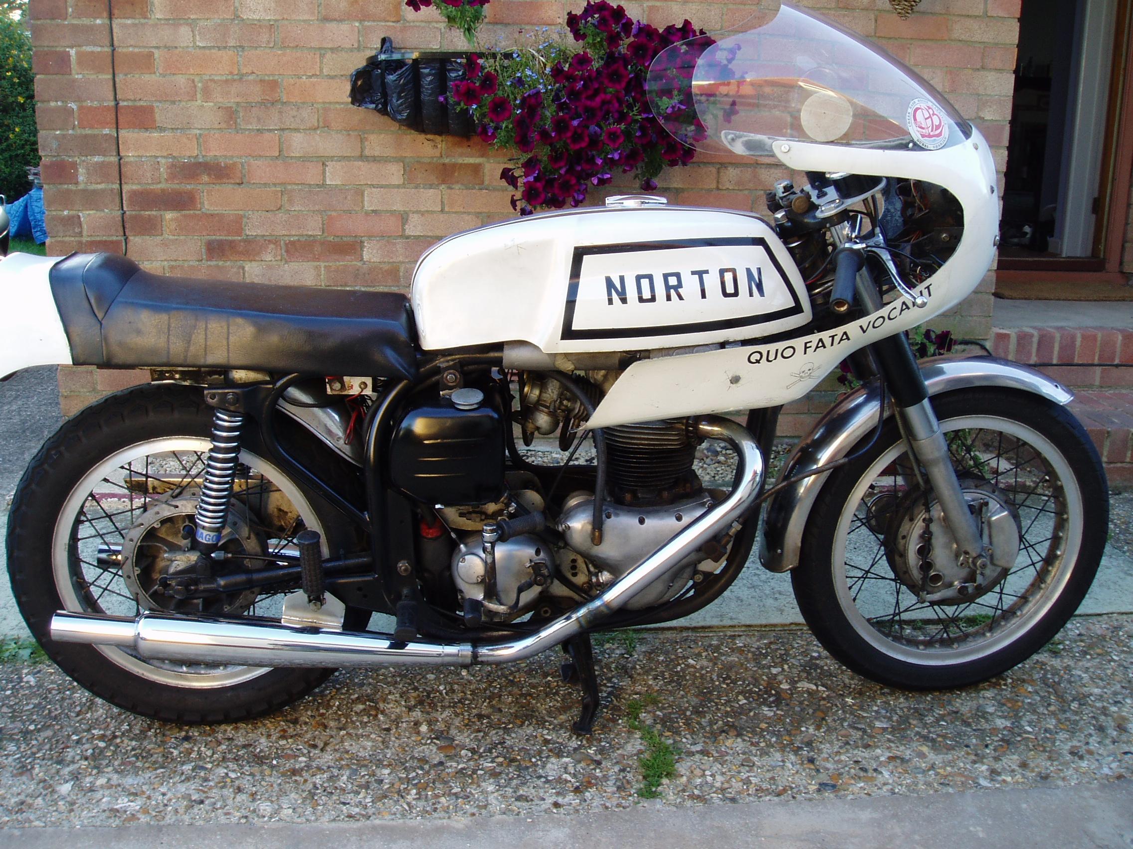

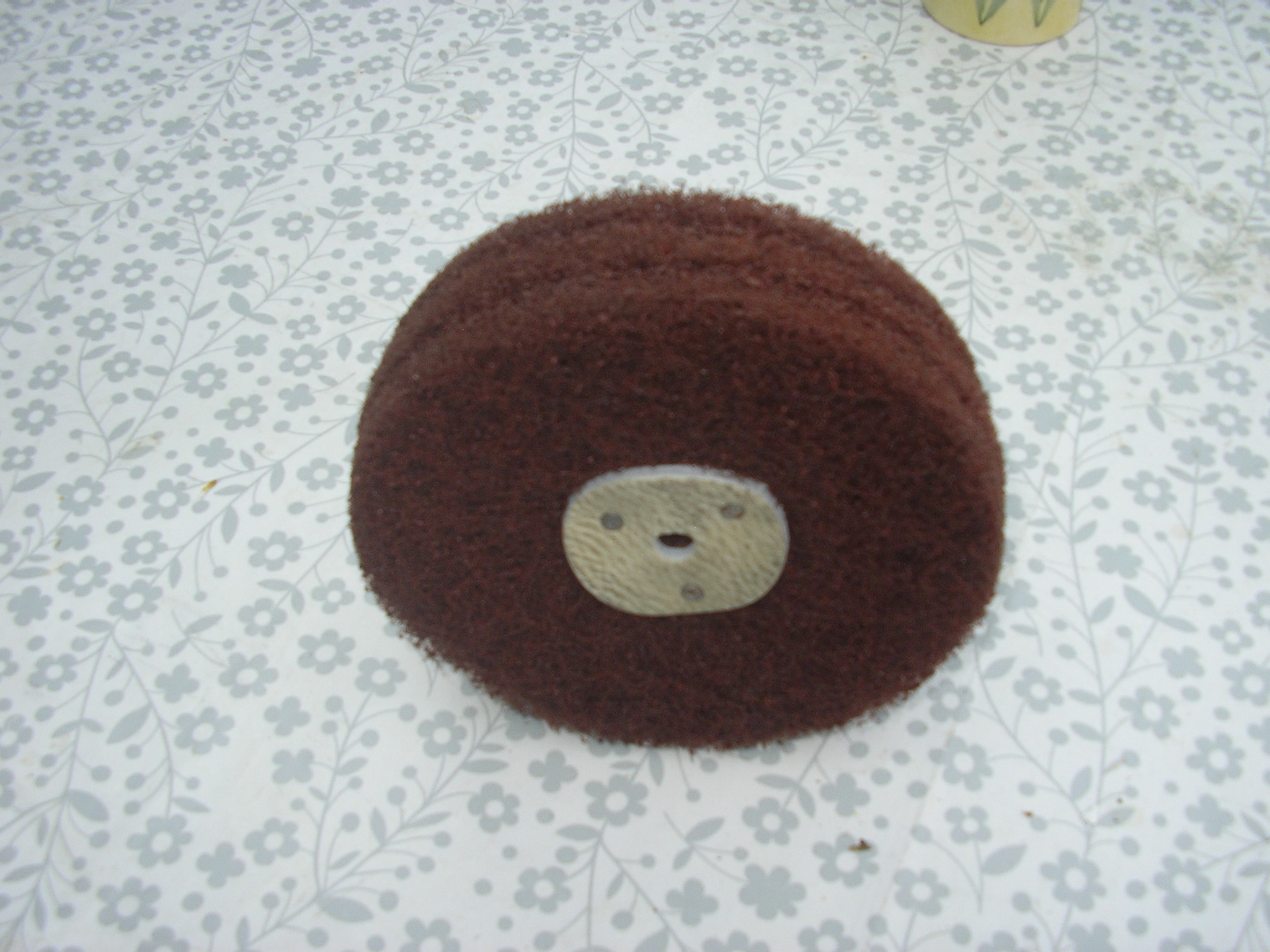

20 years ago I purchased a set of replacement sweptbacks for my Atlas. These pipes, from Armours needed a tweak on both sides in order to give clearance in critical areas. Heating and bending in selected areas resulted in a good pipe fit but serious bluing of the Chrome. Polishing with Autosol did help a little but the most effective solution was a rotary scouring disc. This removed the bluing fairly quickly leaving a matt finish. Some manual handwork with Chrome cleaner helped to sort that out.
Attachments show problem and cure.
That looks like a proper coffee bar cowboys bike Phil,   Were you really one of those ?.  If so you can join my club !.
