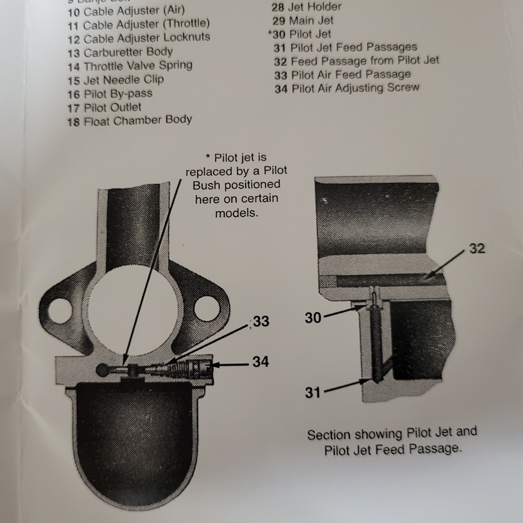

Attached is pic taken from the lovely new color pamphlet that came with the Premier.
As per the this new color pamphlet, is the 2-piece brass/steel screw on LH (non-tickler) side of Premier now called the "Pilot Air Adjusting Screw"? (pic attached).
The steel tapered screw on the RH (tickler) side of Premier is what I would normally identify as the pilot air adjusting screw (on tickler side) identified as such in old AMAL pamphlets of yore. Logic would seem that the brass/steel screw with holes is an adjustable jet replacing the fixed jet in the old Concentric. And the tapered steel needle screw is now simply an air screw that helps mix the AFR in concert with the new brass/steel screw which is is an adjustable jet.
The new pamphlet does not identify nor depict both screws, i.e., the steel screw -and- the brass/steel screw... The pamphlet only shows 1 screw and as depicted, it is difficult to tell which of these 2 screws are actually depicted although i would say the screw depicted in the pamphlet, identified as "34" is on what appears RH side of carb, therefore the steel screw. (I am suspecting the pictures in the color pamphlet are not depicting the Premier; in fact are depicting what is seen in the old AMAL pamphlets...)

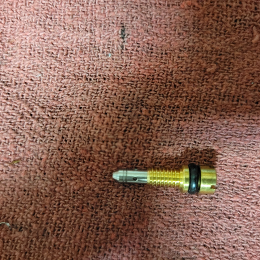

In my Premier i see nothing that looks like a "Pilot Bush" nor a "Pilot Jet" as depicted in the pamphlet that came with my Premier... That being said, i don't see a small jet that i would expect to see a number on it such as "30" or "25"...
Does the brass/steel screw in the Premier replace the pressed-in pilot jet seen in the "old" Concentrics? My internet research reveals this brass /steel screw is called the "pilot jet" and bear no numbers on them, however apparently they come in a variety of sizes, i.e., 15, 17, 19, 21 etc. https://www.classicbritishspares.com/blogs/news/amal-premier-pilot-jets-and-tunning
Will appreciate very much your experienced thoughts. Kind regards.

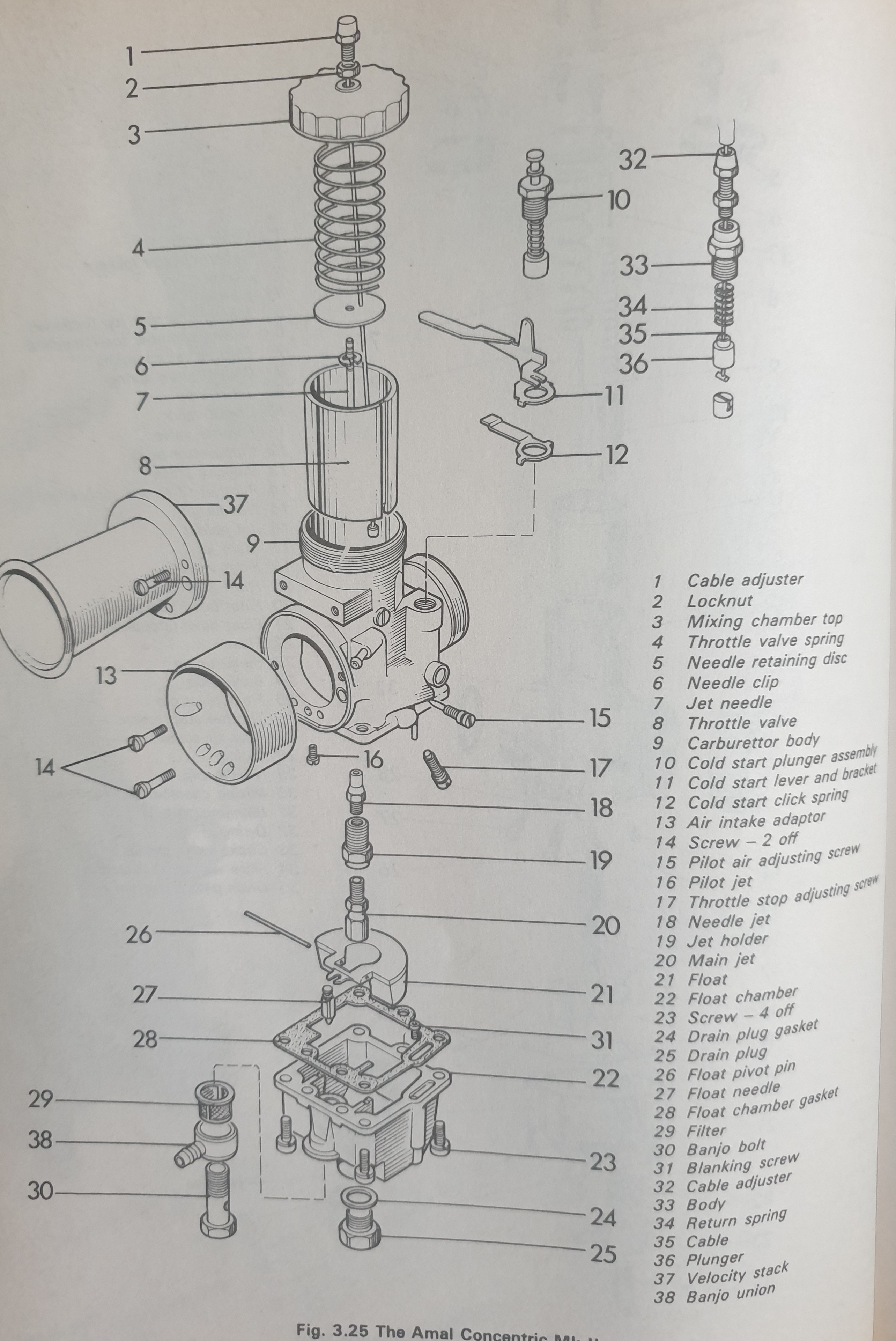

My interpretation ....
Thanks Michael...
...reading the cover of the pamphlet, it says it is for the Mk.1 Concentric, so i am guessing it does not cover the Premier. Appears that I may only need to replace the #200 main jet assuming the pilot jet is the correct size. What i'm reading on the internet, the Premier is an improvement on the earlier Concentric; more tuneable with the adjustable pilot jet. i need to better understand how the air needle on the right works with the pilot jet on the left. When both are removed, i can see straight through.
David, thank you for...
... your post showing the Mk.2 info; the carb i have is the Concentric Premier
Take the bowl off
You will see the pilot jet if fitted. The replaceable pilot jet (various sizes) is located in the feed passage at the end that terminates inside the float chamber. I'm running on a 25 at present. The fixed diameter bush that the pilot needle controlled was the original solution, the variable adopted by Premier I believe.
The screw works slightly differently as it does not enter the now "non existing" bush to meter the pilot air flow.

The only thing i want to better understand with the Premier is how the adjustable pilot jet on the LH side works in conjunction the pilot adjusting screw on the RH side; this screw is directly in front of the tickler. The old Concentric's were blocked off in the area where the adjustable pilot jet is now on the Premier.
Removable pilot jet
Just for info, the removable or changeable pilot jet was a feature of the 2-stroke version of the concentric. 4-stroke versions we all know and love had the fixed jet.

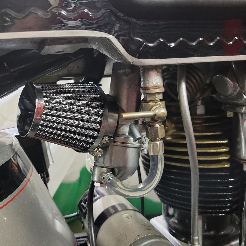

So far I think I have a winner...
i rec'd the plastic float and new needle and had no leak on bench test. Float chamber on carb, regardless of any position forward or aft the sucker leaked. I decided to give up for the time being. Will find a suitable box and put the aged gem away.
Installed the Concentric Premier and have the pilot screw dialed in for a steady even idle. Tomorrow evening, i will go for a ride and see how the carburettor performs at the different throttle openings.
The leather washer pretty much solved the Tell Tale oil geyser. There is nominal leak out of the tube, a bit more so from the top than the bottom. I can live with it. The bottom housing has a pretty good leak; i can live with it at least for the time being. It seems I am closer than I have ever been to begin putting some time on the engine and get some miles smiles.

I also learned that the pilot jet...
...on the Premier is turned in to home, you fellows likely may already know this... If accelerating from an idle to 1/4 open is not smooth then a larger or smaller jet needs to be tried to. Pilot jets sizes are apparently from 15-23 and the Premier comes standard with a 17; the smaller the number limits fuel, the larger the number permits more fuel. Will see how things go on my next test ride. Given i am running a small air filter at 5,000 feet, i may need to move down to a 15, but at 5,000 feet we are on the cusp of needing to make any jetting changes, so the 17 may perform ok.
A further note on the pilot jets used in the Premier, the different sizes of jet are identified by the number of rings in the jet, a 15 has one ring, a 17 two rings, a 19 three rings and so forth and so on.
