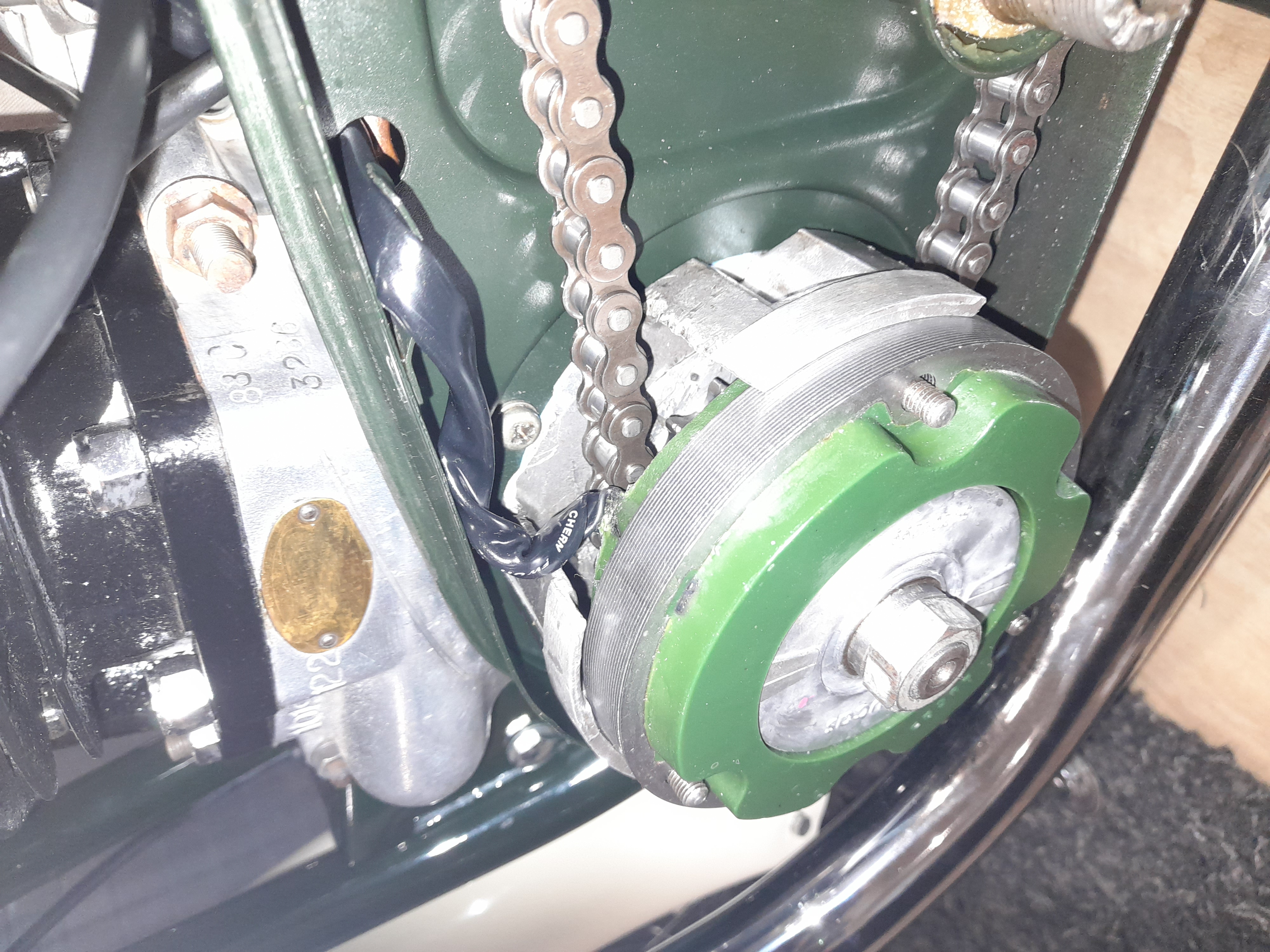

Just got a new 6v alternator for the Dominator and the wires are uncomfortably close to the chain.
Am i doing something wrong. Should the alternator be flipped.
Seen in some pics if Commandos with the wires coming outthe front of the alternator, not the back

So having the alternator on one way or flipping it over to the other doesnt affect it in anway in regards to creating power? Interesting!
Even if i tighten it down well it will move because the threaded shafts are loose fit? Bugger. Was hoping to have it on the road this week. Looks like ive got to find a solution.
Turning it round makes no…
Turning it round makes no difference. . cable tie the wires out of way of flappy chain. You sometimes need a crank spacer to position the rotor. I made some sleeves from a tin can ,thats why I'm Bodger Bob !. Should not be necessary though. I am considering fitting thicker studs.

Ps: my alternator wires also exit to the 'outside' of the stator, and to prevent damage are cable tied to the small bracket between the stator and footrest tube before passing through the grommet to the outside world..

Osborn, but as long as you pay your bills and buy the bits we do not mind (too much) The position of the alternator wires is NOT critical at all, except to be away from the wire chewing chain!! Certainly 12V is a better way to go, greater choice of batteries and bulbs and ignition systems. Surely 3 or 4 pieces of 8 thou plastic around the rotor will do the job? but tubes or stepped studs must the answer to the slimmer studs in the alt holes. 8 thou is the minimum clearance nay less and you are in deep sh1t

New alternators are different. I have " my" wires coming out the front , and yes the cover is a bit too close. You appear to be missing a grommet and your mounting studs will need tin sleeves or similar to stop the stator moving and seizing all up, Someone needs to supply some stepped up studs for the new alternators , COME ON SUPPLIERS !!. wake up.
