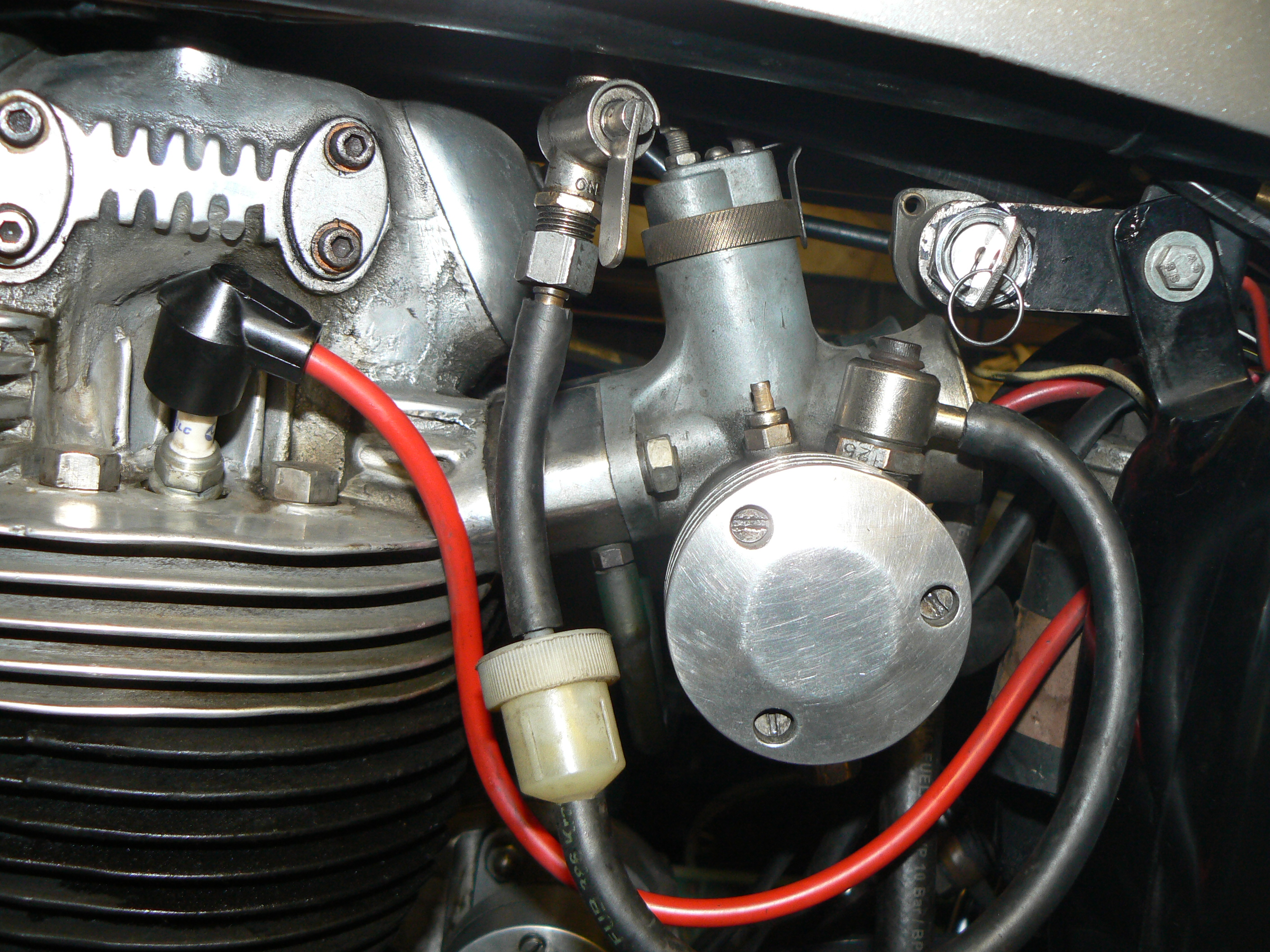

hello please where is right fuel level in monoblocks on 650 ss ?
i have many thin washers under ticker body that makes level higher and i dont know if is it right:?
what diameter of main jets do you use ? in manual is 250-270.?
thanks
Have a nice day.
Tomas

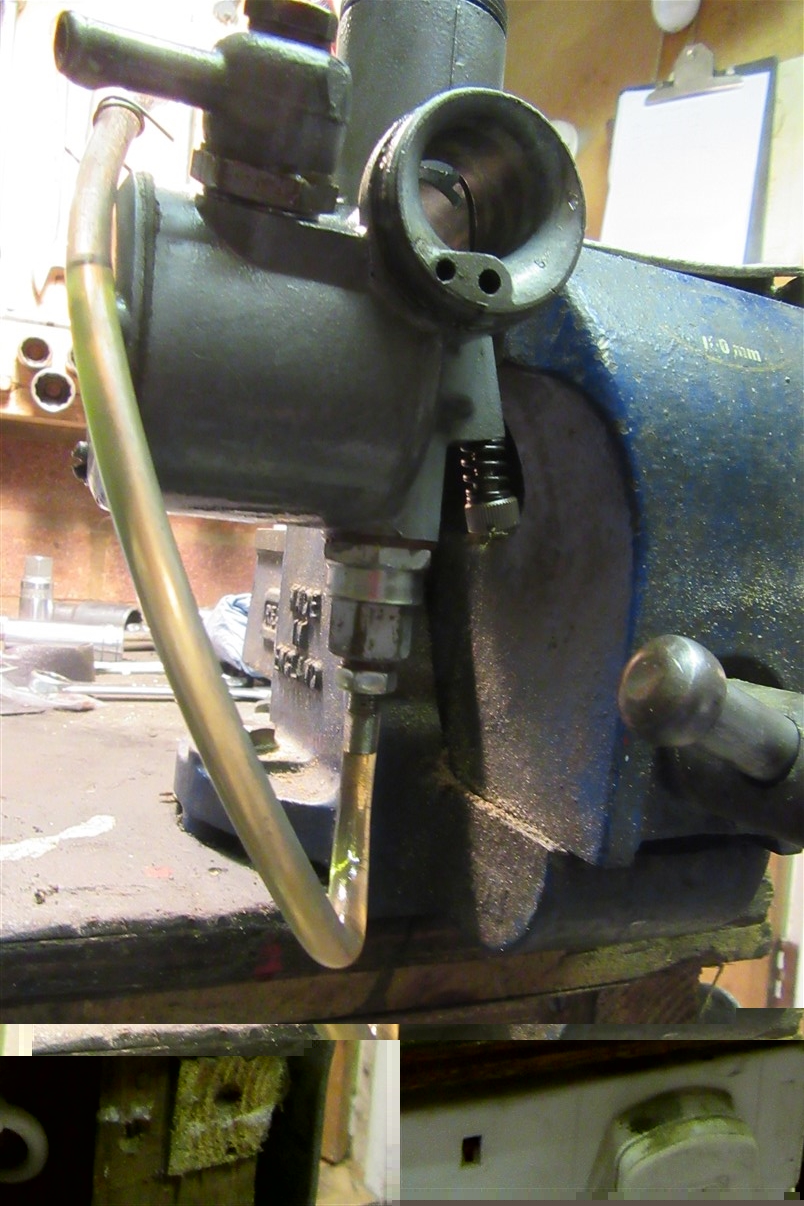

.. on the float chamber cover showing where the level should be. I made up a clear plastic tube fitted to an old bottom union as in the pic.float level
Ian

You can cut a piece of acrylic to make a temporary cover to see inside. Make it well oversize so the fixing holes can be drilled easily.
... it's easier to make an adaptor for the bottom union (or pilot jet).
then it is easy to undo the union from both carbs and refit to left carb only with the link pipe bent up alongside the float chamber. Gently bending the pipe down, as soon as it starts to drip it will show you the fuel level without having to make or modify anything. If you are feeling rich, of course you can buy another banjo and fit clear pipe to it to make it a little easier.
As Ian says, the 'dot' on the cover is the official level, but just be careful that the cover is correct - there were different ones for left and right float chambers, and these will fit either carb, but the word 'Amal' won't be level. The fuel level in use should be just below the pilot jet.
