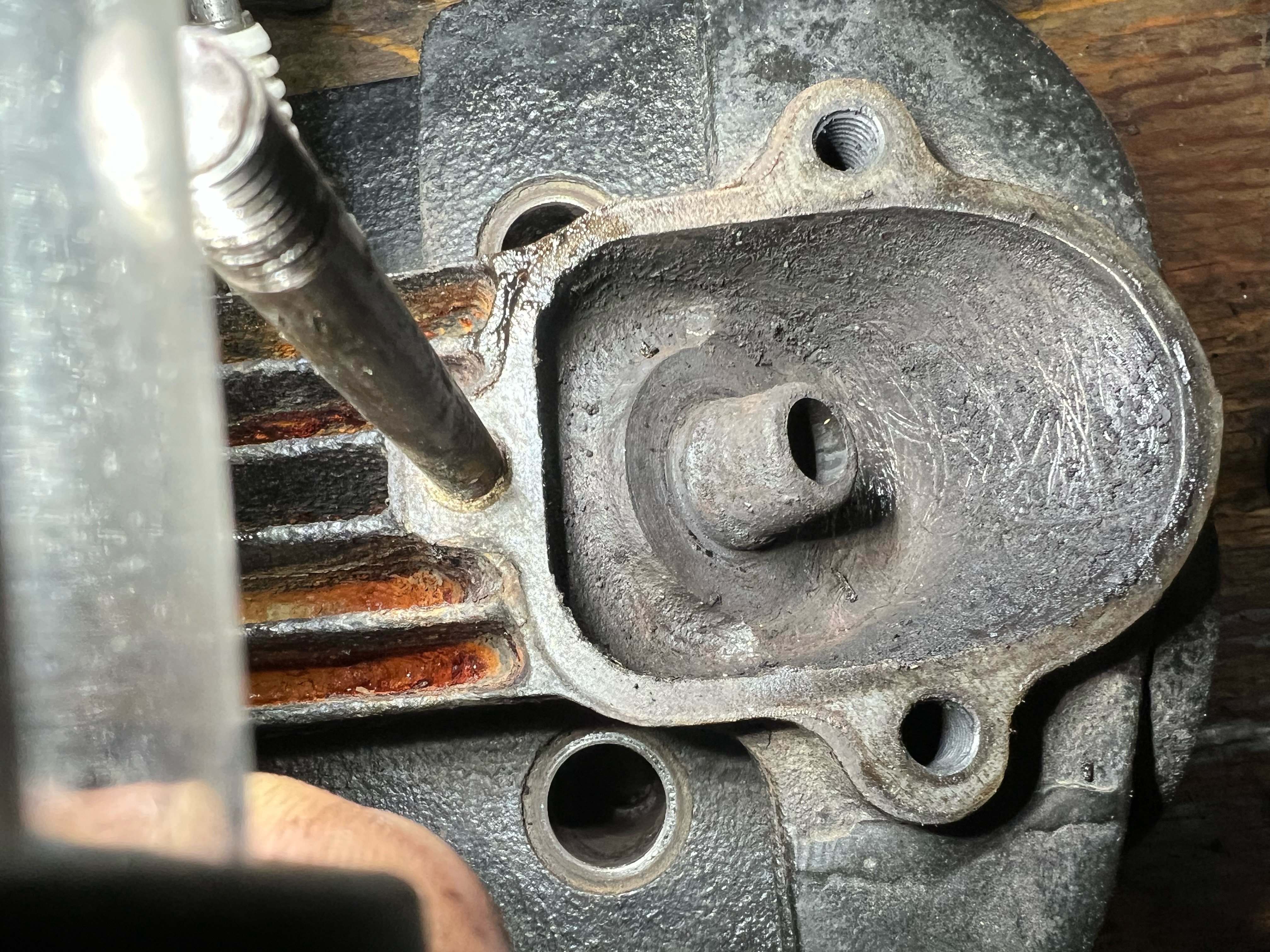

About 1000 miles ago I replaced the exhaust valve & guide ( cast iron ) in the 38 ES2.
The other day I decided to remove the head due to low compression .
My exhaust guide was worn out and the valve seat had a thin layer of carbon almost all the way around except for an area about 3/16. Underneath that carbon  was a badly pitted valve .The seat in the head looks perfect.
The cavity for the intake valve spring was damp with oil as it should be but the exhaust was dry and had a thin layer of carbon on the sides and around the guide plus a small amount on the valve stem just below the valve collet groove . I scraped most of it off but you can see from the photo how dry it is.
Thoughts on this is appreciated.

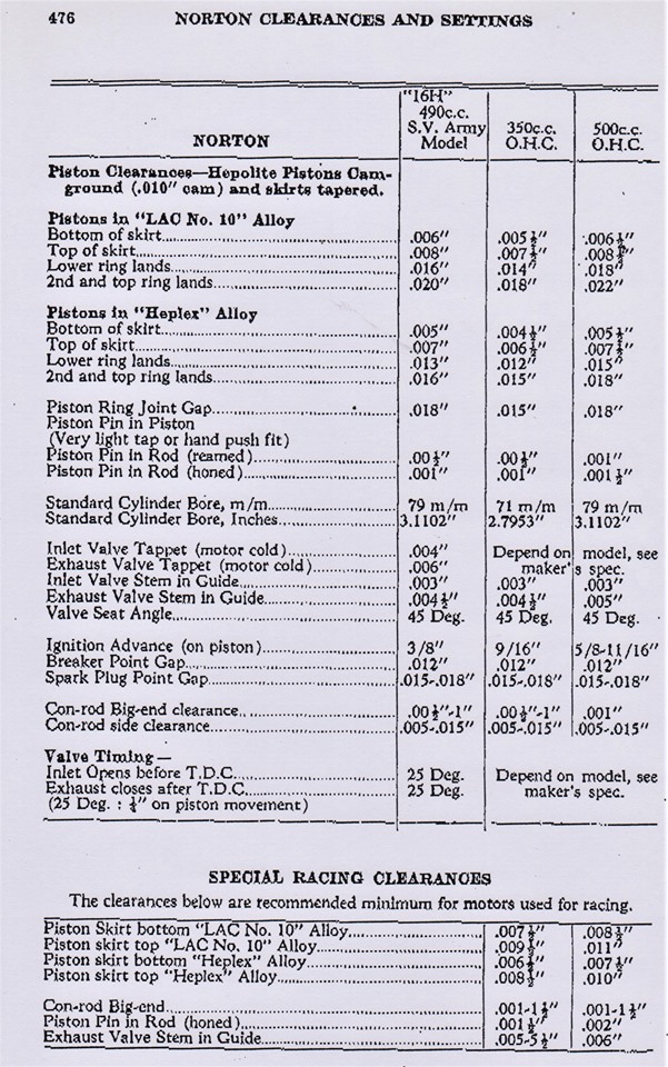

I couldn't find any info on valve stem to guide clearance when I did my exhaust. The shop used .004. Is this correct for both Int & Exh ?

I'm not sure where this chart came from or why it only includes WD16H and OHC, but my feeling is that clearances on the loose side are a good thing.

The inside of the rocker box is wet with oil for both In & Exh.The carbon build up in the Exh cavity  must be from the oil cooking.
One of the previous owners fitted a grease nipple to the housing, not sure why filling the cavity with grease would help.
I've heard the carbon on the valve seat stops the valve from sealing causing the seat to burn creating pits.
But why does it build up in a thin layer? One would think when the valve seats under spring pressure the carbon would be removed.
