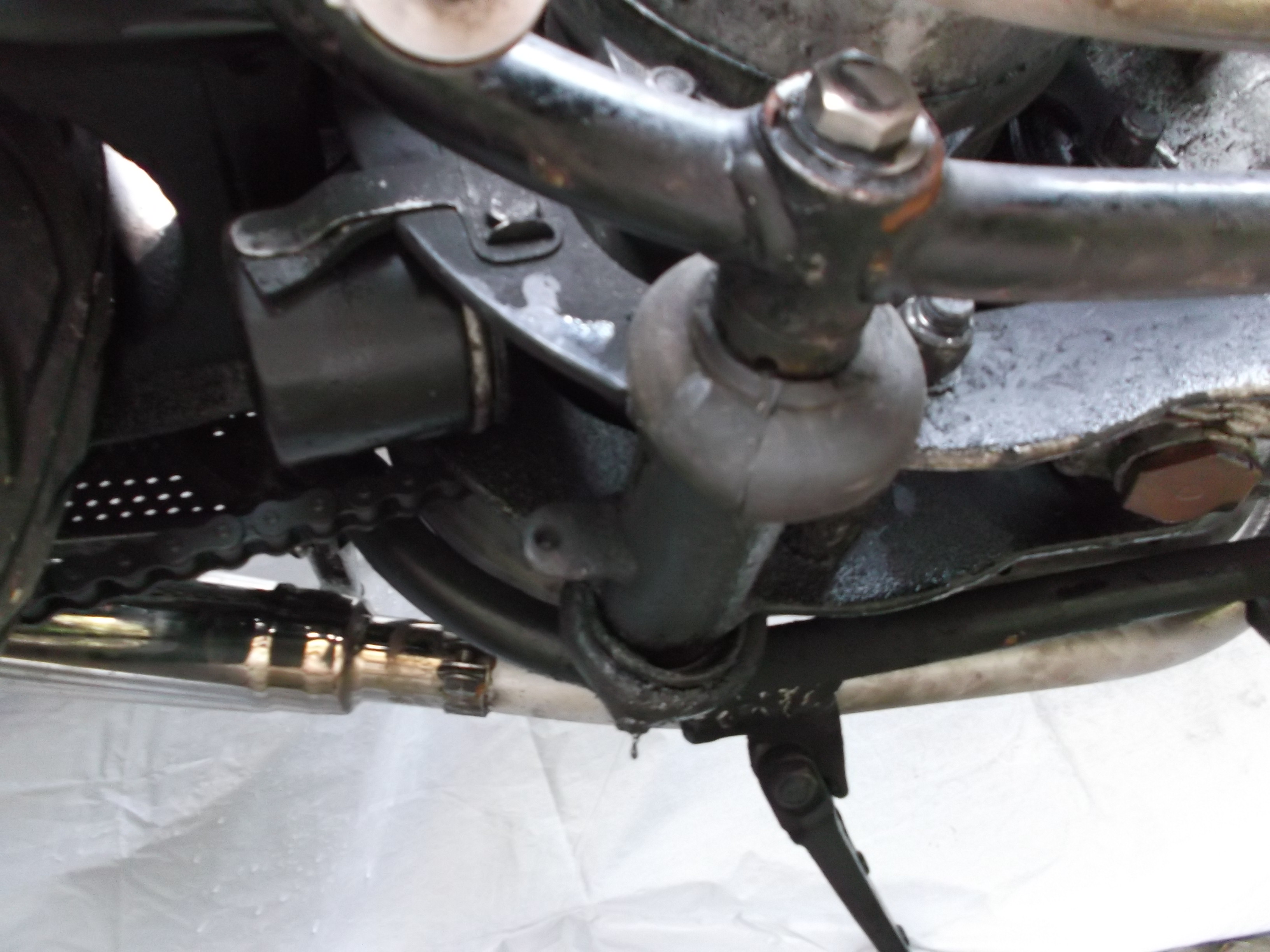

Hello Nick, Have you any p…
Hello Nick,
Have you any photographs of your swinging arm and gearbox modifications. My 1968 frame has been heavily modified at the steering head end to stop the two down tubes breaking and remove the need to add the horizontal tube but I have not touched the swinging arm apart from new isolastics. Thanks. Harry

yes the early ones do flex i clamped my gearbox cradle in a vice with the swingarm attached and passed a bar through the wheel spindle slots i was alarmed at how easy it was to flex so i gusseted the swing arm at its pivot point as a late commando i also made some sheet metal pressings top and bottom the full length of the arm when i was done i could hang my weight off the bar without the swingarm flexing i also did the cotterpin conversion and added an extra isolastic under the gearbox i do get a bit carried away sometimes but its the best handling commando i have ever ridden regards nick
ok hope they come out Atta…
rsz_dscf4671-jpg
Thank you Nick for your tr…
Thank you Nick for your trouble, they are good.
Harry

Thanks all for the info. B…
Thanks all for the info. Big thanks to Nick for the pics. Do you remember what thickness steel you used? Will be adding some gussets ot the swingarm similar to later models. I have modified the frame to have the extra tube under the main backbone after finding cracks in the top of the down tubes. Also have vernier isolastic a and I'm planning to fit a better headsteady.
