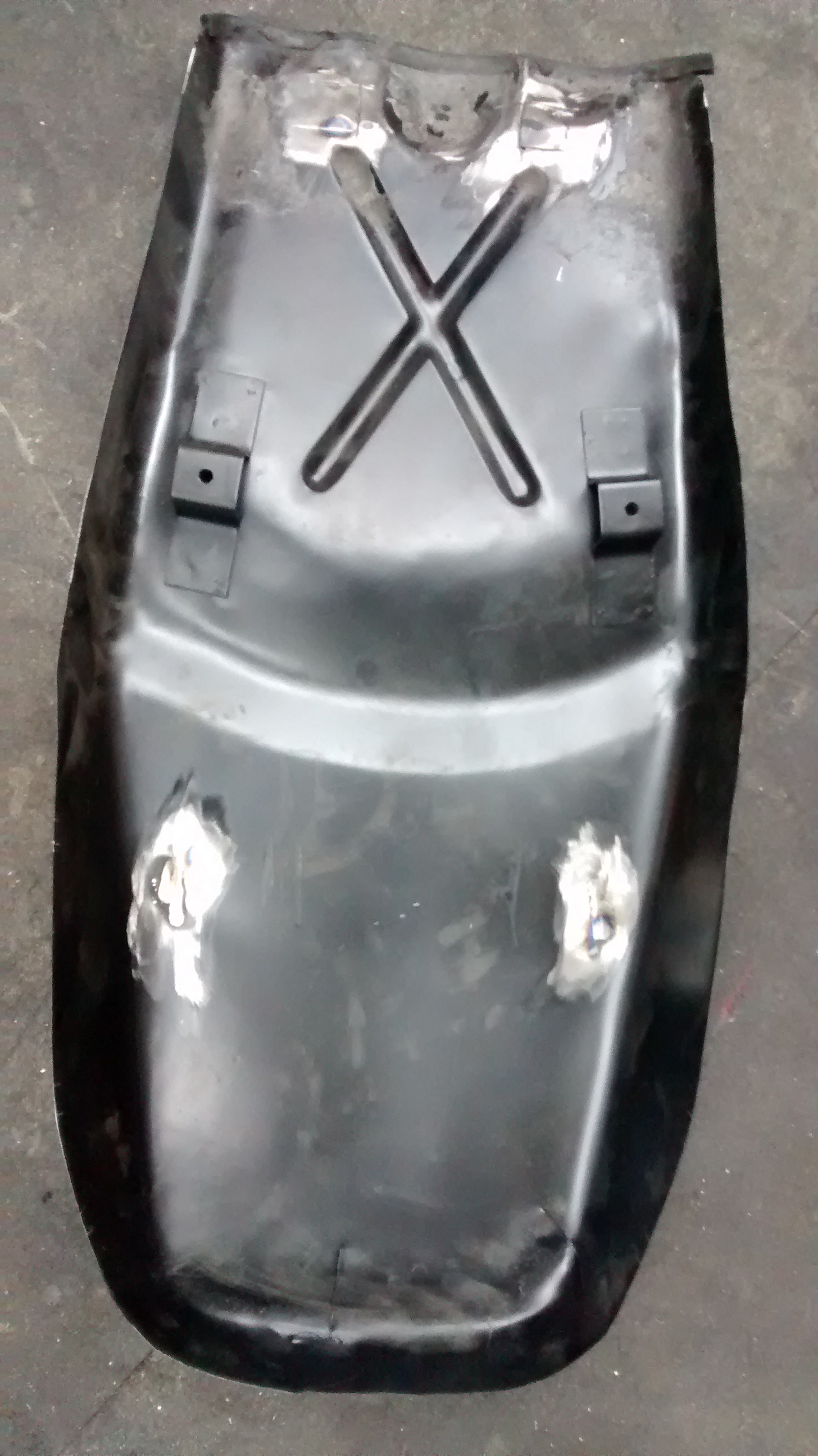

Ok so you're going to have a bit more trouble finding a seat. I have a base that has been adapted from a deluxe to a standard but it's not an original base. It might be worth emailing Andy S he might have some pictures.
dan
Hi Barry,
I have a 1961 De Luxe Navigator and I should be able to take some pictures of the seat tomorrow if this would be of any help in identifying the seat for you. The bike's tucked away in my other garage at the moment so a bit awkward to get out. The seat base is an original but it was recovered a long time ago by it's previous owner. This should be the same as your Jubilee - from memory there is one dzus fastener at the rear of the seat fixing on to the rear enclosure and there two pegs on the base of the seat locating into two brackets welded on to the frame suspension tops. The welded on brackets on the frame are the clue which seat fits. The earlier seat didn't have a dzus fastener and had terry clips holding the seat down - same as the De Luxe Dominator. I don't know when they changed ; probably about the time the Navigator was introduced.

p1080004-jpg
