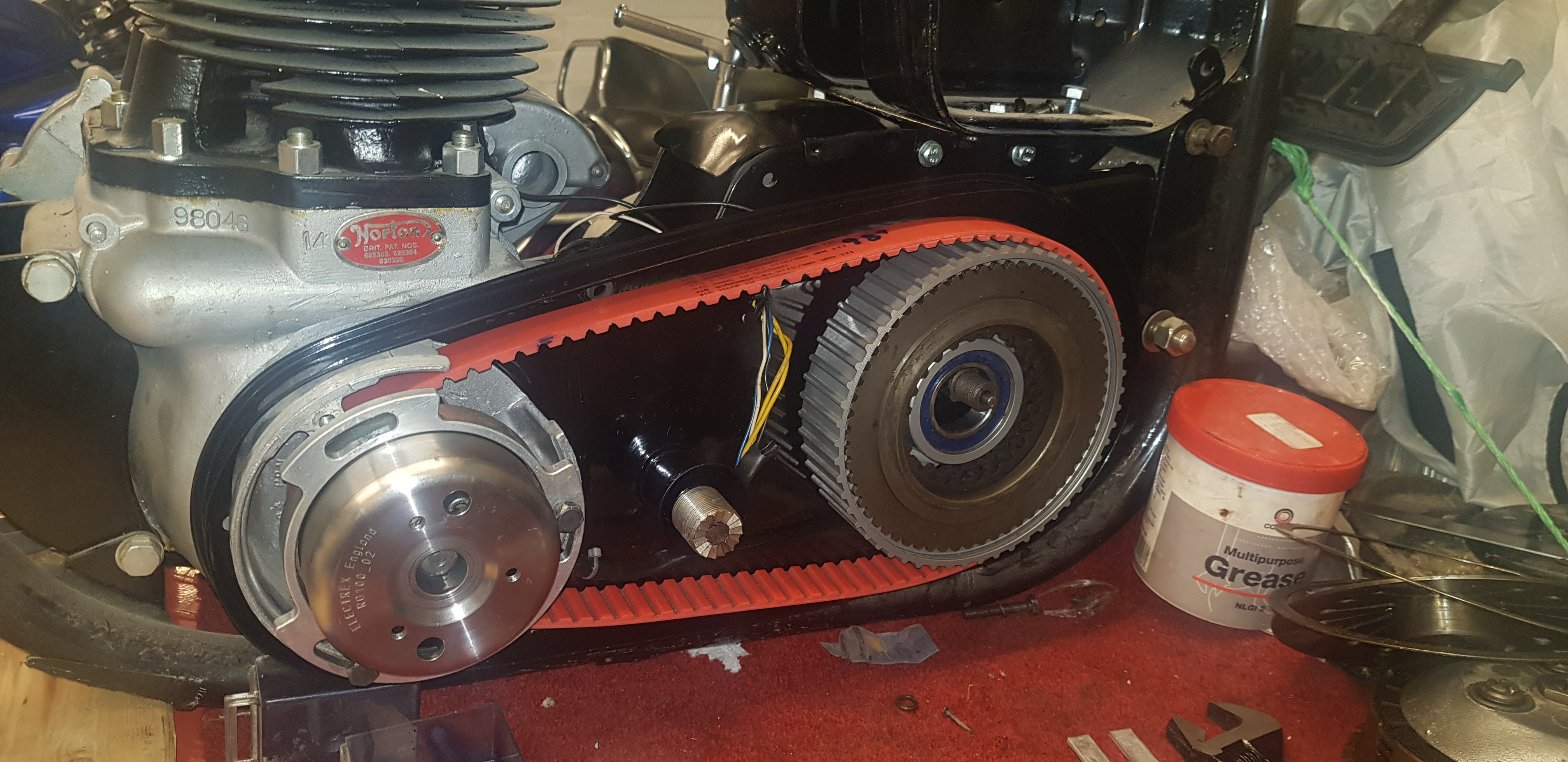

I like the Electrex system which is completely modern tech and lets you leave a dummy mag or distributor in place.
The sparks are independent of the 65W alternator.
Very easy to fit with an alternator, not easy with a belt.

So you had that mag changed as a we bairn, as per your picture above!!
