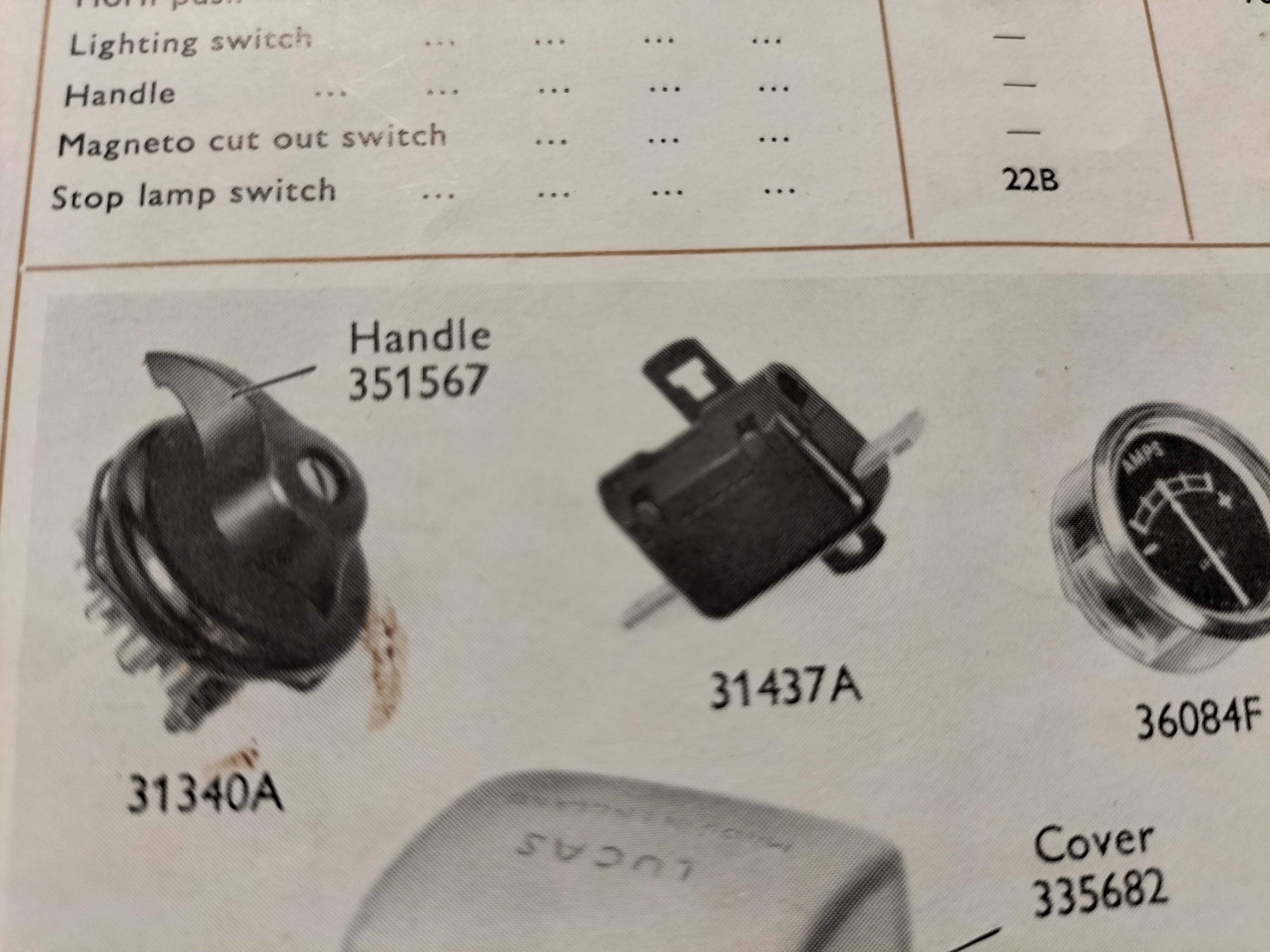

I was checking the light switch on my bike, suspect is not the right one.
May I ask someone help me to understand the right one (NOC spare part code or Lucas' one).
A picture also helps.

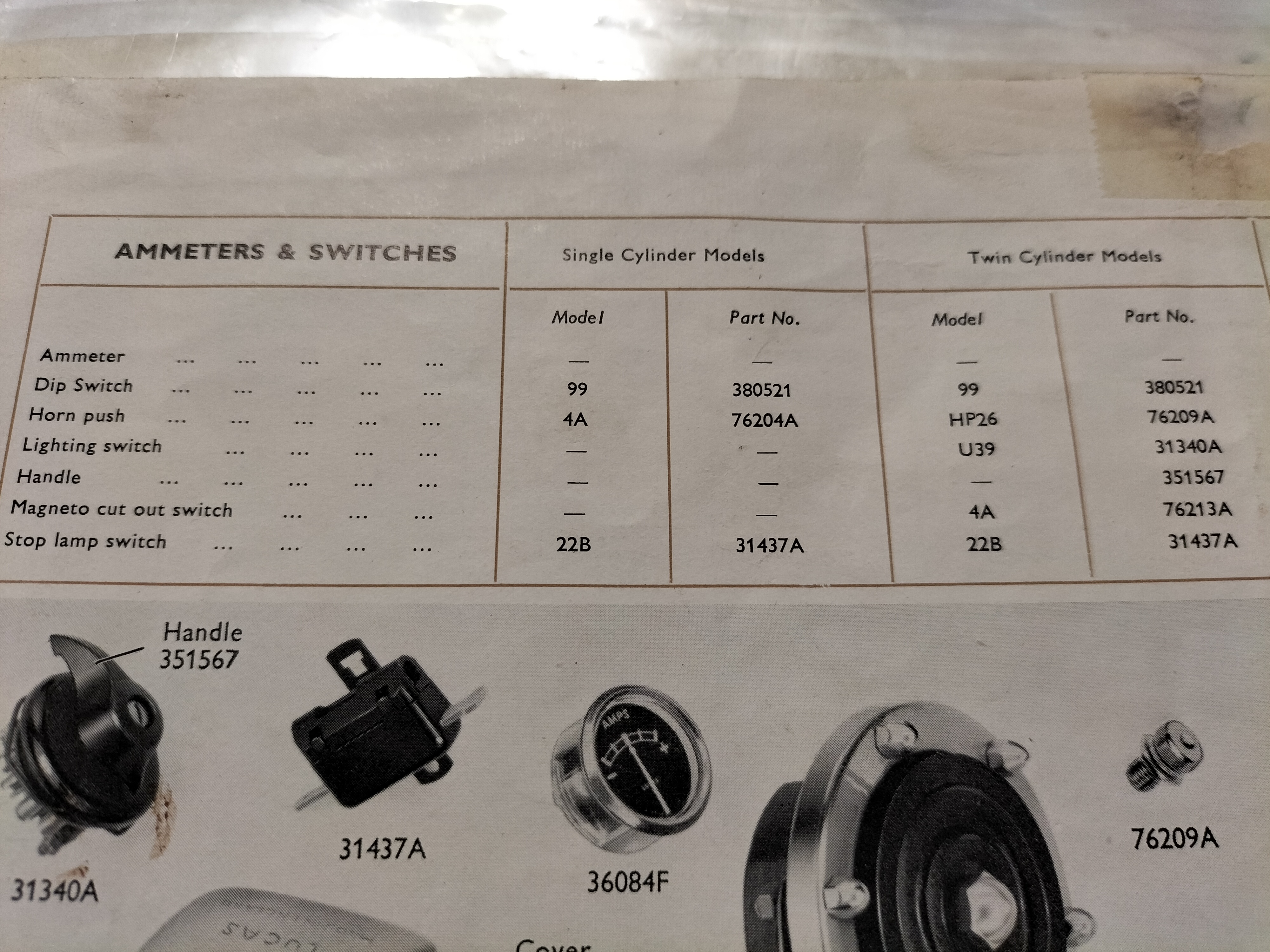

Switch operation.
Yes, correct.
The correct switch is Lucas Part Number 31340A as shown in the photos from the Lucas parts book. The model is called U39. These are easily purchased on line.
