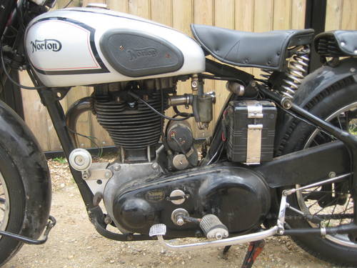

I had this problem. I have attached a photo I found but that's no guarantee that its correct for the year! If your left side rear engine plate has two holes analogous to the two lower oil tank mounting holes then you need a battery mounting bracket which secures to those holes at the bottom. I THINK thats the type shown in the photo. Any use?
Thanks for the photo Adam, but my bike has the upright gearbox, and therefore it needs the bracket that goes over the top of the box. I managed to find one at the weekend at Shepton, and it holds a T shaped battery. Any idea what type of rear light would have been fitted in 1948? Pictures I have seen have different ones even though they say it is a '48.
