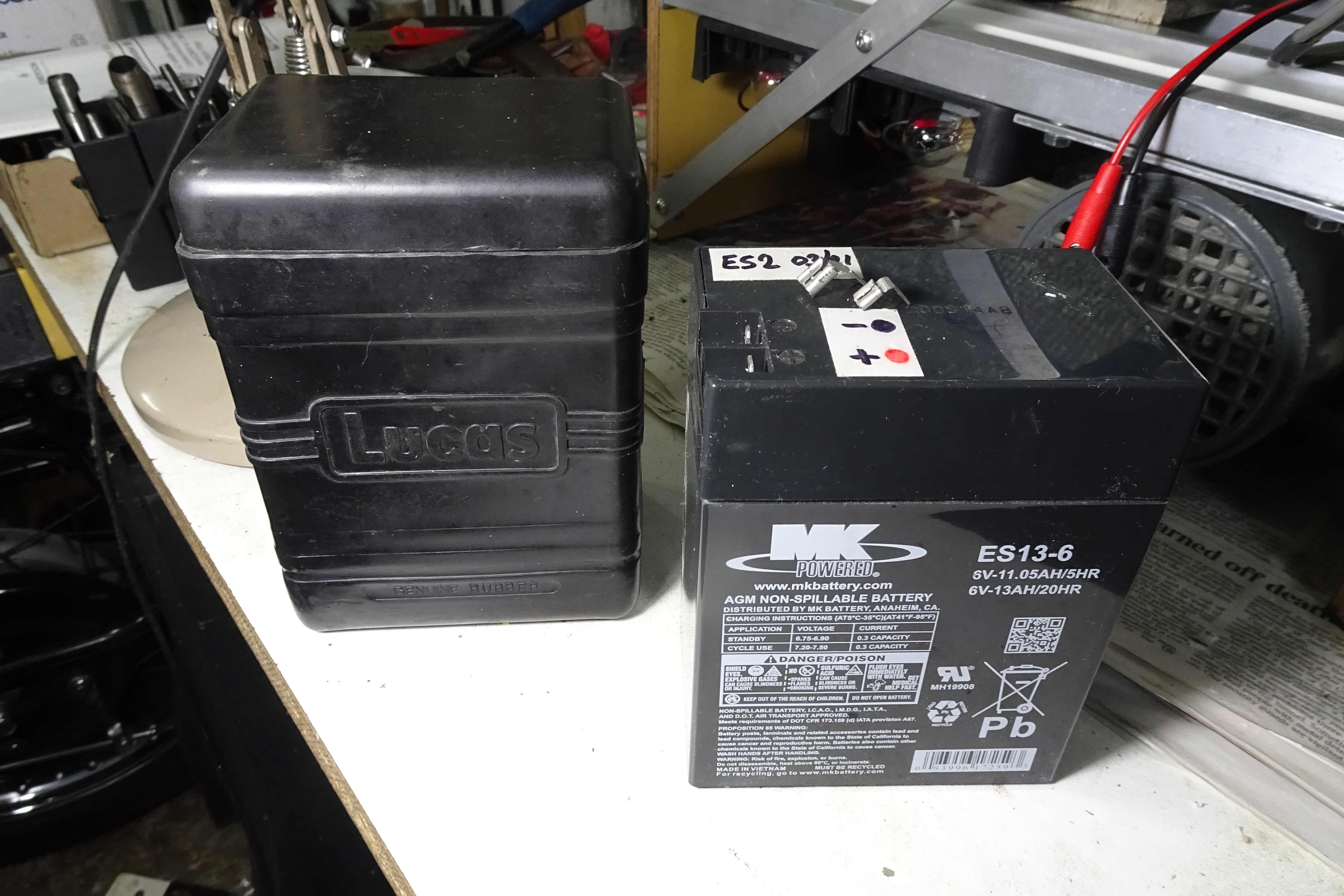

For my last 2 battery replacements I have used Westco ES13-6. These are AGM with a good AmpHour rating and are a snug fit inside the larger of the 2 replica rubber battery cases available from Lucas. Connection is by vertical spade terminals, 2 sizes 6.25mm (+) and 5mm (-). To run the cables under the cover the connections have to be turned 90 degrees. I achieved this by modifying piggyback crimp terminals. Westco batteries are available from Tayna (and others).
