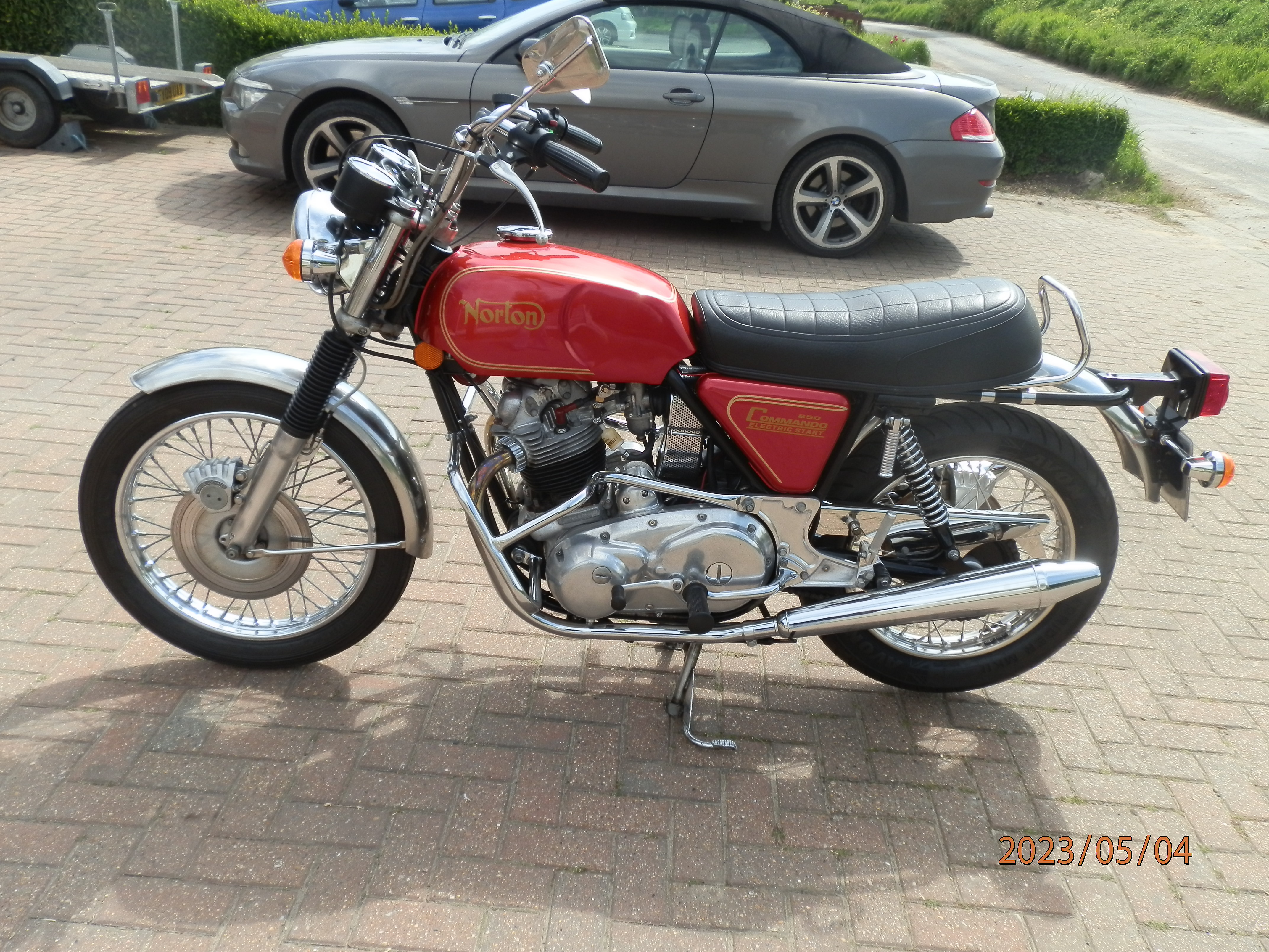

Hi again everyone back again with yet another problem, I took it out today to blow the cobwebs off and out of it and found I have a problem with my indicators and have a feeling it is a bad earth problem, when I use them left or right the indicator warning light glows and the ignition light comes on, this is the first bike I have ever had with them so as you can probably imagine they are not overworked but also I have not got a clue where to start looking so any and all advice gratefully received thanks Chris

Yes, definitely a bad earth…
Yes, definitely a bad earth. Using the frame as an earth is always fraught with problems. If you can, run extra earth wires from somewhere where you are sure you have a good earth, even going right back to the battery. And then onto the indicators metalwork inside the unit itself.

If you think about it, you're trying to make an electrical earth connection between the forks and the frame- ie through the headstock bearings, which should be suitably greased and therefore isolating the forks!.A short earth wire from inside the headlamp shell to a nearby point on the frame would be a good start.

What you are trying to do is create a low resistance path from the bulb back to earth. Using various bits of old and possibly rusty metal to do the job is never going to be optimum.
If you can run a wire from the metalwork of each bulb holder back into the headlamp shell and then one from the headlamp shell back to either a good clean connection on the frame itself or back to the battery. The you have a fighting chance.
You can do similar at the rear, the wires just need to go from the bulb holder metalwork back to something solid or the battery.
You could of course do one at a time until the problem goes away (for now anyway).
All good now thanks everyone…
All good now thanks everyone fresh earth wire from rear bulb holder did the trick
