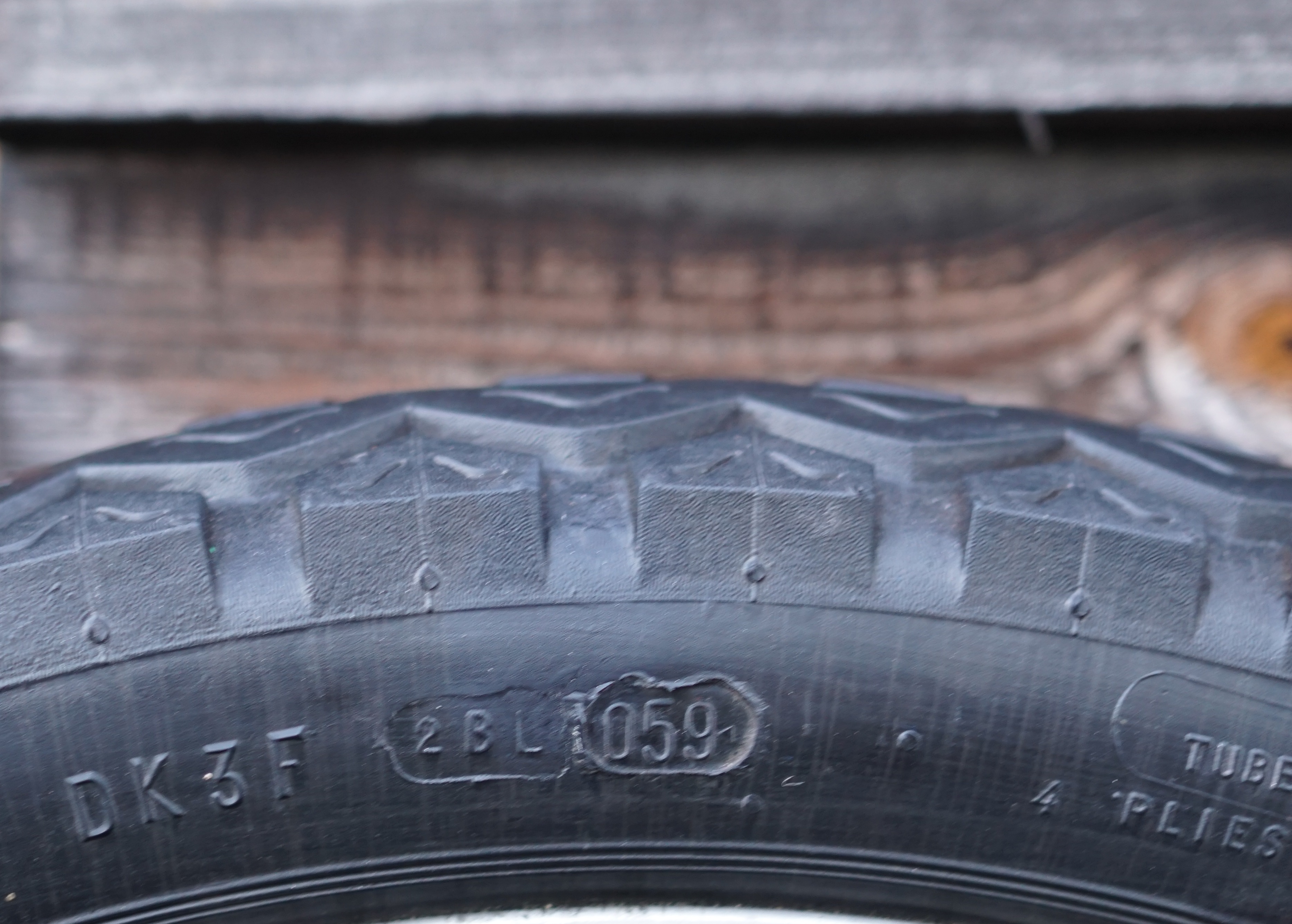

Motorcycle and car tyres have a date code moulded in the sidewall. Used to be a three digit code until 1999. The 059 code on the French  4.10-19 TT100 rear fitted to my bike when I bought it in 2001 tells you it was made in the fifth week of 1999. See image below. No idea of sixties codes if any
This was changed in 2000 to a four digit code so a tyre made today would have the code 4320 or the 43rd week of 2020. My current Conti radials are 2418. You can download calendars with the week numbers included to make it easy to check
Biggest age problem is cracking or hardening although not necessarily both together (Bert Munro excepted) The French TT100 mentioned above has no visible cracks but definitely fails on hardness. You could break rocks on it, no fingernail test needed
Thanks Neill, thats really interesting. I've not come across that before, and have filed this info for future reference!
