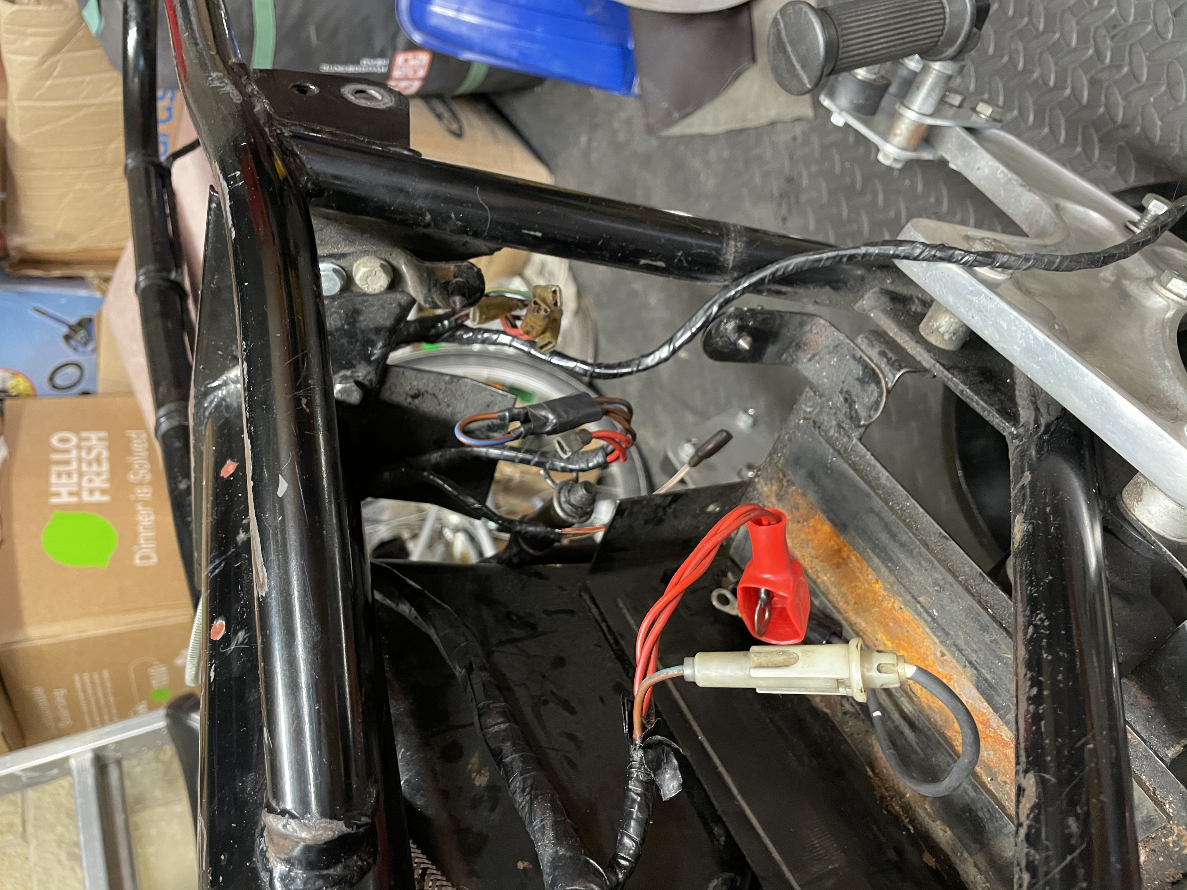

I am fitting a tri spark mosfet regulator/rectifier to my 1972 750 commando ,any one got experience of them ?
The wiring instructions look simple .
After removing the zener diode , rectifier and the capacitor there seems to be a lot of redundant wiring .I started to remove the surplus wires but it gets very difficult as they feed into the harness .
I didnt want to leave them but would it do any harm just to tape them off and leave them in situ ?

Thanks for the advice Grant …
Thanks for the advice Grant .
I had been studying your information on the web ! Yes when I disconnected the existing wiring some items would not work but when I reconnected the earth everything was fine . I had hoped to simplify some wiring as when I fitted the Tri spark ignition but it isnt a problem .
I fitted a separate fuse and hopefully all seems to be working fine .
Thanks Roy
I always...
... run dedicated earth wires on any bike as connections via frame / engine can be decidedly iffy.
yeah Ian thanks for the tip …
yeah Ian thanks for the tip , I should have known better after being caught out before !
I will learn one day .
cheers Roy

…when you are removing redundant wiring from the bike.
With the reds in particular, on many components it will loop in and back out again as it goes off back in to the harness.
It is important that you retain this loop, so just tape the wires up, rather than cut them off.
Norton and Lucas quite rightly feared that the isolastics could hinder the positive feed which on many bikes is via the frame.
Not the case with the Commando - with the exception of the rear taillight and turn signals (which are earthed through the bracket) everything else has it’s own positive feed from a cable.
The reg/rec is simple to wire in, and no different to all the other reg/recs available.
Consider putting it on it’s own fuse.
That way, if you have any issues with the charging system, you can pull the fuse and get home on the battery.
