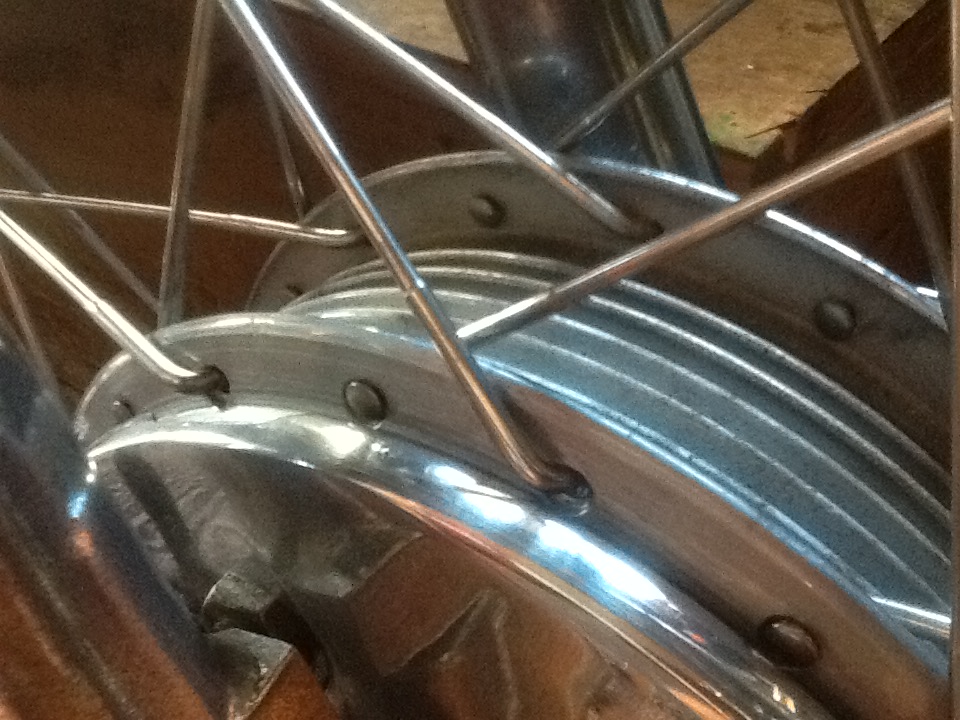

I have asked this question before but never had a definitive answer. Is there a TLS brake that will fit directly onto a 56 Dommie 99 hub? We have already been down the Atlas/Commando route and the diversity of comments have done nothing to inspire me to lash out big bucks on what could well turn out to be a pig in a poke. My existing standard brake plate has a return rim that sits over the hub to form a seal and the hub itself is full width with ribs, however I cannot be 100% certain that it is the original hub, I do know that it is the same hub that was on the bike in 1959.
Apologies for labouring this point but I would so like to resolve this issue and move on. Many thanks. Ron.

It looks very much like you have the two piece (but full width) hub. 1/2 ally 1/2 steel correct for 1956. Yes the brake plate does not interchange with the later full ally width front hub-nuisance.
One way out is to change the front wheel for later one that does take the twin leading front brake.
