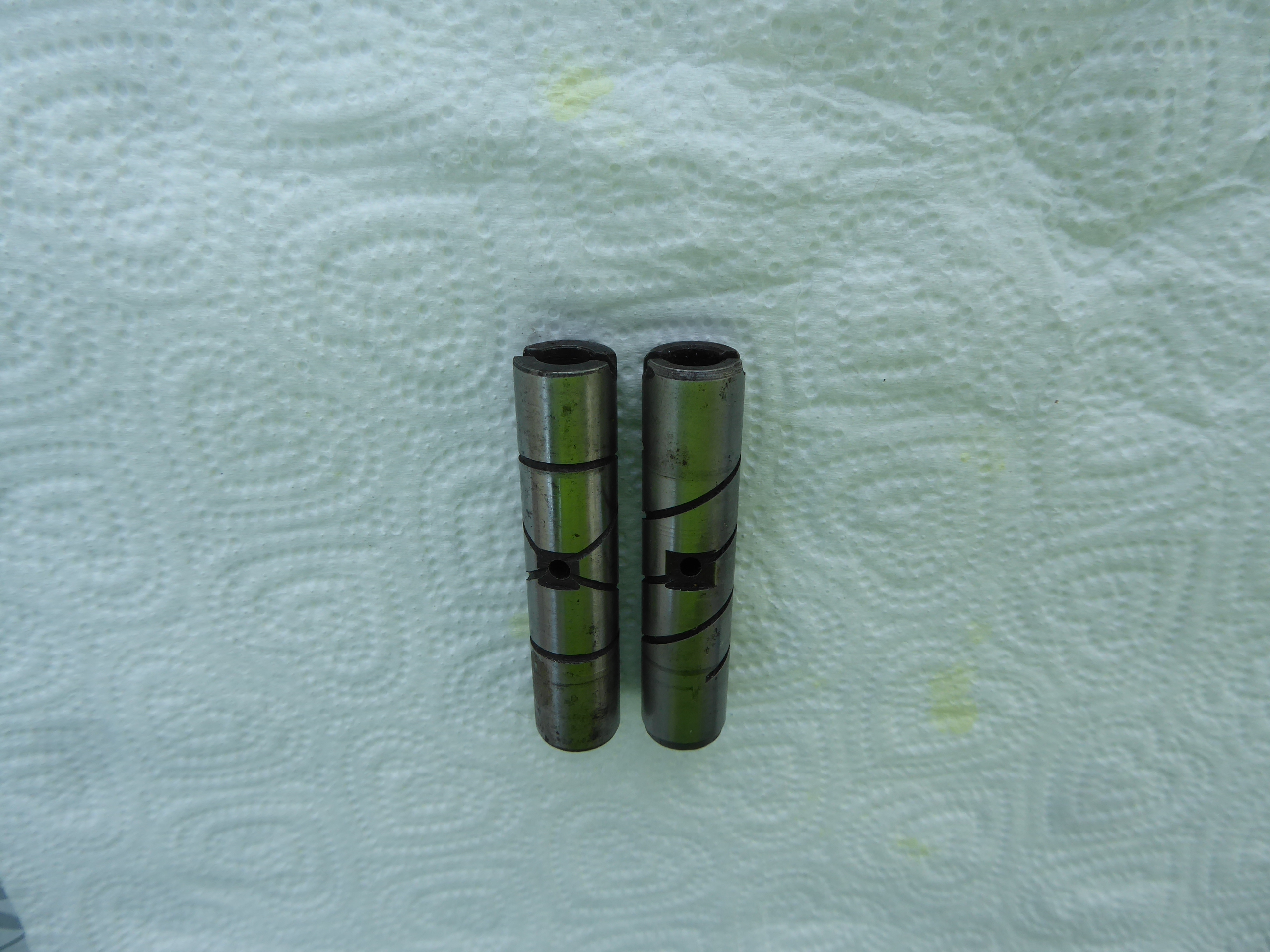

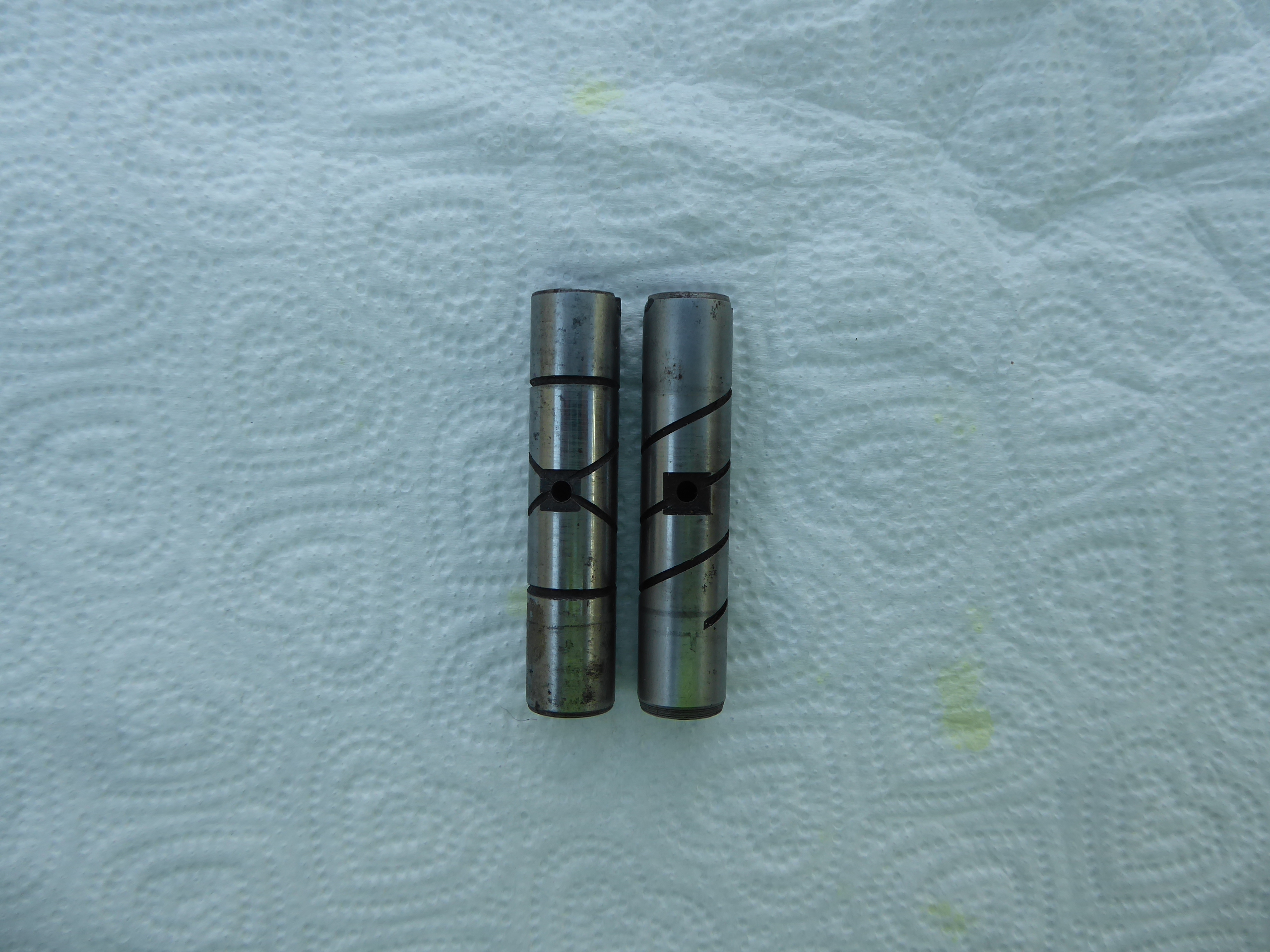

Intermediate Gear Spindle.
I would not advise using the cover screws to pull this in to get a better seal. The thicker Commando cover gasket ( 25 thou versus 8 ) would help but there appears to be another issue worth looking for.
There were several versions of the Intermediate Gear Spindle for the Norton Twins. Some had a single scroll others a double. I once rebuilt an engine with a timing cover which also would not sit flush. It turned out to be the gear spindle was too long. It was missing the chamfer needed at the slotted end and hence not sitting far enough inside the cover recess.
The attached photos show the naughty spindle next to a good one. Checkout the ends.
