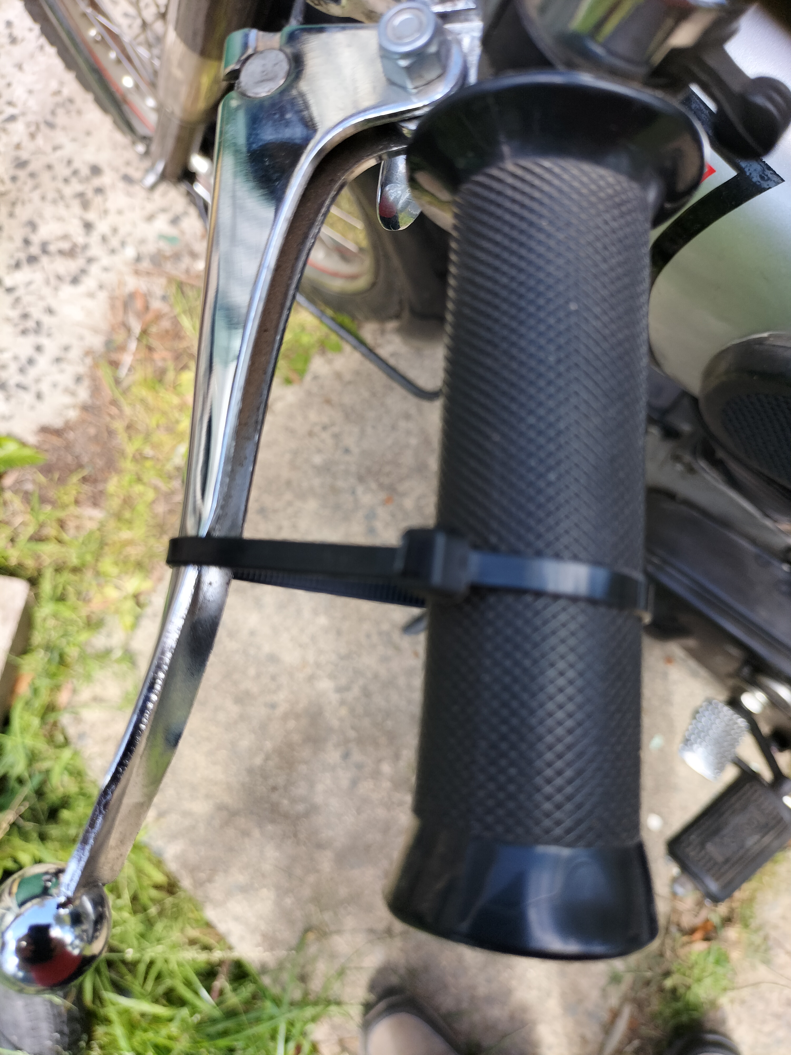

I put the bike on its center stand ,engage 4 th gear ,hold clutch fully in with cable tie and rock the rear wheel back and forth, alternatively just rock bike back and forth against engine . Works with 3 ton trucks too. If brave start engine roll downhill ,knock into gear and ride off with clutch held in . A few cycles of load/unload will do it. Be prepared to stop and stall if necessary !!.

As I didn't want to disturb a non-leaking primary chaincase, I simply break the bond with a cable tie just separating the clutch plates when the bike is not in use. While riding, the cable tie just clips over the horn/dipper switch assembly out of the way.

Thanks David, Robert and Ian. It's a tricky one - I like ATF (although now it's Castrol QTF in my primary as I couldn't find ATF locally) because I've never had any clutch slip when using it, whereas I did when using 20-50 oil. However, if the ATF (QTF) is going to affect the plates, then maybe I need to reconsider. I've never been confident to have the clutch lever tied against the handlebar for long periods as it puts the cable's inner wire under continuous tension - not sure if that reduces the life of the cable or not. I haven't tried putting the bike into gear and rocking it backwards and forwards - I'll give that a try. Maybe I just need to bite the bullet and open up the primary so I can clean the plates - not a job I'm looking forward to, especially as my primary is virtually leak free (at the moment).

Constant tension doesn't…
Constant tension doesn't harm steel cables, so shouldn't harm brake wires. Fatigue (changes in tension and bending) causes the damage.
The clutch lift is small compared to the clutch spring permanent compression so I don't see that making any difference either.

Sounds like I was being a bit over-cautious regarding holding back the handlebar clutch lever with a cable tie. I'll give that a go.
