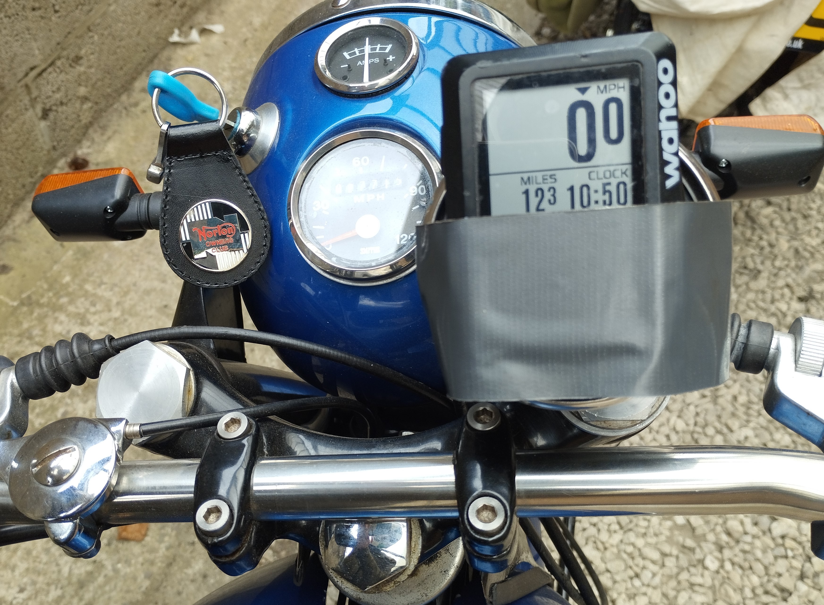

Continuing to put the miles on my rebuilt Navigator engine, 650+ now.   Thought I would check the accuracy of the speedo against my cycling GPS device.
I taped the devise on to the rev-counter and went for a ride.
Speedo reasonably accurate up to 50mph, about the width of the needle optimistic.   Not so good at 60mph, speedo showing ~55mph.  Odometer spot on.
All this assume the GPS device is accurate, compared with other GPS's no reason to doubt it.  Interestingly, the transient response of the device is sluggish, not too much of a problem on a bicycle, it struggled to keep up with bikes speed!
Speedos are supposed to be optimistic so as not to encourage riders to speed! - well thats what they are supposed to do now, not so sure about then!

Richard C, to be clear the GPS device is not what was traditionally called a "bicycle computer".  Its a stand alone device independent of tyre size.  That is to say it takes information from satellites like a sat nav.  This, I think accounts for the relatively sluggish response while the device processes the data.

The reason for the check is the speedo gearbox, my Navigator has a 2:1 when it should be 19:10 hence the reason for the check.  My licence is safe!
