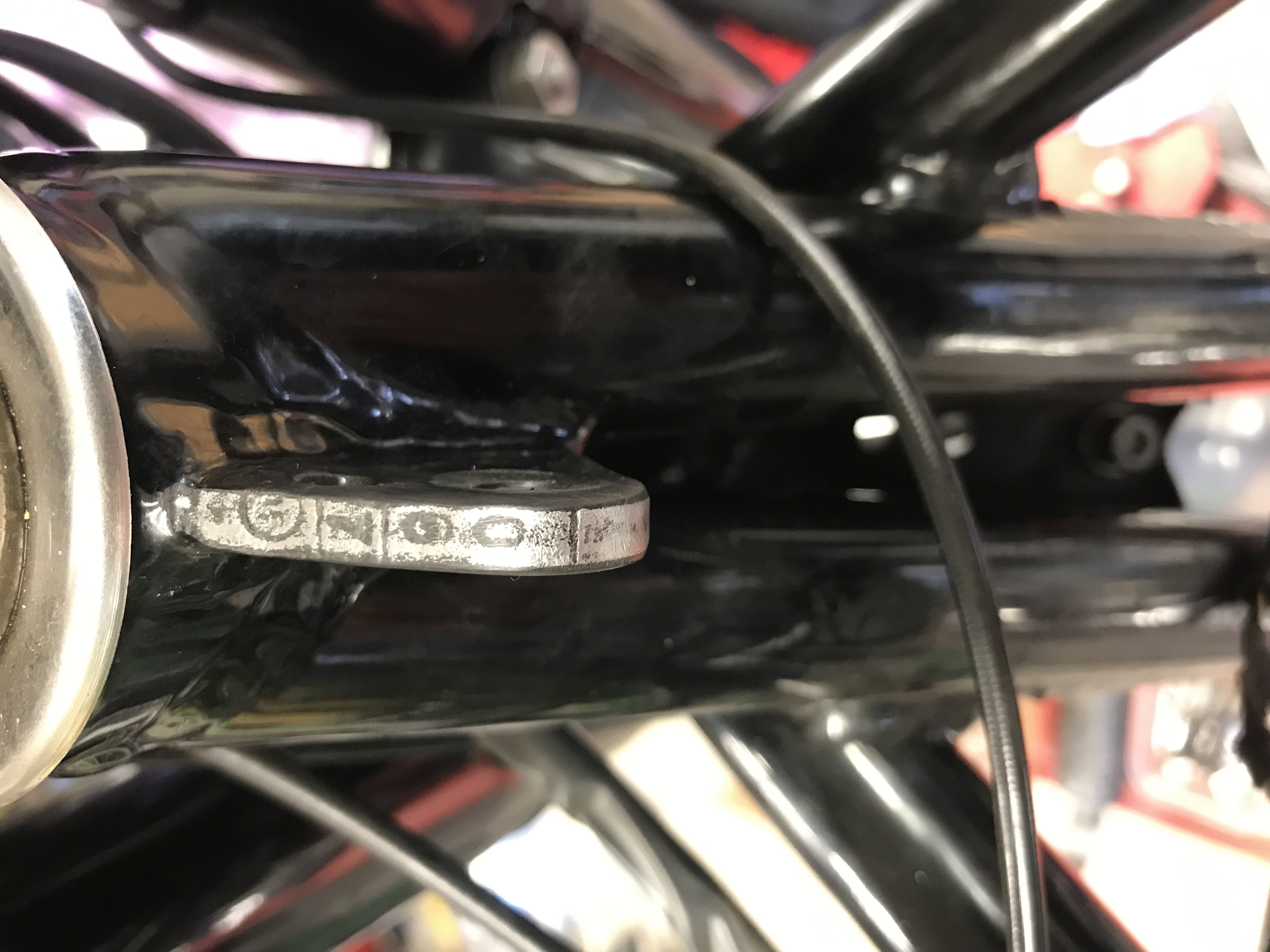

I’m doing some research on my 1967 650SS. I have uncovered the Reynolds frame number near the headstock, I realize it’s a date stamp that Reynolds applied but unable to interpolate it’s meaning, please see attached picture. Any help would be appreciated

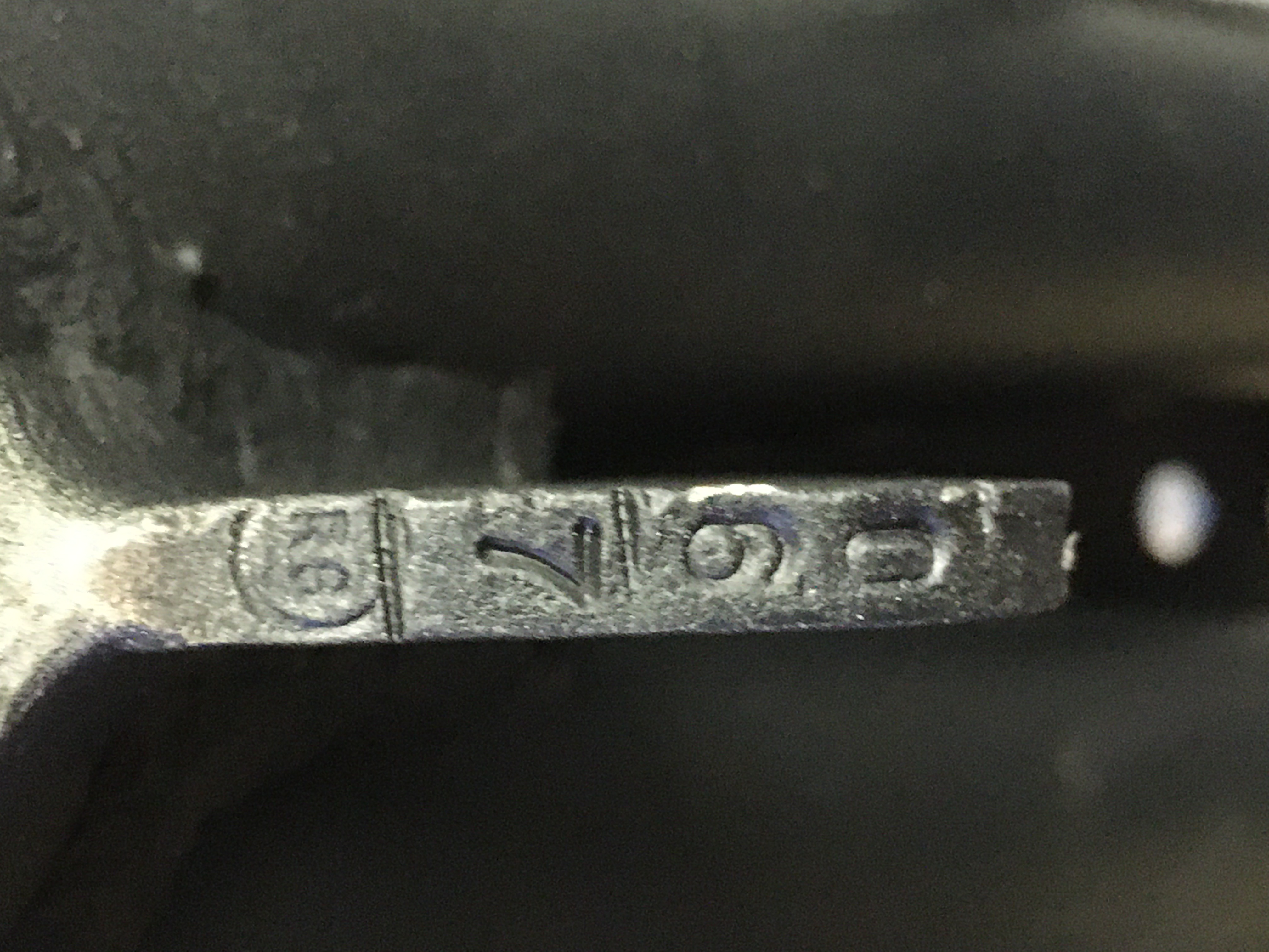

Hi. I have EXACTLY the same…
Hi. I have EXACTLY the same digits arranged the same way on my 1960 Dommie 99. I can’t guarantee that the frame is original but it seems a real coincidence that our frames, seemingly several years apart, have identical stamping. The frame number on my bike looks original, not ‘re-stamped’.

Reading it the other way up, you have 06, followed by a line, then a 7. From this, 06 = June, and the 7 is for 67? Thats how I see it anyway.

From my point of view, the ‘7’ is ‘July’ and ‘60’ is ‘1960’. That fits in perfectly for my 1960 Dommie 99. Or maybe it’s not a date code at all - it just seems too much of a coincidence that two bikes that are seven years apart in manufacturing date should have identical number stamps on the head steady lug - perhaps it’s some other sort of code that Renolds used - for example a tube type.

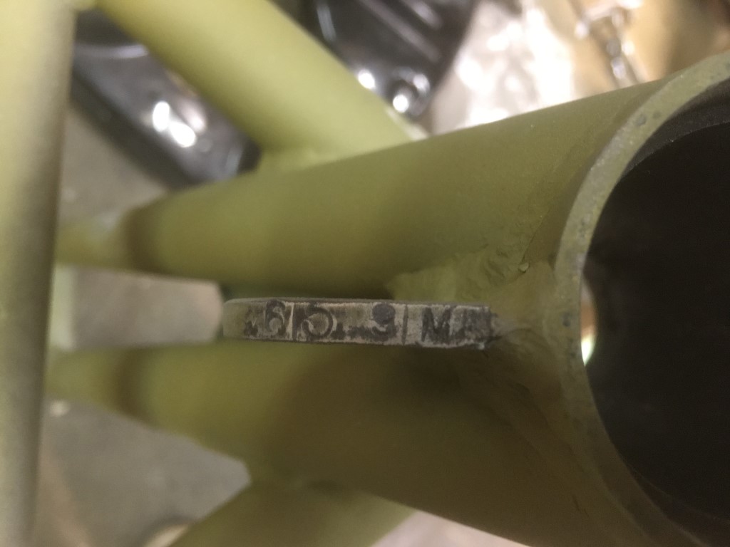

Standing on the right side of the bike looking down, they are all from left to right Month/ space/ year (2 digit) My 63 atlas is 5.. 63,
The 66 atlas I had to sand blast get a good clear view and reads 1..66..M the 6"s are sloppy but clear enough to make out.
The 68 atlas is 1..68 with a A upside down partially over the 8

I don't know the answer and seek it and there appears to be 3 different answers given. To address one, Tony my number reads /06/7/Renyolds stamp. It sounds like yours reads /60/7/Reynolds stamp standing on right side of bike reading from left to right in witch case they are different. Hope we can resolve this little puzzle.

My model year -68 650SS is stamped, looking from the right side, probably 5 and then 67. Sounds plausible as it was first registered in october -67.
The -59 99 is also read from the right side, probable 4 and then59.
The -59 Manx.is built in March -59 and hard to read. Guess it's 1 59. If read from right side.
Hi William. My number reads:…
<Renolds letters> - 7 - 60
(photo below) which to me reads ‘7-60’ - others may read it as ‘06 -7‘’. I guess it all depends on the direction in which it is read. I prefer to think that they’d use two numbers for the year as that seems to follow convention.

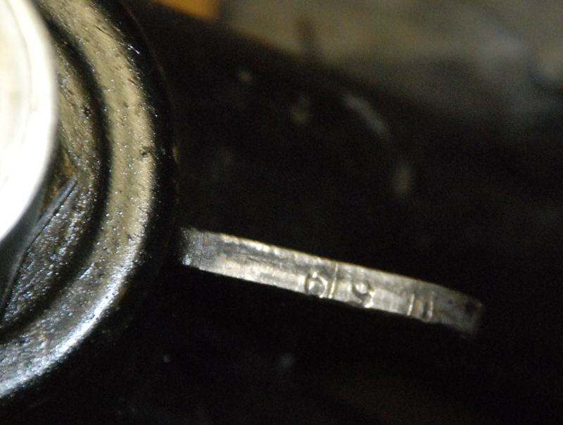

Here's mine from a 1959 99. …

It strikes me that Reynolds stamped this in various ways perhaps based on the individual doing the stamping. Sometimes using two numbers for the year and sometimes using 1. I think the following points are consistent.
-the number is always read from standing on the right side of the bike
-the number is always read from left to right
-any number with in the hash marks such as /57/ represents the year or month. In other words there is no carry over from month to year or vice versa if all numbers are with in the hash marks
Do you agree or other wise? Thank you for all your comments.

The frame was made in June 1967. Any other takers?
