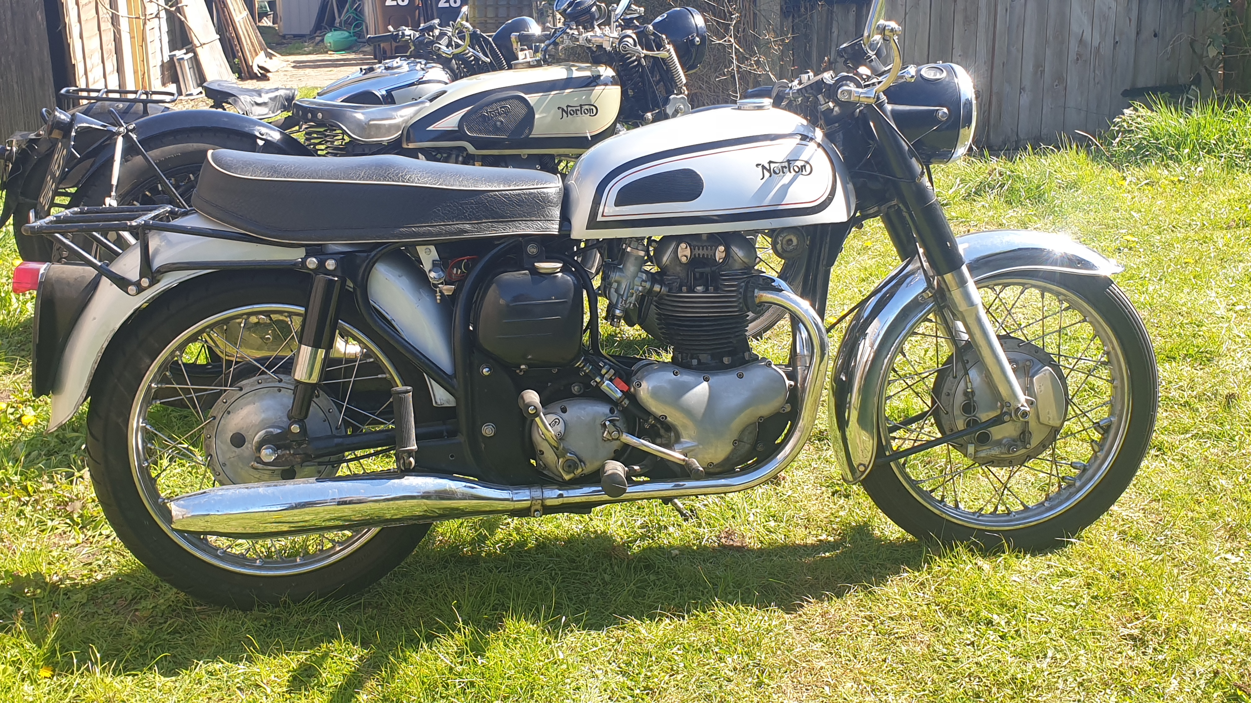

This is my 650 fitted with a Siamese system, sorry you can't see the cross over well, I took the picture last Sunday at a Show.
The bike is not fitted with an ss head but the Siamese fitted OK. (Bit tight getting it in but clearance all round.
