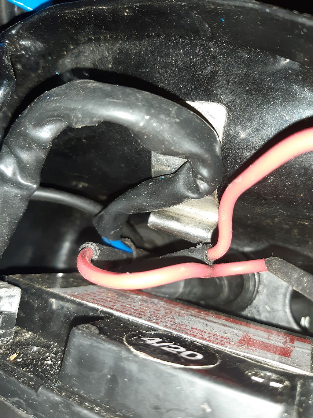

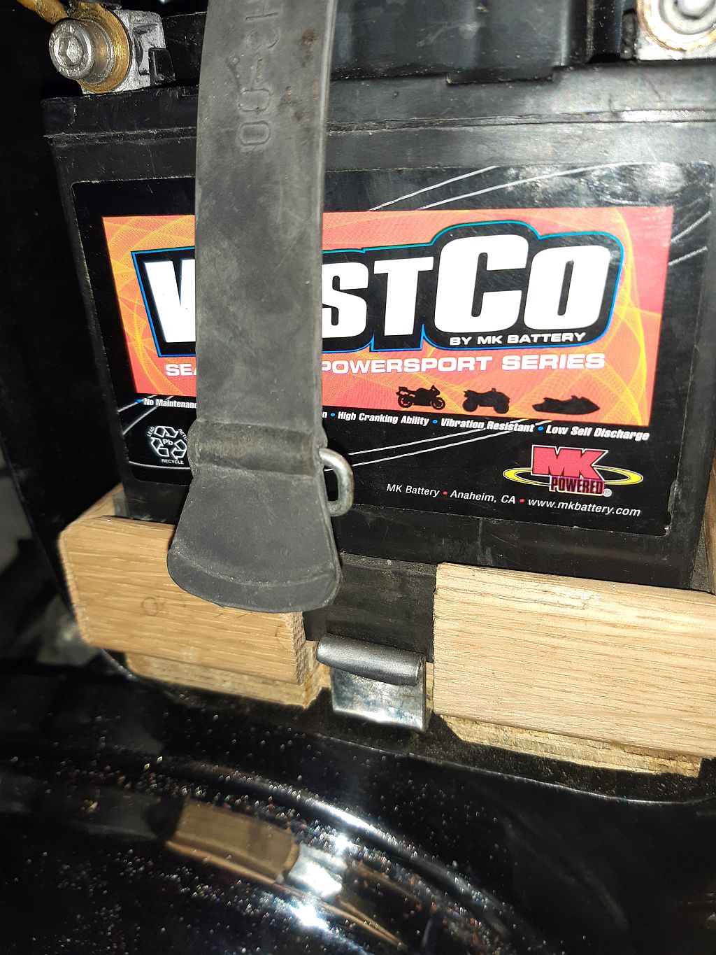

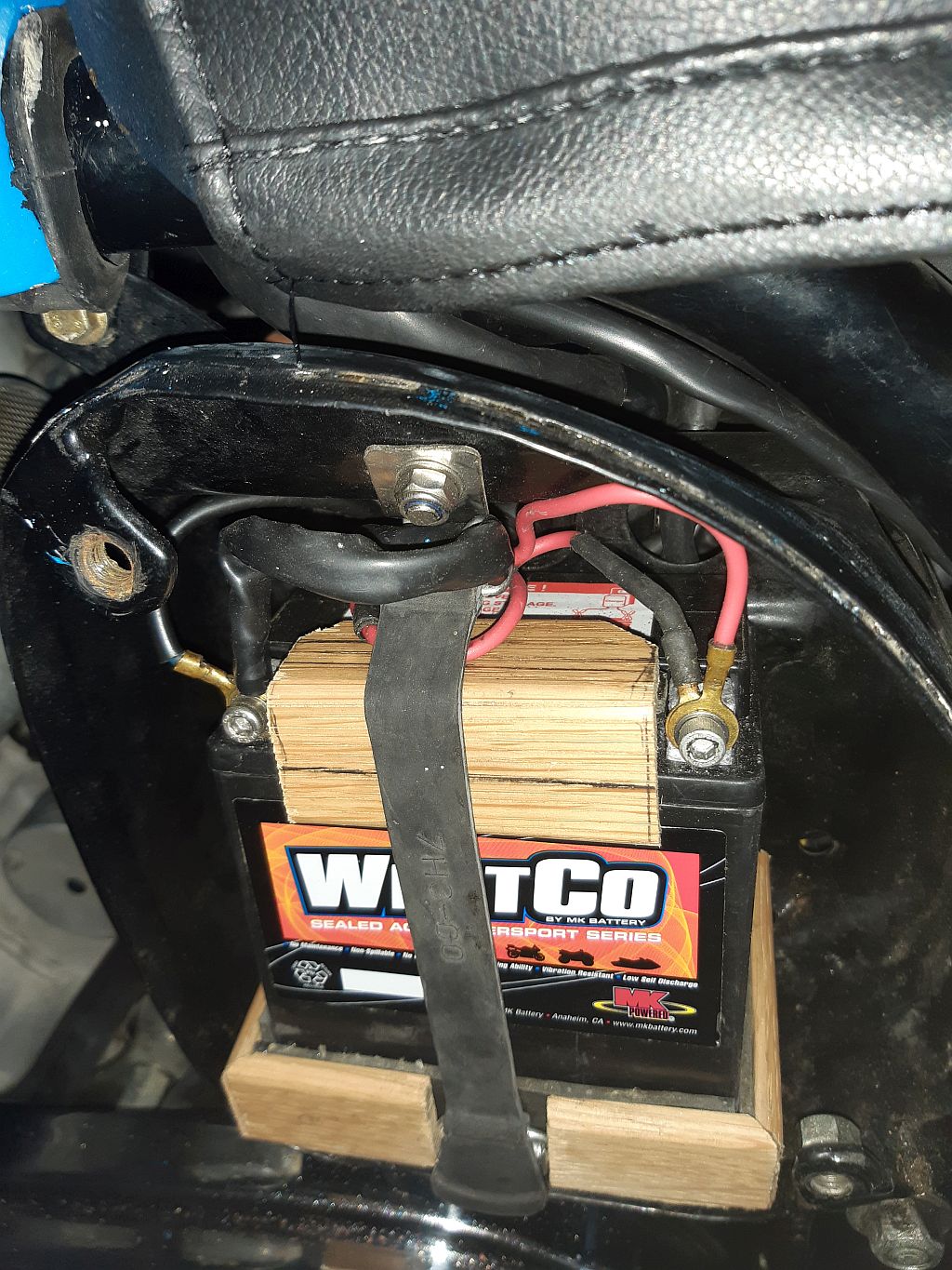

I faced a similar issue to you with my 650. I am using a 7AH AGM battery, and the issue I faced was that the standard angle iron and U-shaped rod battery retainer would have shorted out the battery terminals.
My solution was to make up a small wooden tray to hold the battery clear of the 2 battery box mounting bolts at the bottom of the box, and adding a pair of home made stainless 'hooks' for a generic battery strap to attach to.
Batt 1 shows it in place, while Batt 2 and 3 show  the hooks.
I personally don't care if it is nothing like original - I'm the only one who looks in there. What I do know is that it works well.
Don't be put off by Lionels comment re 'elastic', as virtually every bike built in the last 50 years has had the battery secured using flat rubber straps, but if he meant bungee cord, then I would agree as the round profile will eat into the battery case.

.. George - a lick of paint and that wood will look as if it was put in at Bracebridge Street....

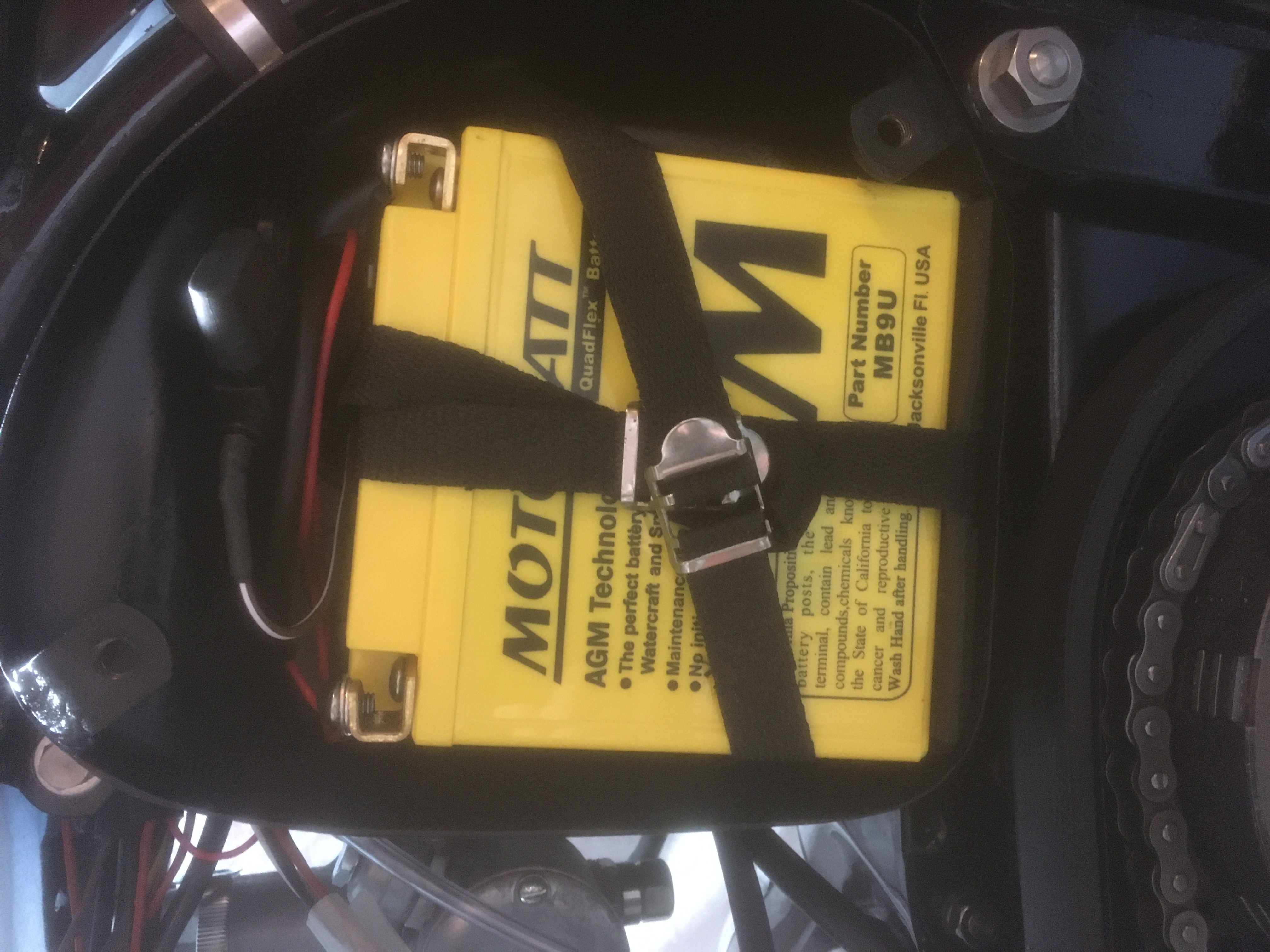

Hi. Thanks to everyone for the ideas and advice. I didn’t want to drill any extra holes in the battery box so I n the end I’ve settled on two straps (photo below). The straps are from a camping shop and are used to hold one of those closed cell foam sleeping bag mats rolled up tightly.
One strap goes underneath a homemade battery platform (fixed by the two bolts in the bottom of the battery box) and holds the battery down onto the platform. The other one goes diagonally across the battery and pulls it against the back wall of the box. The battery is now absolutely fixed - no movement at all.

Whilst I can see that you have an AGM type battery, I can't make out any anti vibration mat for it?
I too have an AGM one, but it sits on 1/8" rubber sheet, with more between the battery and back of the box to shield it a bit from the vibes of a 650.
Maybe you are confident that AGM batteries are ok with vibration? I wasn't too sure hence the rubber.

Hi George. I’ve got a 2.5mm rubber mat  under the battery but take your point about adding some padding behind the battery. I don’t want to risk damaging the battery case or internal structure - I’m not sure how resilient AGM batteries are either.
