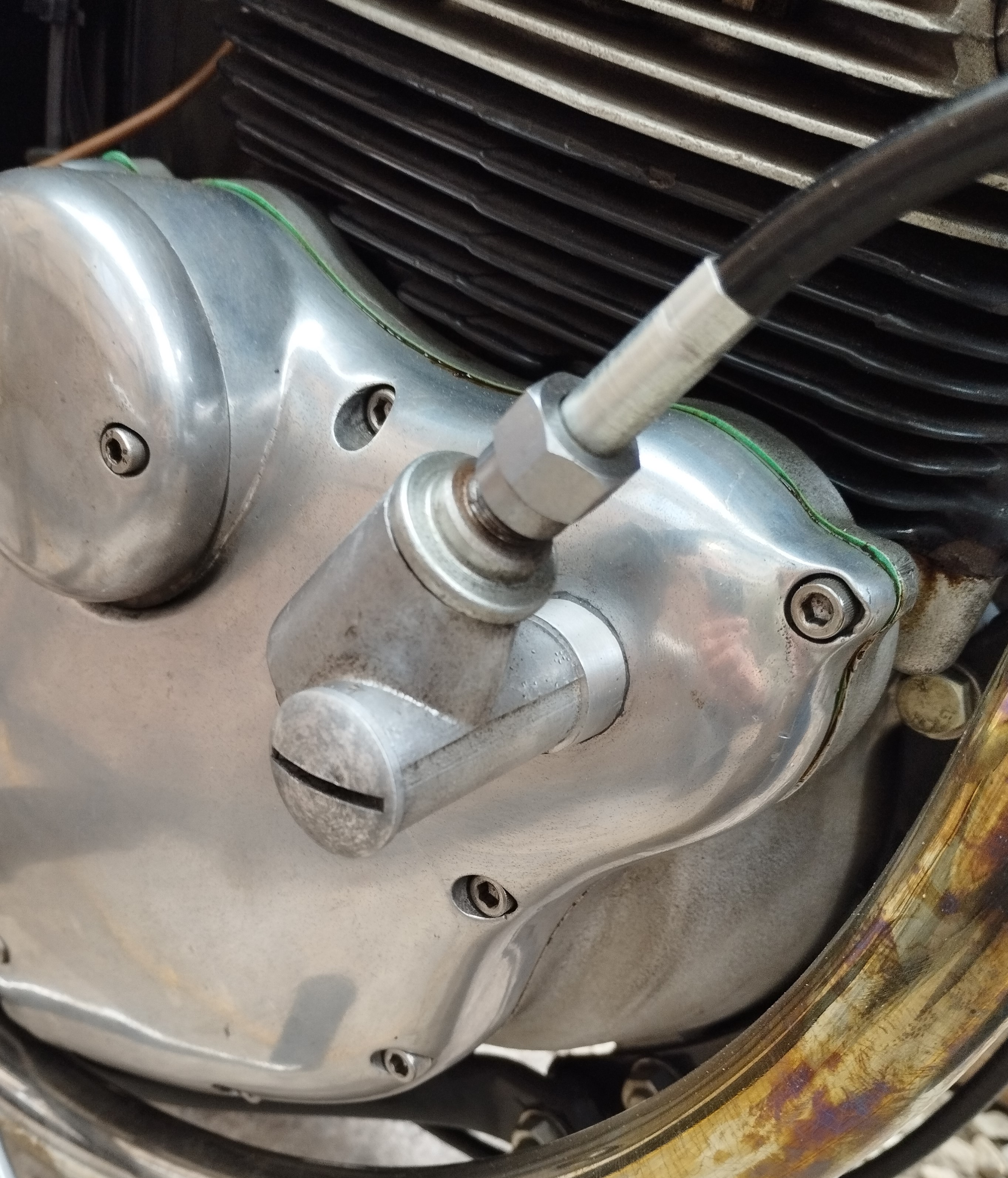

Have you thought about using a Triumph gearbox, they are 2:1. I've used them on several bikes. Cheap if you shop around but might need some work, they are fixed in place by a left-hand thread on the Triumph, needs to be right-hand if fitted to the timing cover.
Using one on my Navigator, see photo.
I'm also using a 4:1 ACW (I think) Indian rev-counter head, what a load of rubbish. Accurate at 30 - 40 mph in top gear, miles out everywhere else. Not really surprised at less than £20! The cable is Triumph T140.
Tacho drive
Thanks John. I have already bought an Indian revcounter. I shall discover how useless it is when I get a drive box! My Dommie timing case requires a tacho drive that fits with two small screws so I don't think the type you have fitted to your navigator will work.
