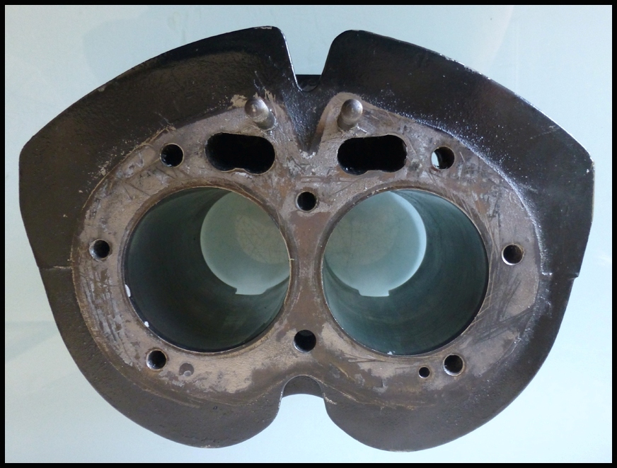

The barrel rear drain hole is too small for the job it is asked to do. Until the oil gets hot it will not drain down this hole. Plus while it is trying to defy gravity, the engine crankcase pressure is pushing it back upwards.  Consequently, oil pools in the inlet rocker box and then gets sucked down the valve guides to cause smokey engines. The solution would be to enlarge this hole but in the head is there is not enough metal around to enlarge it. safely.
If you enlarge it in the barrel you end up reducing the amount of gasket fighting to keep the oil inside the engine.  Especially by the rear right head bolt.
I have added the pic of the Atlas Barrel to show the weakpoint of the 650 and 750 engines. The rear oil drain hole is the only point in the whole set-up where oil under pressure has an open gasket face trying to hold black goo at bay. All the other openings have a ring of metal to help seal the works. ie the pushrod tunnels and combustion pots. Though on cheap head gaskets the pushrod tunnels often have a joke for a sealing ring in this area.
In the rubbishy Composite gasket the oil tracks along the inside of the gasket to the head bolts (just 10mm away) and then leaks upwards and over the fins. Some sealant can help but is difficult to apply around the rear drain hole without blocking it.
The solid copper gaskets are a better solution but the wrong grade of Copper and/or  poor annealing often leads to the metal burning and thinning just where you need it most.
