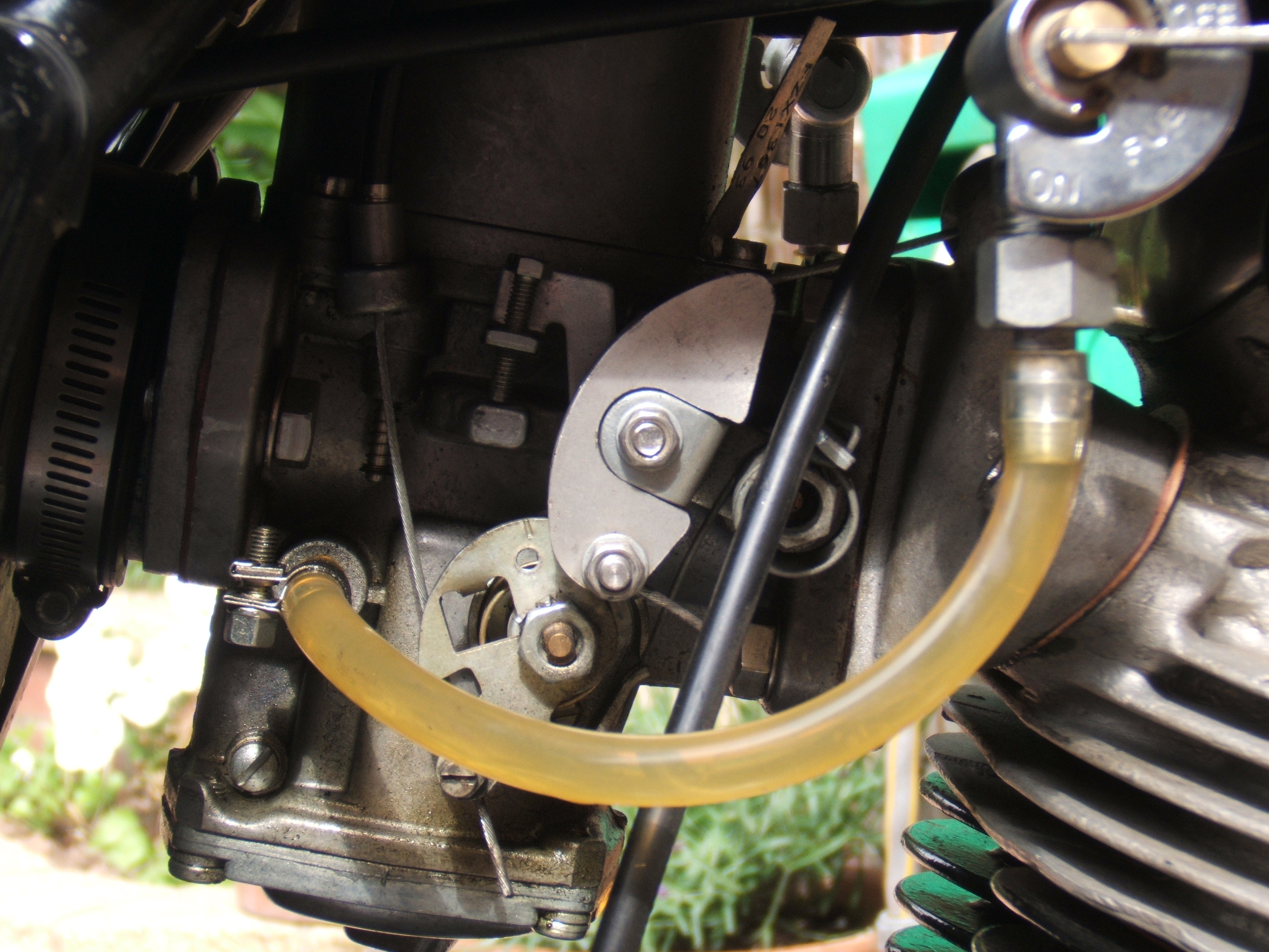

I found that if it wasn't run to 'empty' after a run it could be a pig to start the next time used. Mpg was excellent, over 300 miles from an interstate tank - the carb runs very lean hence the blueing. I  finally got fed up with the heavy throttle action & throttle cable fraying at the carb, interesting when it jams, so switched to twin Amals. Somebody in the NOC has a neat way of avoiding the fraying problem (saw & spoke to the owner at a rally) but I forgot to take a photo or note his name!

I have a quadrant fitted to the carb throttle arm that gives the cable a much easier life and easier action. I don't have to remove the tank to top up the dashpot. Just unscrew the cap and get the syringe pipe in there. Will post a photo tomorrow

Is the quadrant 'off the shelf' or did you make it, interested in one of those
The quadrant is of my own manufacture. I'm not sure if Burlen (who now own the SU brand) supply something similar.
