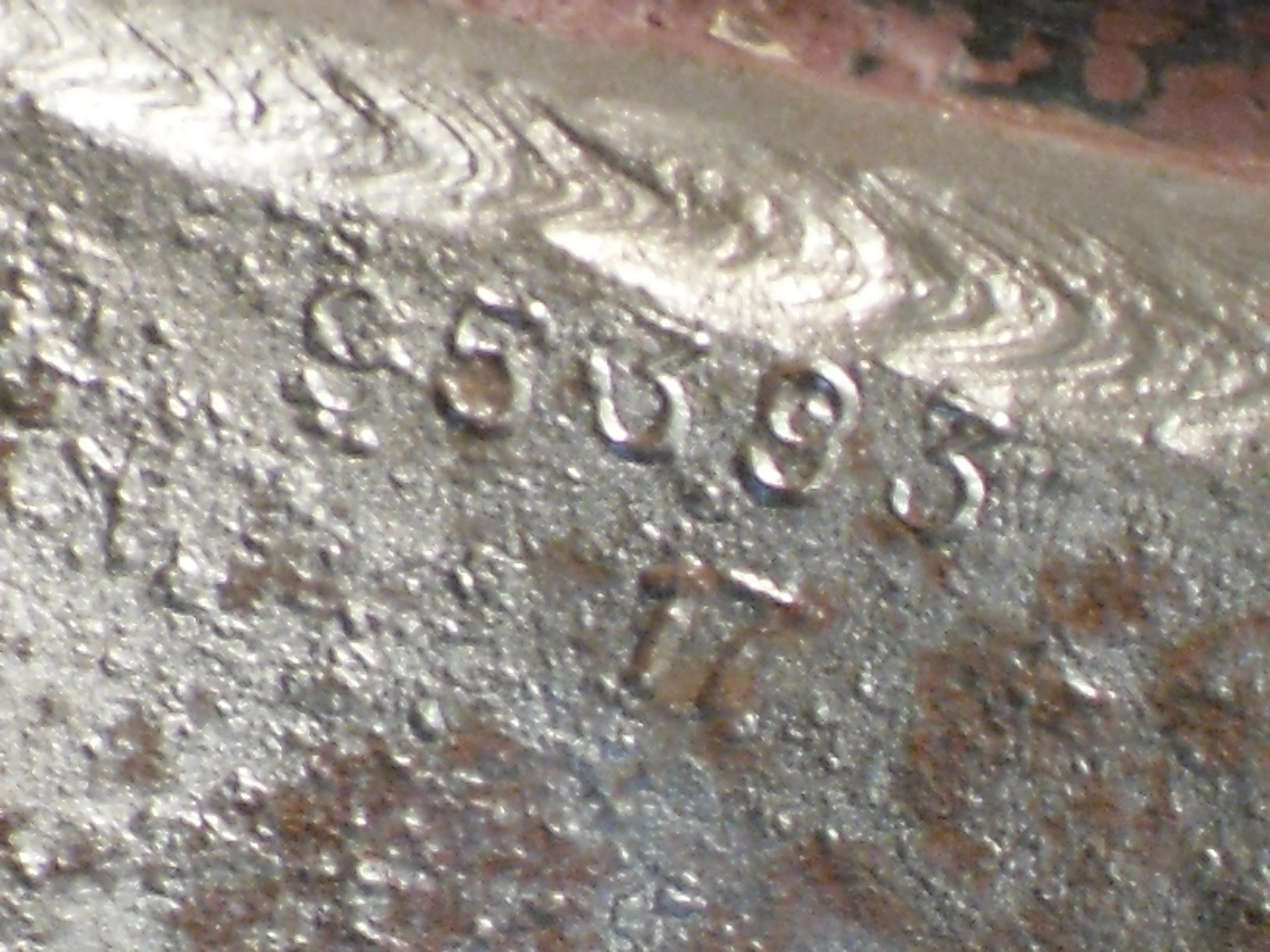

Hi, the number should be on the rear footrest bracket, mine is just under the weld. hope you find it. It should match the engine number if they belong together.
