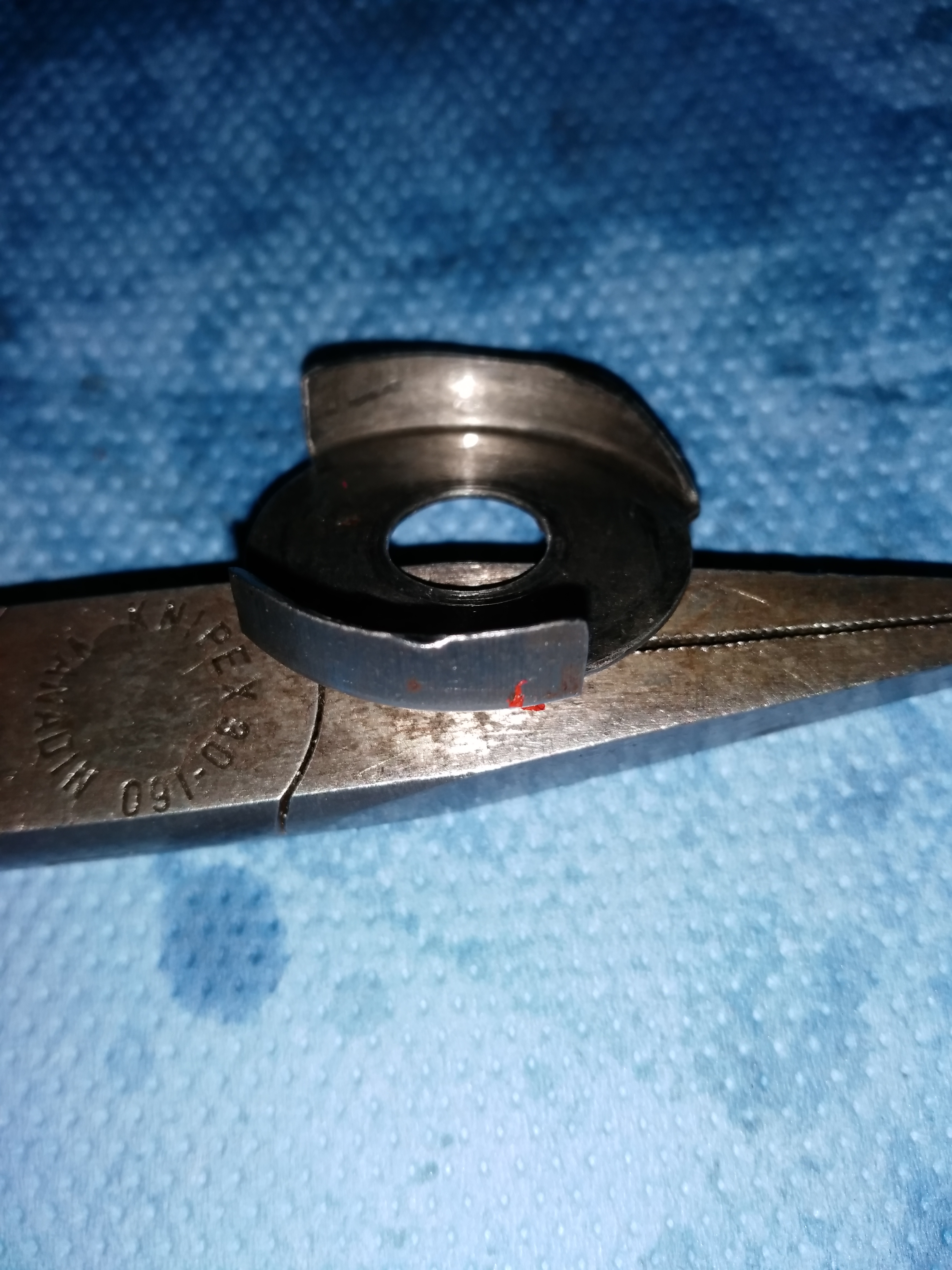

Also the lid washer shows some wear- one side is rounded more than the other? Normal or scrap?
Pawl spring and pawl spring washer outer

Yes, I mean that dish washer. I was not sure if it was wear or it was supposed to have that radius.

From memory the pawl spring outer washer is basically a dish shape with only two parts if the dish side remaining and the transition of one of the dish ends is radiused. If this what you call the lid washer. If you have a parts book, Item 13 in the exploded gearbox drawing.
