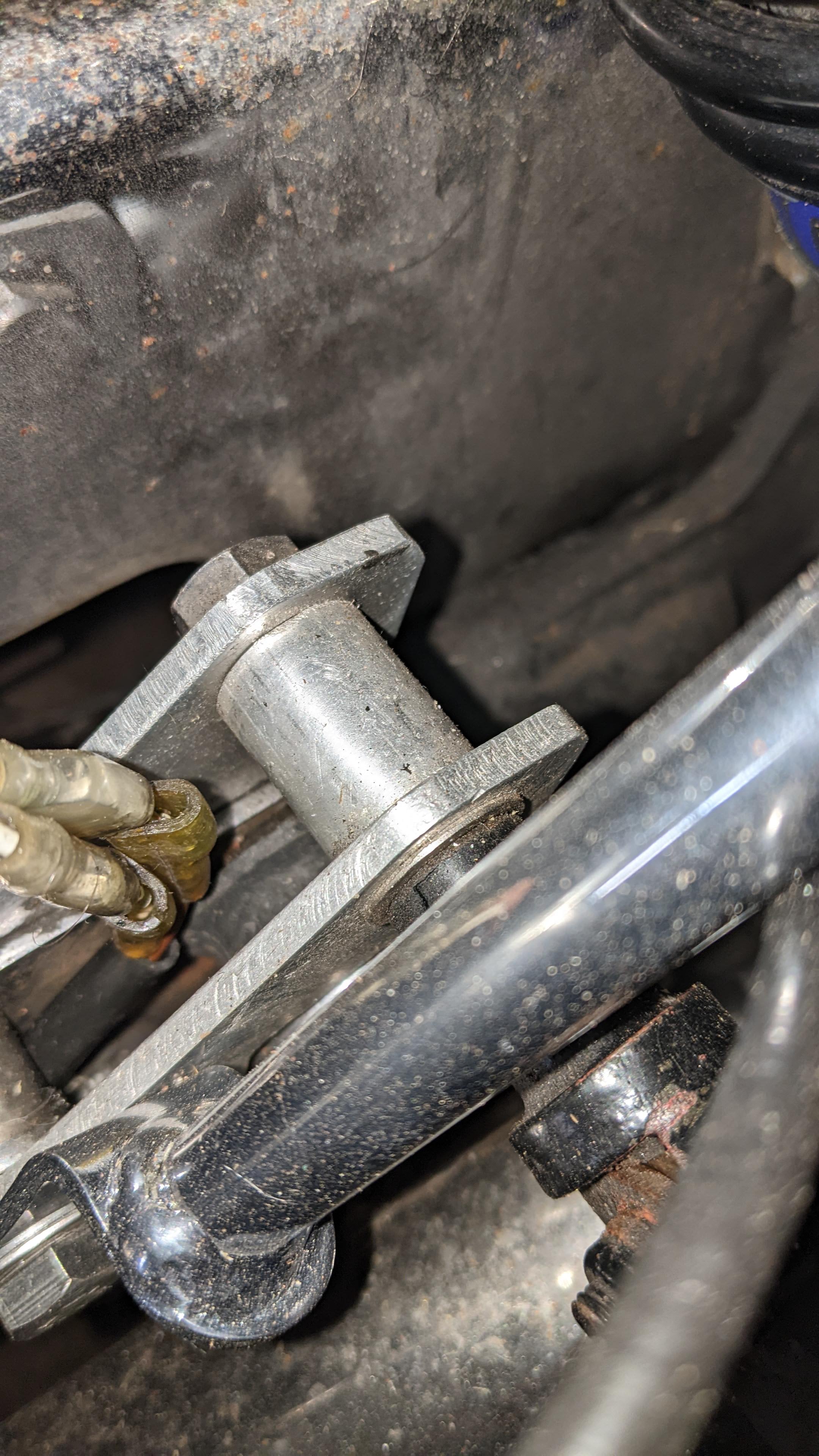

Assuming both of the mounting plates are still in place, you will need to fit the spacer between them.
 https://andover-norton.co.uk/en/shop-details/15282/spacer-5-8-thick-bzcp-

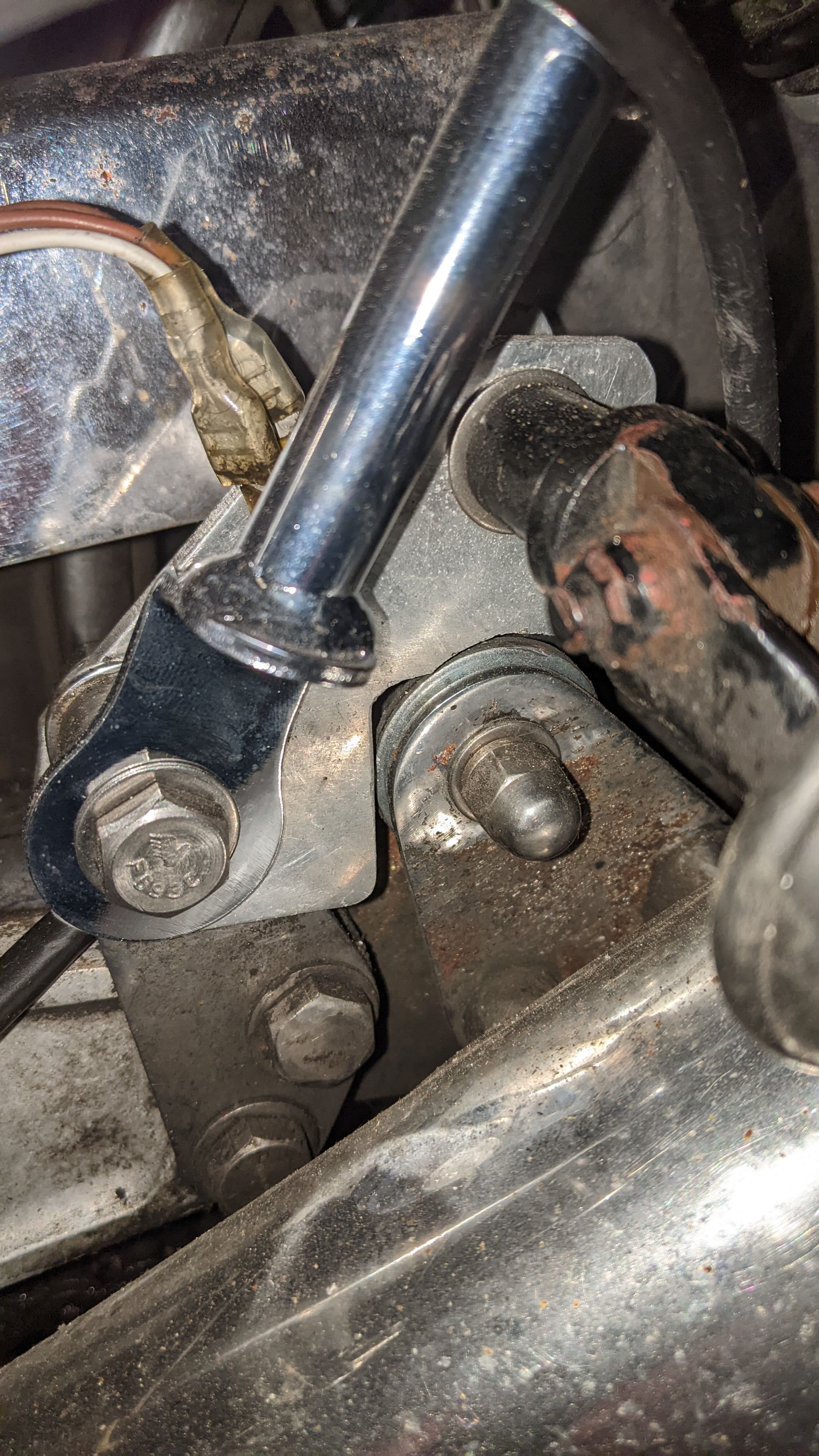

Just reviewing the current set up on my standard mk111 pillion footrests - they are very near the shiny silencers and it’s just a matter of time.
I am considering adding in extra spacers and plates to raise them a bit higher - any thoughts?
Brian I raised mine by adding alloy plates front and back with 3 holes on inner plate and 2 on the outer with a thicker spacer and longer bolt used on the top hole for the footpeg. Its a bit busy with the pannier bag supports in there too.
