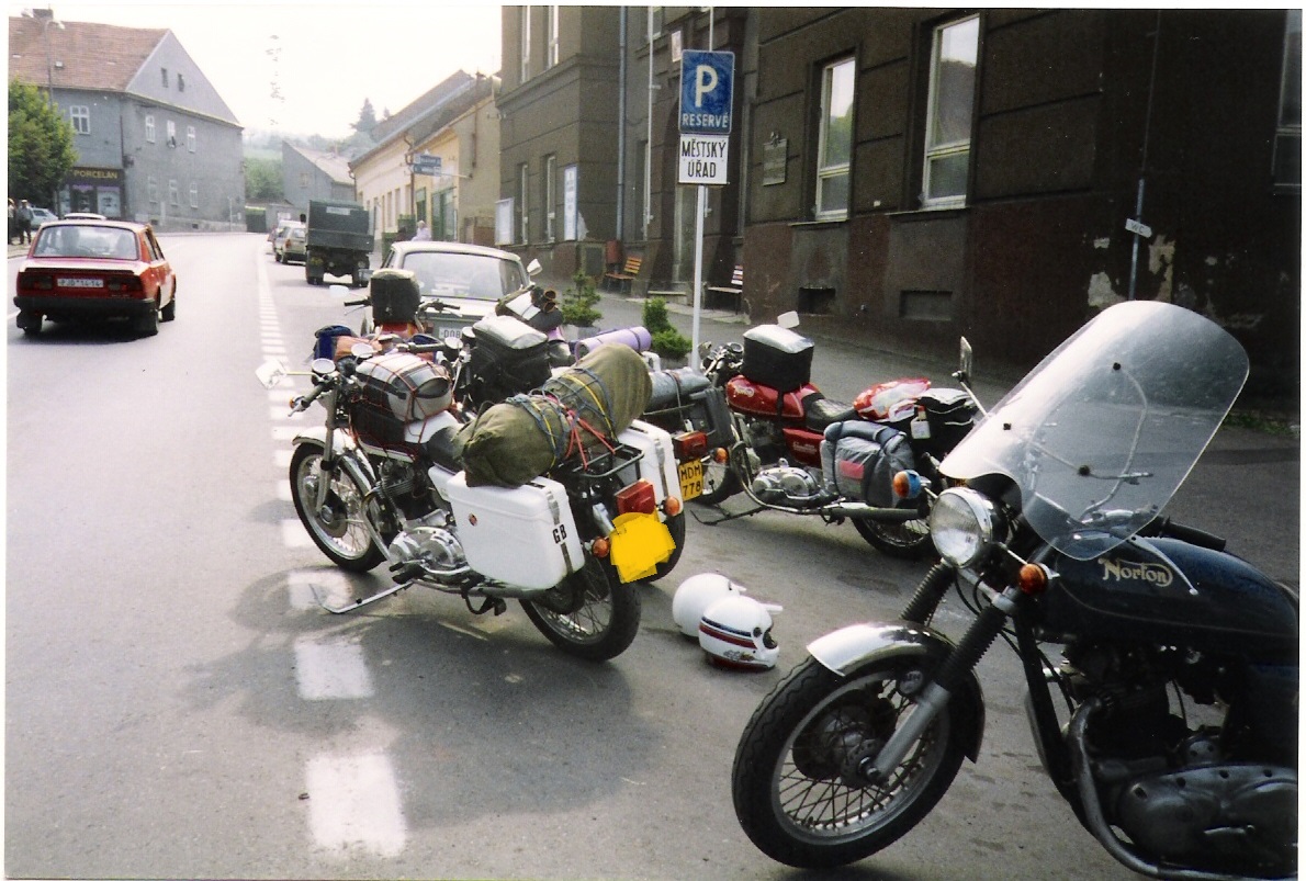

I fitted Craven panniers to my Mk3 to go the first International Czech Rally. When would that have been ? Early nineties ? With the panniers fitted, the hinged seat didn't work and a 2000 mile round trip without being able to check the oil level didn't seem like a good idea so I quickly bought a pattern Mk 2 saddle...It was purgatory. I did long days, with the first stint through Germany requiring seven fill-ups on the Roadster. I threw the saddle away when I got back.
