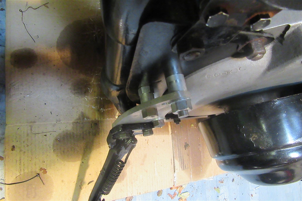

Just to add a bit more to this thread - I tried to fit a side stand from a kawasaki ZZR600 to my plunger framed model 7. I used the 'extra engine plate' idea, and while it would have worked with the stand down, the stand foules the exhaust pipe when retracted to such a degree that it cannot be fitted. So now I'm stuck. Any other ideas out there for adapting a sensibly priced stand to fit ?

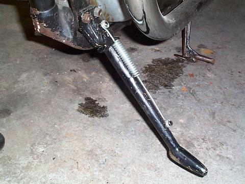

The attachments show the side stand on my 1948 ES2. The bracket uses the through engine front mounting bolts. It works really well, is easy to kick outwards and does not foul the exhaust system. Whether it is original I know not.

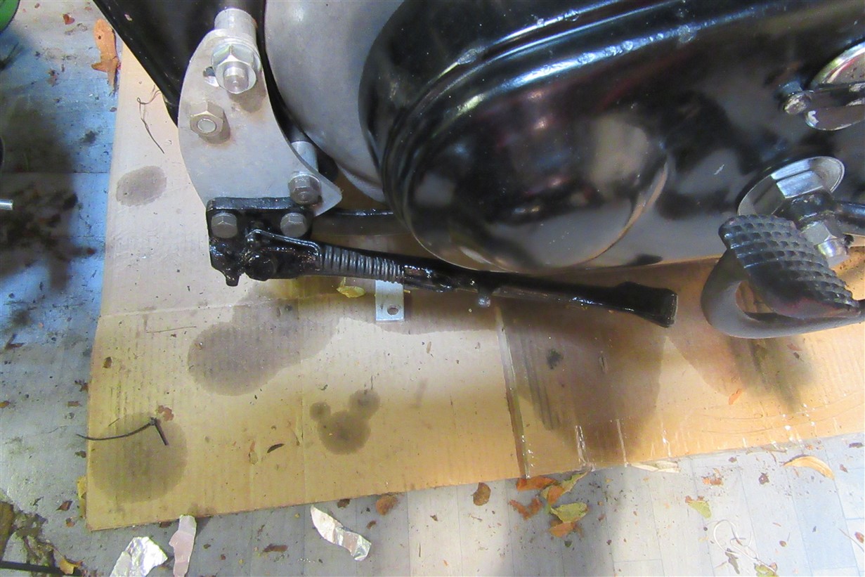

I used a Kawasaki ZZ600 st…
I used a Kawasaki ZZ600 stand attached to an old alloy engine plate that I modified.
I have another plate which you're welcome to (passing on previous generosity).

Hi Michael. This is a as near as I have - the bike is currently up on a lift undergoing cosmetic surgery.....
The stand does hold it rather more vertical than I would ideally like but I really only use it for mounting / dismounting - I use the centre stand for anything much longer.

I was guided towards the K…
I was guided towards the Kawasaki stand by you Anna - a good tip!

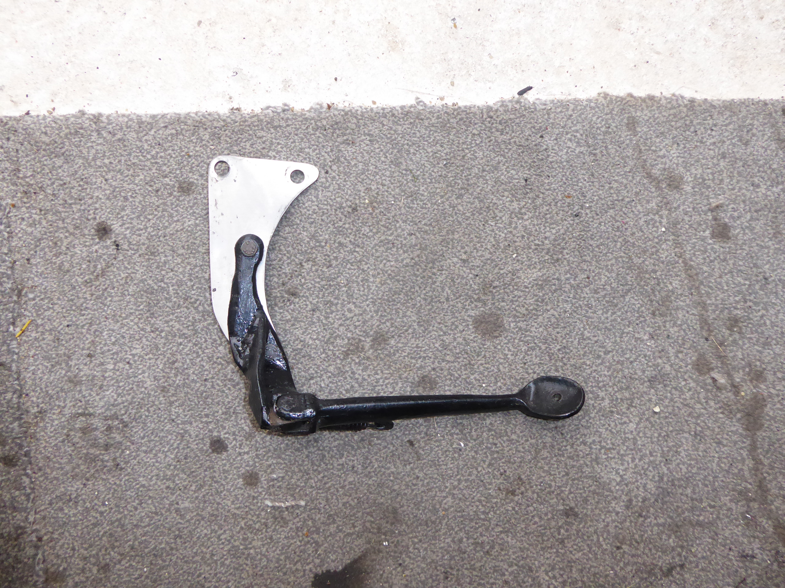

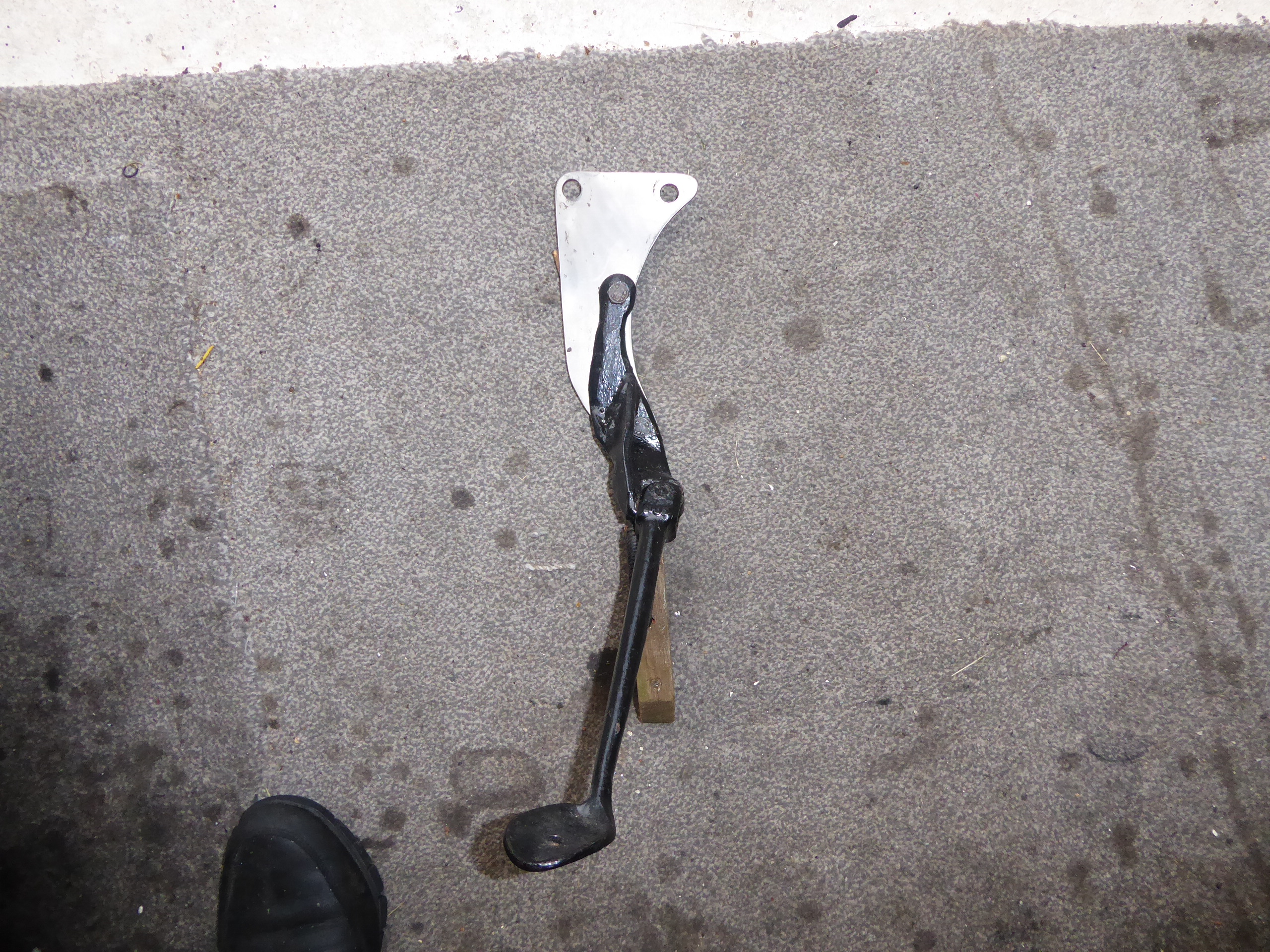

I've attached a couple of…
I've attached a couple of photos to show the two types of sidestands for early / mid 1950's single downtube models. Hope they help to show the difference.
