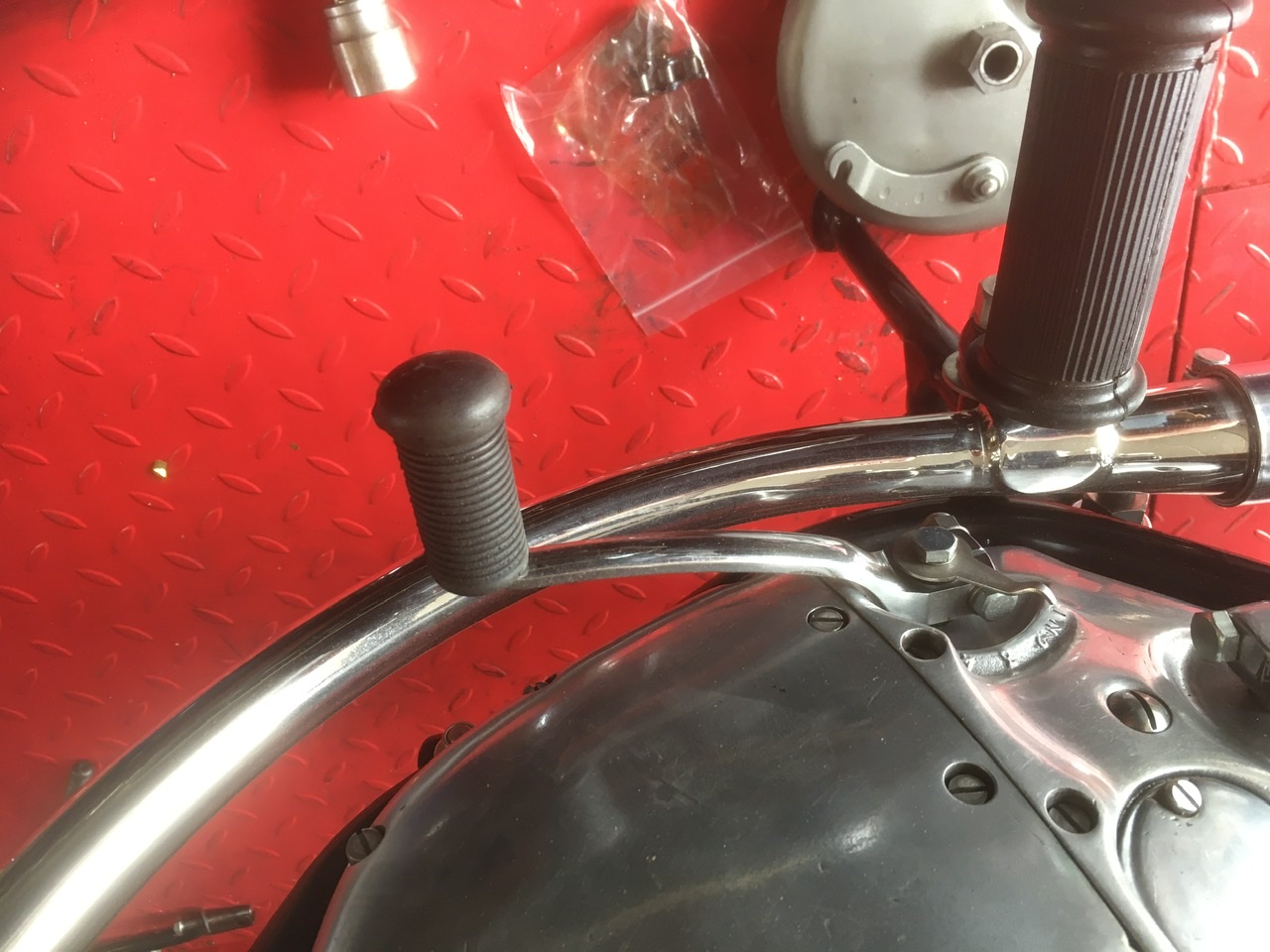

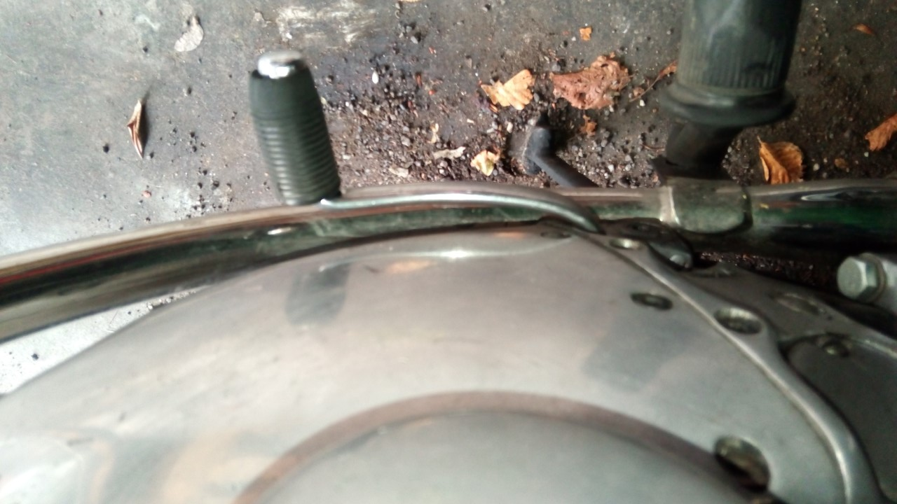

Hi Bruce/Peter,
That gear lever fits - its the one for the Commando, but is bent out a bit more to go around the 'fatter' timing case.
The 'normal' one sits closer to the timing case - see my picture below - sorry about the focus, it wanted to show you the gravel instead....
