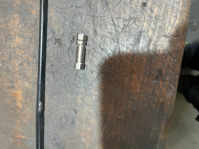

 I found a cable adjuster in my parts boxes and the shortened the outer cable and soldered on a new cable end for the gearbox.
cable adjsuter

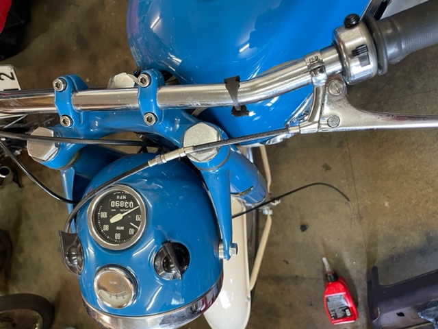

I left the cable aduster on the rear end of the gearbox in place and now I have one adjuster in a more convenient place. The clutch cable was not routed down to the gearbox in that photo.
top
Well done Ulrich,
It was always going to require a bit of work.
How does it fit now?
I started with a later cable and modified the gearbox end to fit early gearbox. The mid-adjuster is nearer the lever than your pictures show. This does allow the cable to route smoothly past the fork ears and top nuts.
