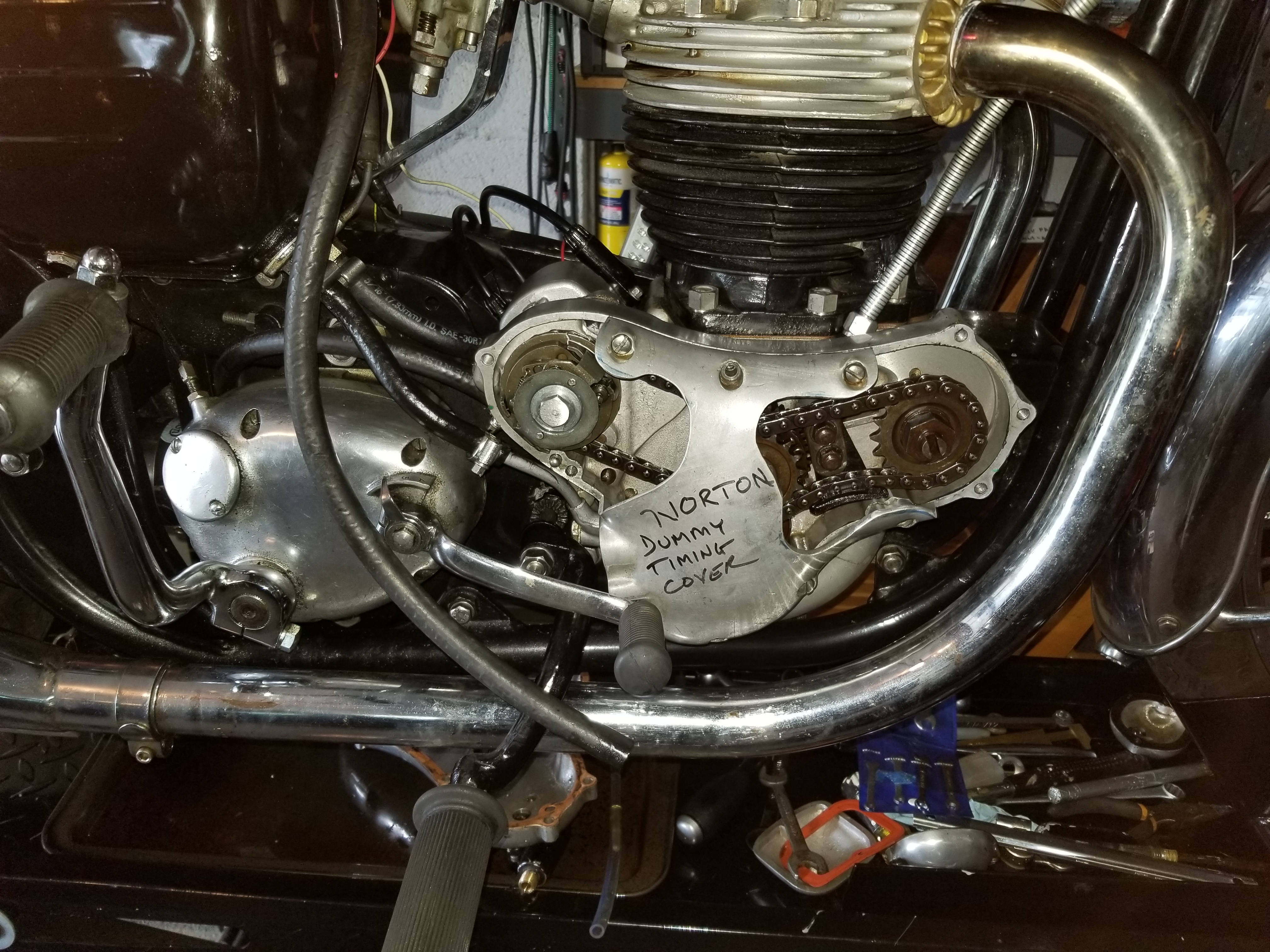

The attached photo shows an…
The attached photo shows an earlier motor than yours. If you look just above where the timing chain exits from behind the bottom of the auto advance unit you can see the base of the stud that locates the bottom of the mag on this earlier motor. On your motor there should be the head of a bolt in this same location. Of course there are also 2 waisted studs and nuts visible on the rear of the timing cover that locate the top of the mag.
The Heavyweight twins in…
The Heavyweight twins in 1965 had three magneto waisted fixing studs with part number T2245 that screwed into the crankcases. The nuts were reduced hex 5/16 inch BSC (26 tpi). In 66 some of the bikes (up to a certain engine number) retained these three studs but then they swapped the bottom fixing stud to a thin- headed shouldered bolt with fibre sealing washer, steel washers and 1/4 inch BSC nut. The head of the bolt as already stated is inside the timing cover behind the bottom run of the magneto (or points rotor) drive chain. The shouldered bolt has part number 25105. Good luck, howard.
