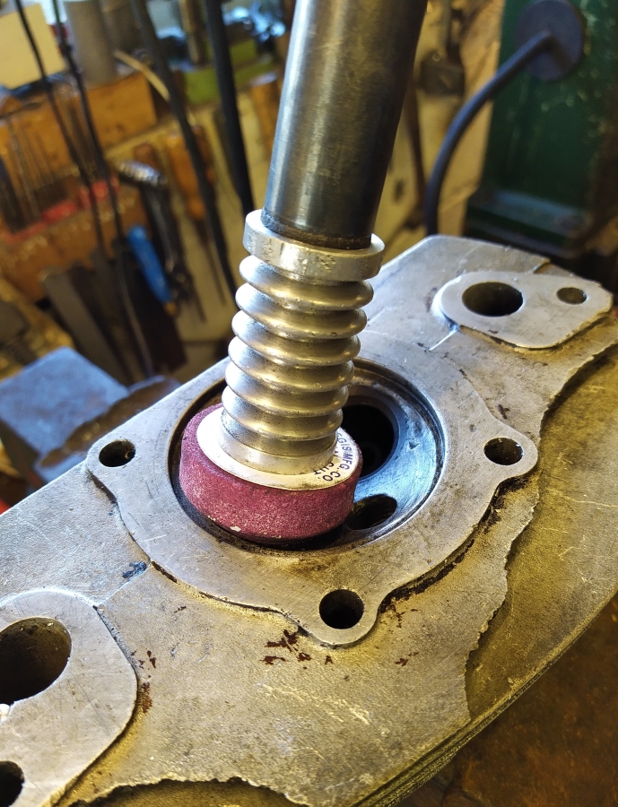

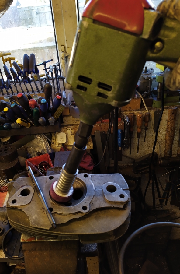

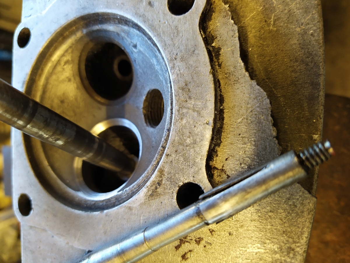

I like to use "Wolf" valve seat cutting equipment, long obsolete but very effective. I've attached some photos of the kit. The grinding tool is guided by an expanding mandrel and driven by something that looks like an electric drill, difference being it runs at over 16000rpm!
I think the major advantage of these seat re-facers over the carbide cutters is cost. The grinding wheels are a few £'s each and with the dressing attachment the wheels can be dressed to any angle. The seat in the photo is recessed somewhat so the next step would be to dress a wheel at, say, 30 degrees to clear some of the metal that is shrouding the valve. Likewise a wheel can be dressed to a much narrower angle to improve the port side of the seat.
These seat cutters appear on ebay now and again at very reasonable prices. Well worth getting hold of even if you only do this type of work occasionally.
