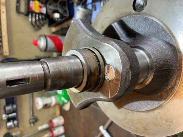

You can see the butchered plug but it is firm in its seat .
I filed it down so the race sits on its shoulder.
