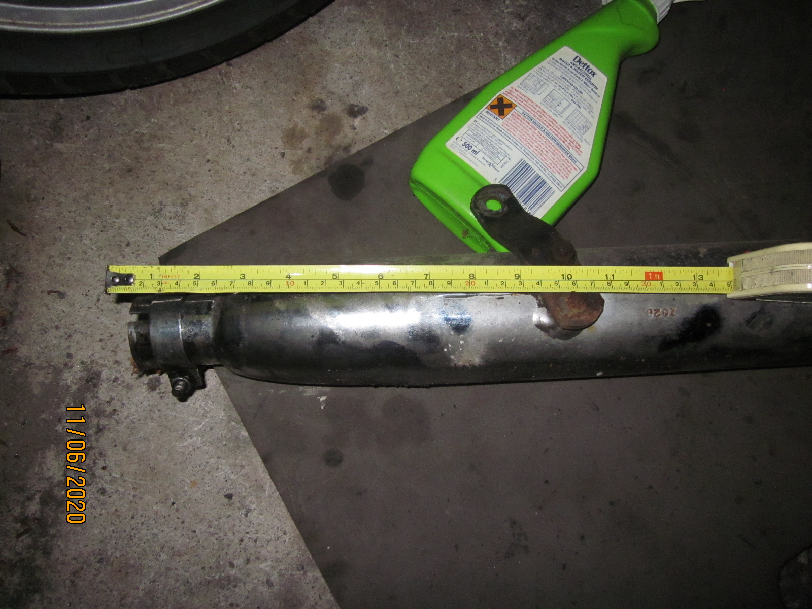

Ordered new big kink hanger for the right side. Parts sent me a new hanger but this was the same size as both my existing hangers. Sent it back and eventually received a replacement which was the same size as the one I returned. When I fitted the new bracket to the silencer there was a gap of about 15mm between the bracket and where it connects to the frame. I can make it fit but it makes the silencer to splay out to the right. Does anyone know the kink offset size.

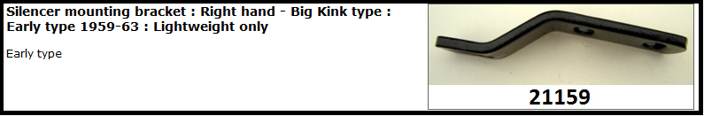

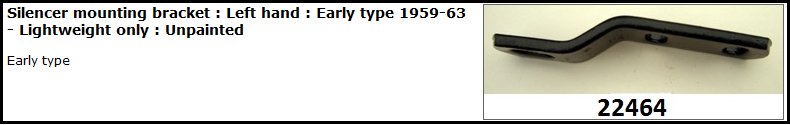

Small kink bracket part No. 22464. Big kink bracket part No. 21159.

My silencers are the old type, 1959. The offset on the hanger Neil sent is 17.5mm.

22464 = 0.5" offset
21159 = 0.75" offset
That is top edge to top edge (not including thickness of material)

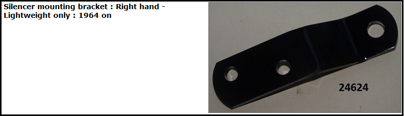

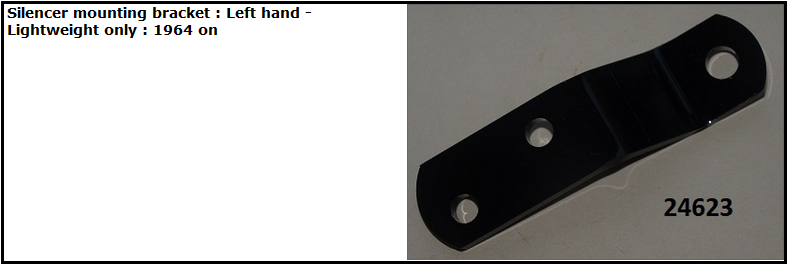

The later silencer is cylindrical & the same both sides. Normally, the brackets for this type are handed left & right - holes not in line - and they lean rearwards when mounted.
A (much used) later silencer shown off my own 1964 Navigator - with the later bracket (holes not in line, leaning backwards (from the footpeg mount).
